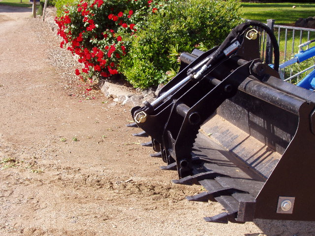

Have a front end loader on my bx2370. I'm looking for something I can make to help me pick up brush piles with larger sticks and such. I know they probably make attachments for this. Any thoughts from those who have "home made" solutions? Thanks
With any tractor with a FEL and you're gathering brush for seasonal disposal or several heavy loads , I used to use either a rope or chain with a pair of FEL pallet forks fastened to the bucket and gather up the debris-what a PITA- off the tractor, on the tractor, chain/rope snag, load shift, cut/bleeding arms etc. BUY A GRAPPLE AND NEVER LOOK BACK-wise investment for your use now and if you ever decide to sell. Hydraulics rule.
