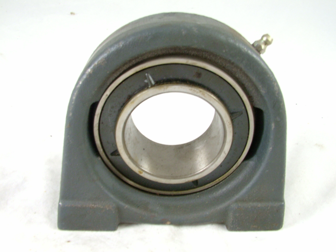

Here is a picture of a similar mounted bearing without all of the rust to give a better idea. This is a NTN bearing. At Allis-Chalmers/Deutz-Allis/AGCO and Case NH we always designed out own housing rather than buy an off the shelf unit from a bearing company because they wanted too much $$$. Athens is probably the same because they use a lot of 1 design and it is much better to design one to your exact needs rather than to make compromises to fit in an off the shelf unit. This unit has a groove around the center of the housing bore so it doesn't matter where the hole is in the bearing OD - grease is going to find its way inside.

THe people at Athens advise mounting the block to a good strong metal table and (of course after soaking and cleaning) use a shaft the same size as the bore to leverage it gently. I will also use some heat. I assume I can heat it without fear. I am a rookie with a torch so should I heat it up moderately or all the way to red?
