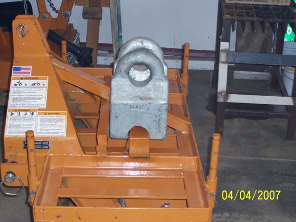

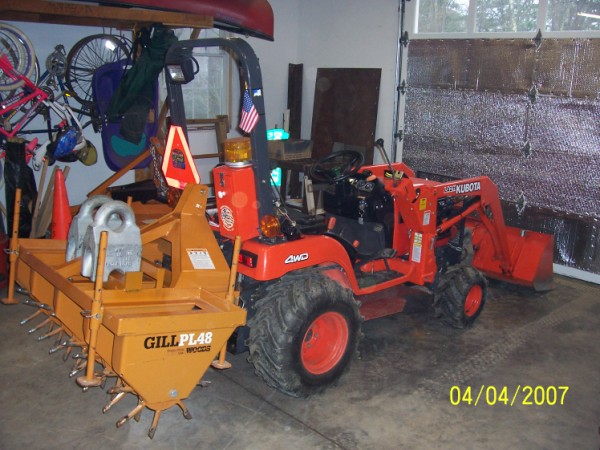

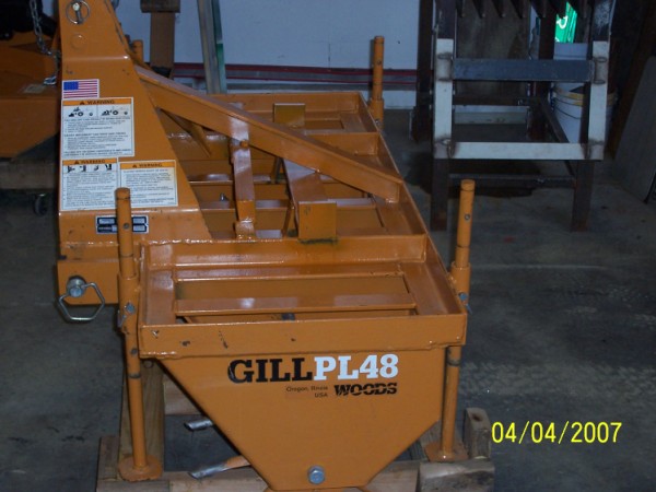

More upgrades during some spare time in the shop, for my Woods PL-48 aerator. In the past, my added weights were loosely strapped down on top of the aerator. That allowed for them to shift and move, not good @ 100 lbs apiece.
I had some 3" angle from a past job to fabricate a weight bracket, holding the weights securely, especially when transporting on the trailer.
I added a piece of 2" angle to hold the weights forward.
I had the steel & paint already, cost was limited to my time.
2 hours cutting, grinding & welding to complete the project.
The 4- 100 lb. weights lift out to use on my rake & boxscaper, secured with a 1" ratchet strap.
WALT
