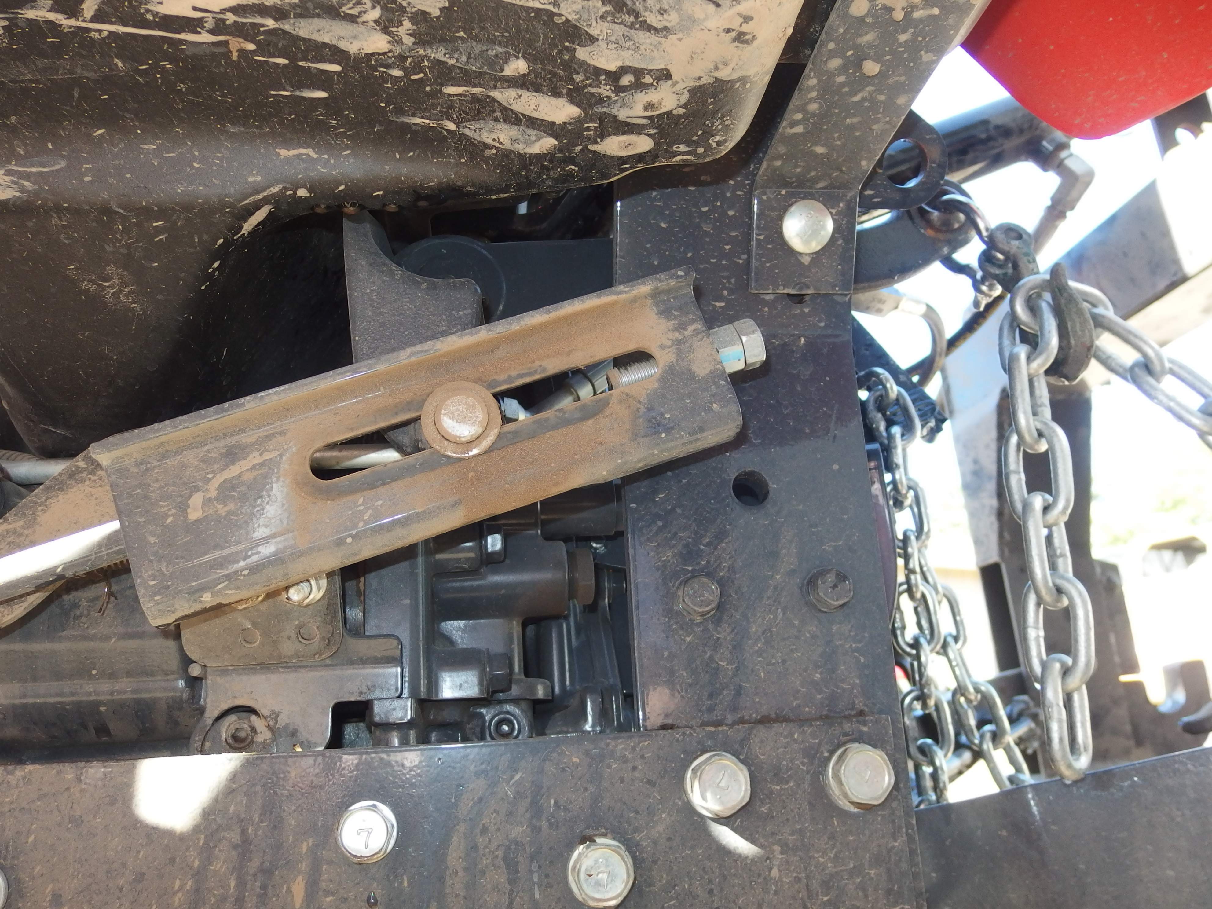

Well, I put my shims in. I tested out to 1725 lbs stock with 45 hours on my BX2670. There were no shims out of the factory. I put in one 0.4mm shim and tested out to 1925 lbs. I'm gonna leave it there for the extra kick, for what its worth. The math works out to 50 lbs per 0.1 mm on my job, not the prescribed 39, but I supposed it's not a precise game.

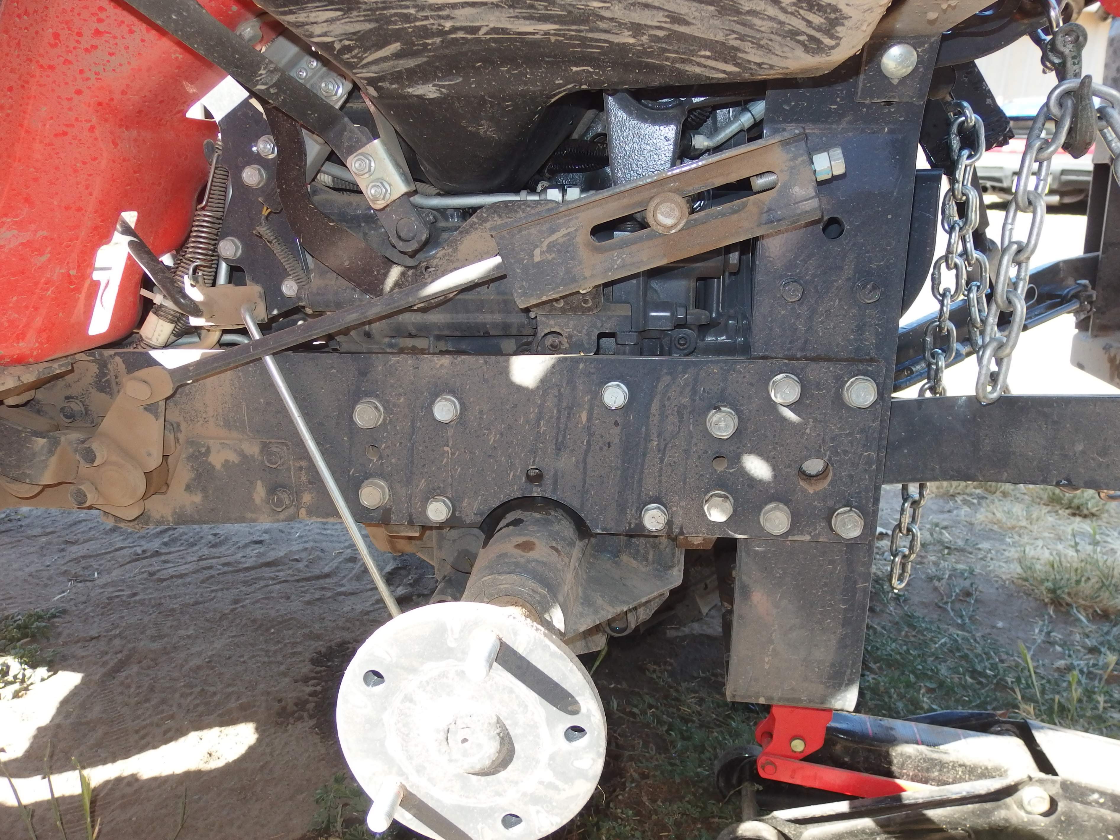

The job is different than described in this thread for those of you with a later models, like the BX2670. For one, you don't need to remove the rear left tire at all. I did, but realized it was totally unnecessary. The whole job is easily accessed from behind.
Here's what it looked like from the wheel side:
Above, you see the slider for the lawn mower lift system, and just behind it, the hydraulic limiter bolt. It would be pretty hard to access it from the tire side.

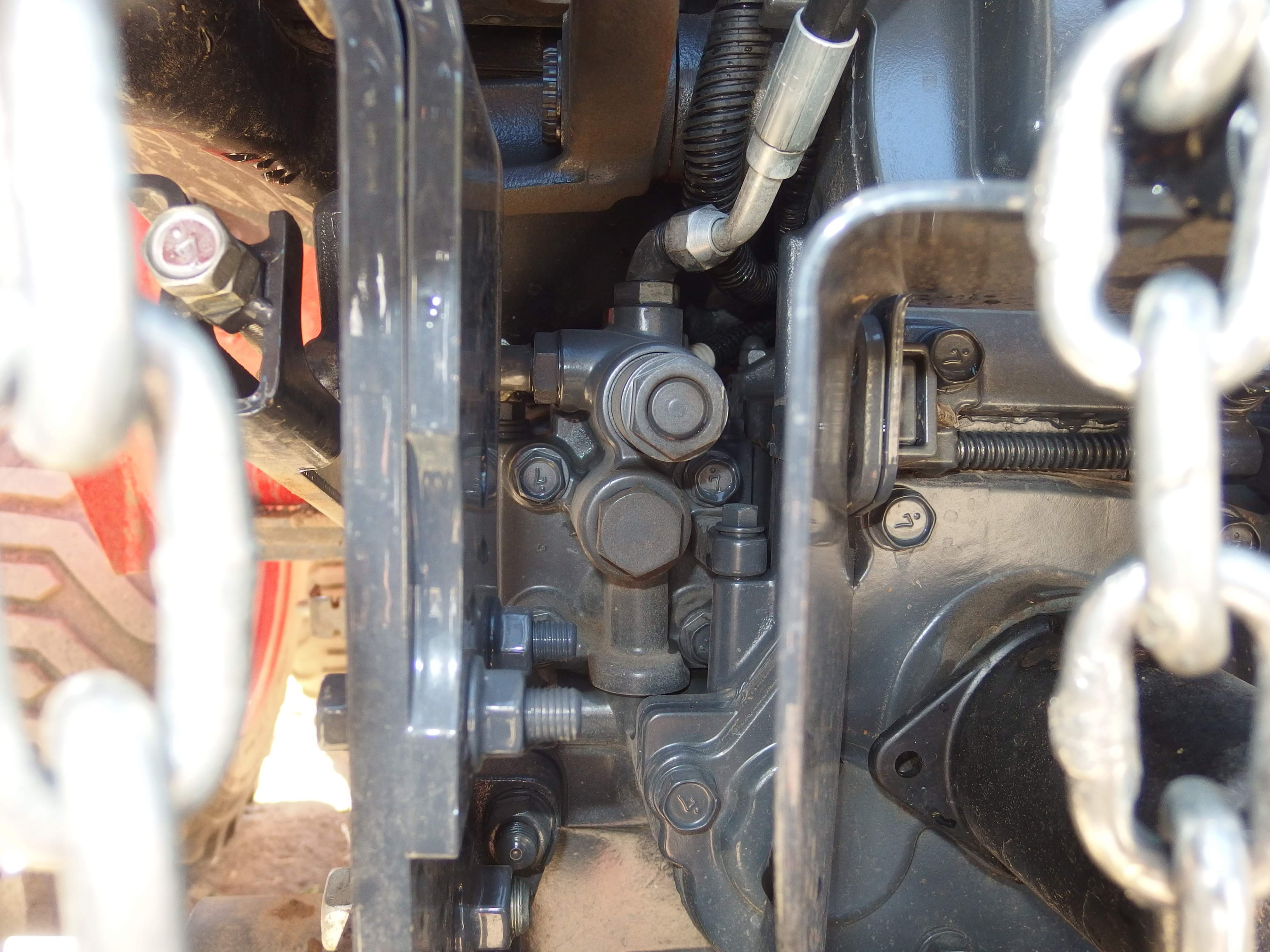

These next two photos show the limiter from the rear.
The spring is located behind the lower of the two visible large bolts. Use a 7/8 or 22mm socket to take it out. Be careful the spring doesn't fall. Don't worry about oil. There is no pressure here with the engine off (but I did lower my bucket and relieve any system pressure just in case.) I also hosed the area clean a couple of hours before I started, to keep the dirt outta my hydraulic fluid.
