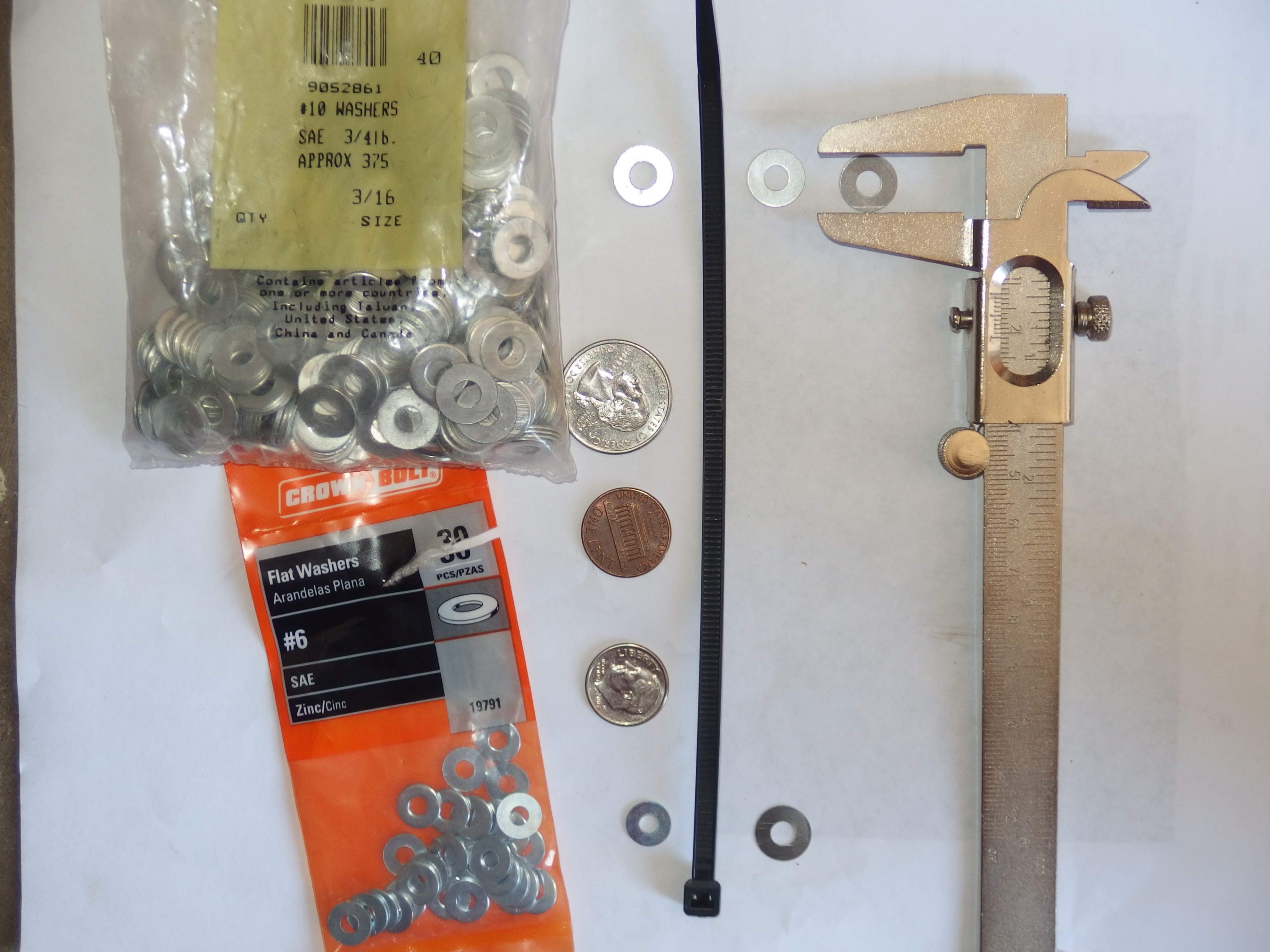

   / Hydraulic Relief Valve Adjustment for Bx2230 and Bx1830 #23
The shims arrived from Messicks, USPS First Class mail. Order 5/25 arrived 5/29. Pretty good shipping, of course they're tiny, and it was "mystery shipping" until it arrived. USPS First Class is supposed to be trackable and 3 days, but you don't get a tracking #. And my calculations at the USPS show that it should cost about 91 cents to mail, but I paid $14. I know there is some "handling' involved, but c'mon, $13.09?
I have documented the shim specs for those interested, and basically confirm what Tractor Seabee said above. They are 12mm diameter, and look like this:
I put them side by side with some common objects for comparison. Three shims are on the right. I think somebody clever could find a way to jury rig their own shim if they wanted to. The biggest challenge would be to get it thin enough, evenly across the surface.

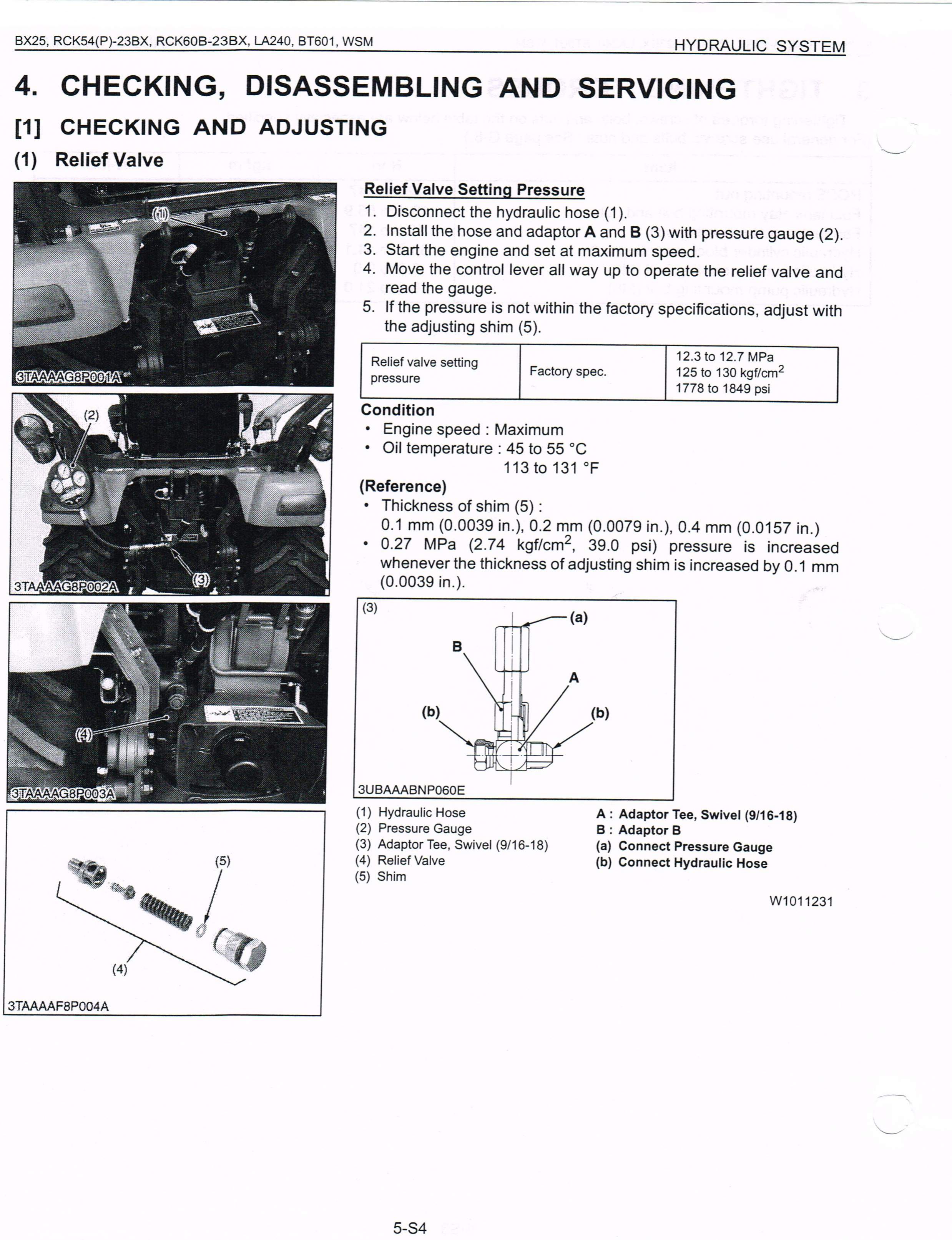

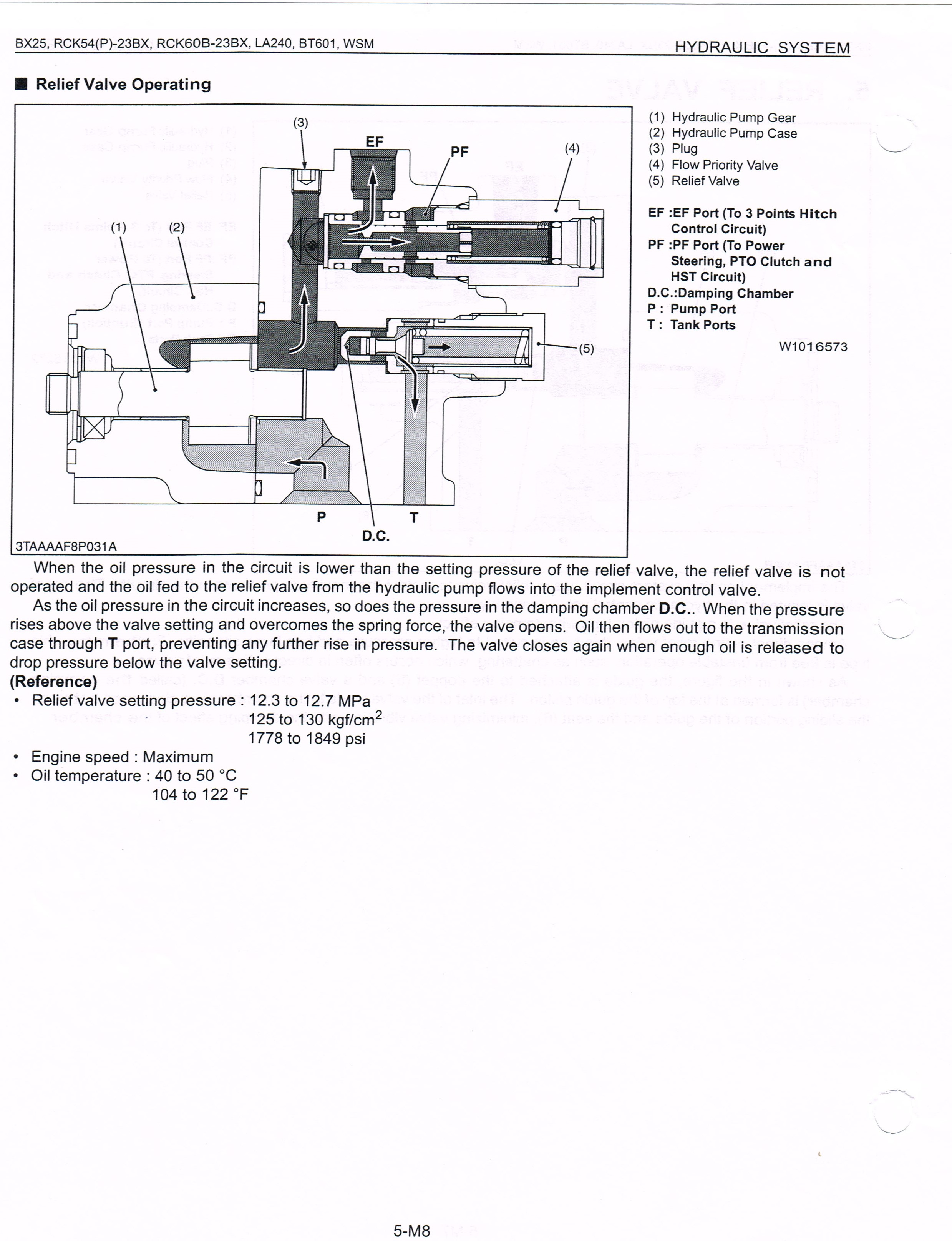

   / Hydraulic Relief Valve Adjustment for Bx2230 and Bx1830 #24
Hydraulic Relief Valve Adjustment for Bx2670 or similar
Well, I put my shims in. I tested out to 1725 lbs stock with 45 hours on my BX2670. There were no shims out of the factory. I put in one 0.4mm shim and tested out to 1925 lbs. I'm gonna leave it there for the extra kick, for what its worth. The math works out to 50 lbs per 0.1 mm on my job, not the prescribed 39, but I supposed it's not a precise game.
The job is different than described in this thread for those of you with a later models, like the BX2670. For one, you don't need to remove the rear left tire at all. I did, but realized it was totally unnecessary. The whole job is easily accessed from behind.
Here's what it looked like from the wheel side:
Above, you see the slider for the lawn mower lift system, and just behind it, the hydraulic limiter bolt. It would be pretty hard to access it from the tire side.
These next two photos show the limiter from the rear.
The spring is located behind the lower of the two visible large bolts. Use a 7/8 or 22mm socket to take it out. Be careful the spring doesn't fall. Don't worry about oil. There is no pressure here with the engine off (but I did lower my bucket and relieve any system pressure just in case.) I also hosed the area clean a couple of hours before I started, to keep the dirt outta my hydraulic fluid.
The reason I have those chains is that I took off one of my lifters to check into a metal shop welding a hydraulic tilt. One chain is temporarily substituting for the lifter. The other chain is a drop limiter for my Quick Hitch QH, so I can either set a consistent height for ground work, or keep the QH from dropping too low when I'm mowing with the mmm.
Below, you see the bolt and the spring, on the WSM printout from CHDinCT.
The last photo shows my end pressure after inserting the 0.4mm.
Looks like a nice 1925 lbs per sq in.
Total job time once you have the parts, 5 minutes.
I've got 5 dump trucks of recycled asphalt and a rented rollingcompactor coming tomorrow. We'll see how it lifts.
