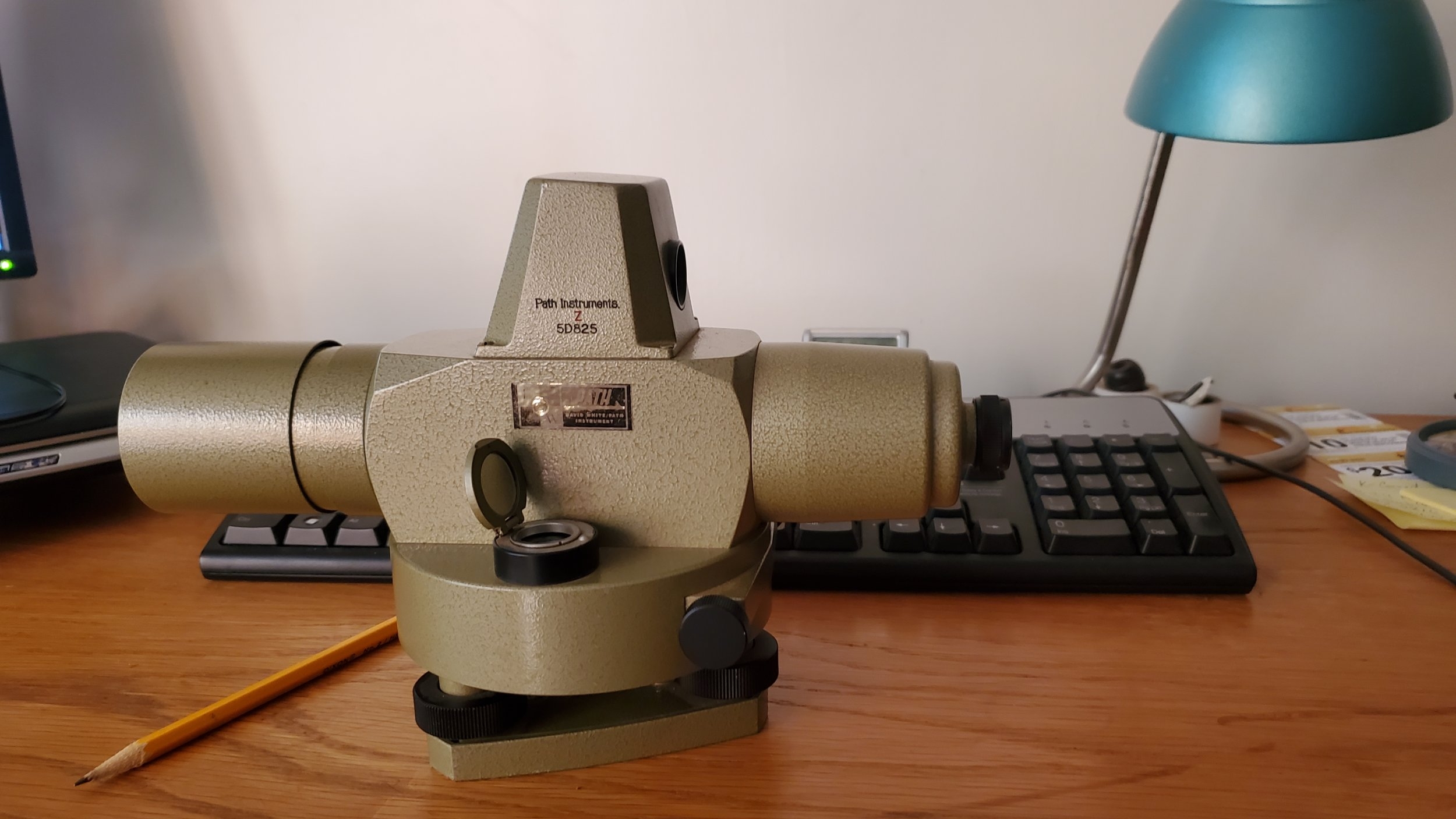

Dont forget to check your pawn shops. I purchased this last year with a tripod and stick for $300.
A but more than you wanted to spend but really useful.

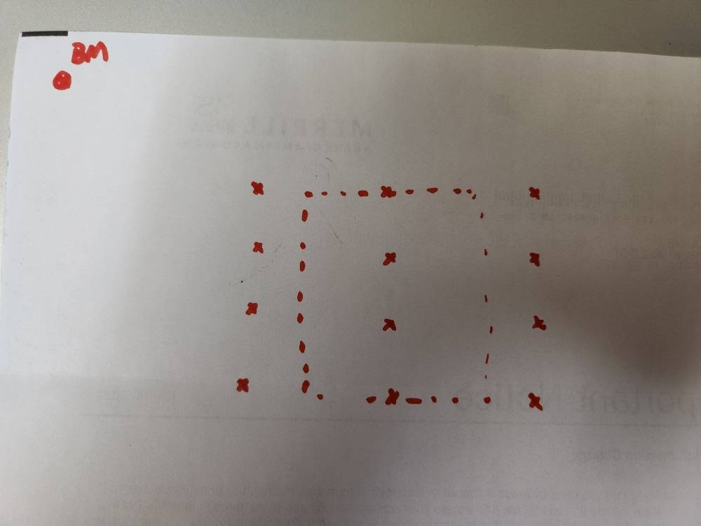

So, once we select our instrument; we need a "bench mark". If we truly aren't interested in "103.5 ft above sea level" and we just want "same elevation as the house", we can use a very defined, set point; that could be a nail and disc in the road, a well defined corner of the house, the top of a well casing, ect. If we dont have that existing, we need to create one (outside the grading area). We can drive a piece of pipe into the group, we can put a rail road spike in a tree, but we need to make sure we set One semi permanent point that we always go back too. If you are close to a road, there might already be one that you can research or find the elevation of.
Anyways, once our bench mark either found or created; we then set some stakes, with marks on them. I would try to set my grade stakes about 10 ft outside my building foot print, running down both sides, about every 25 ft. We are talking about 40 ft (+10 and +10; so 60 ft total distance between stakes). You can string line that, IF you have a helper, but you can't pull tight enough by just lopping the string on the lathe and pulling. So, maybe you can get some help 1 time; to set grade stakes, and pull a Tight string, and set mid point stakes. Now, we have stakes creating a cross section every 25 ft down the slab, with the outside (off set 10 ft) and a mid point stake, you can solo string to your hearts content.
If you prefer, it's not hard to just use a 4 ft level on each grade stake, level out, and use a paint wand to paint F .3 or C .5 or +1 whatever your preferred system is.

A picture that might explain what I mean better, with the Benchmark being away from the area you work, and then the stakes being the Xs along the sides and down the middle.

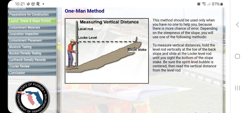

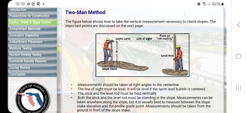

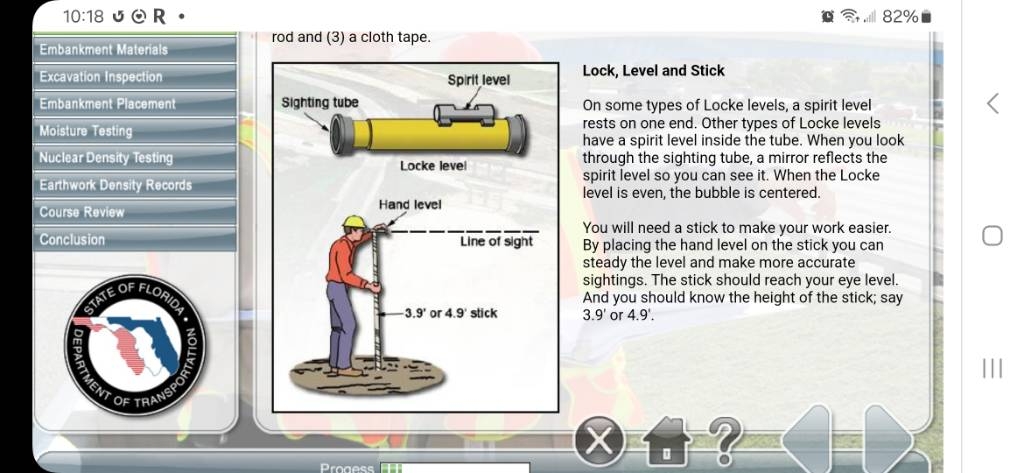

Here are some very basic things about using a Lock Level, stolen from the Earthwork Self Study book.
