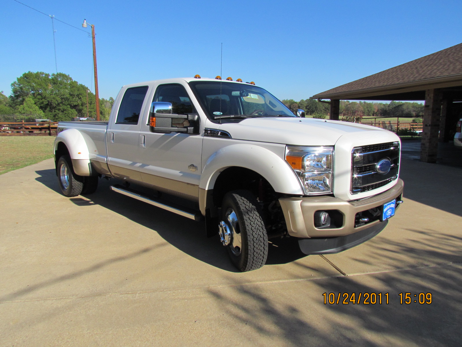

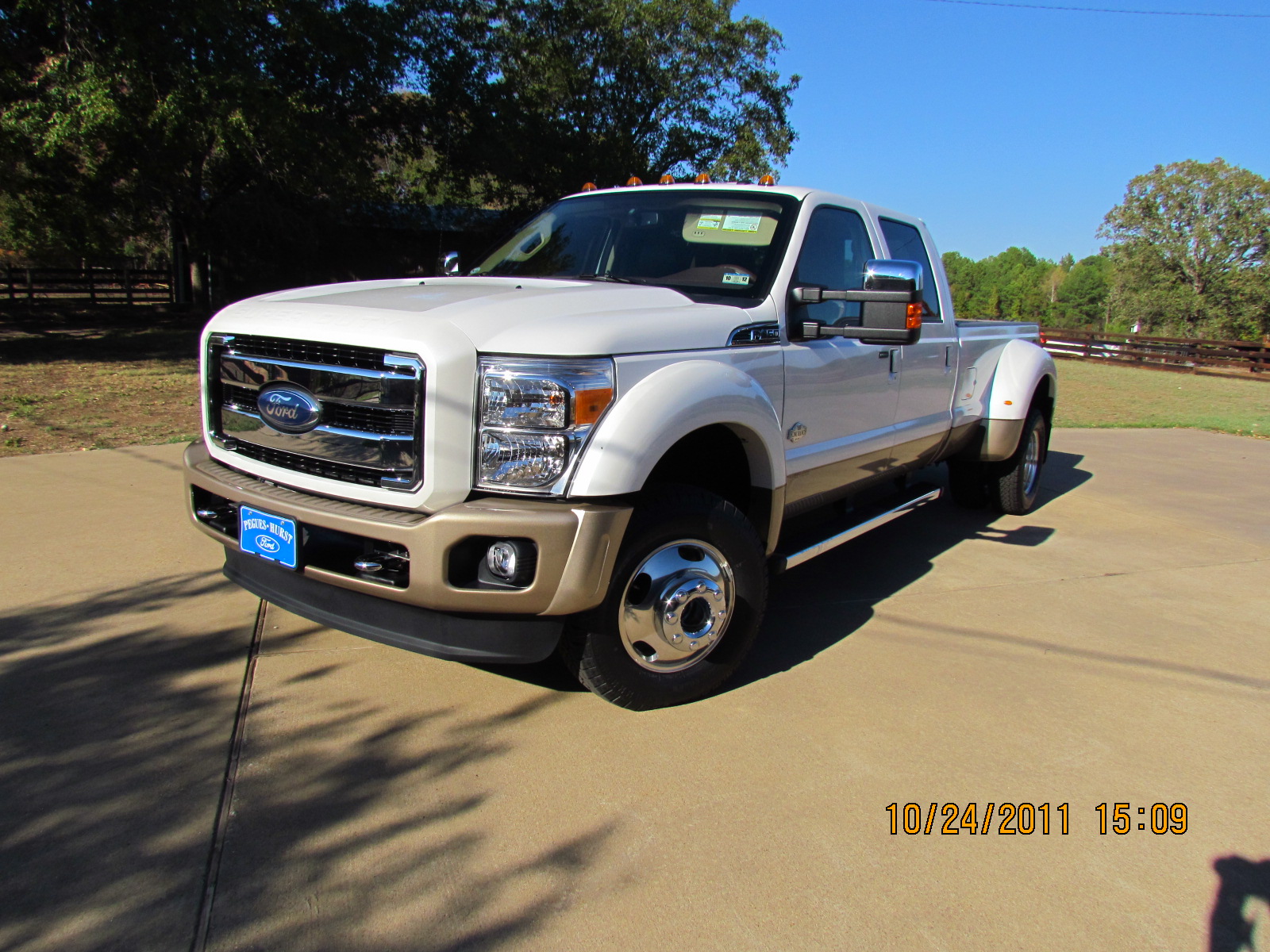

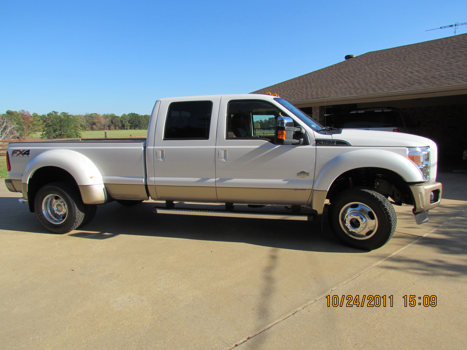

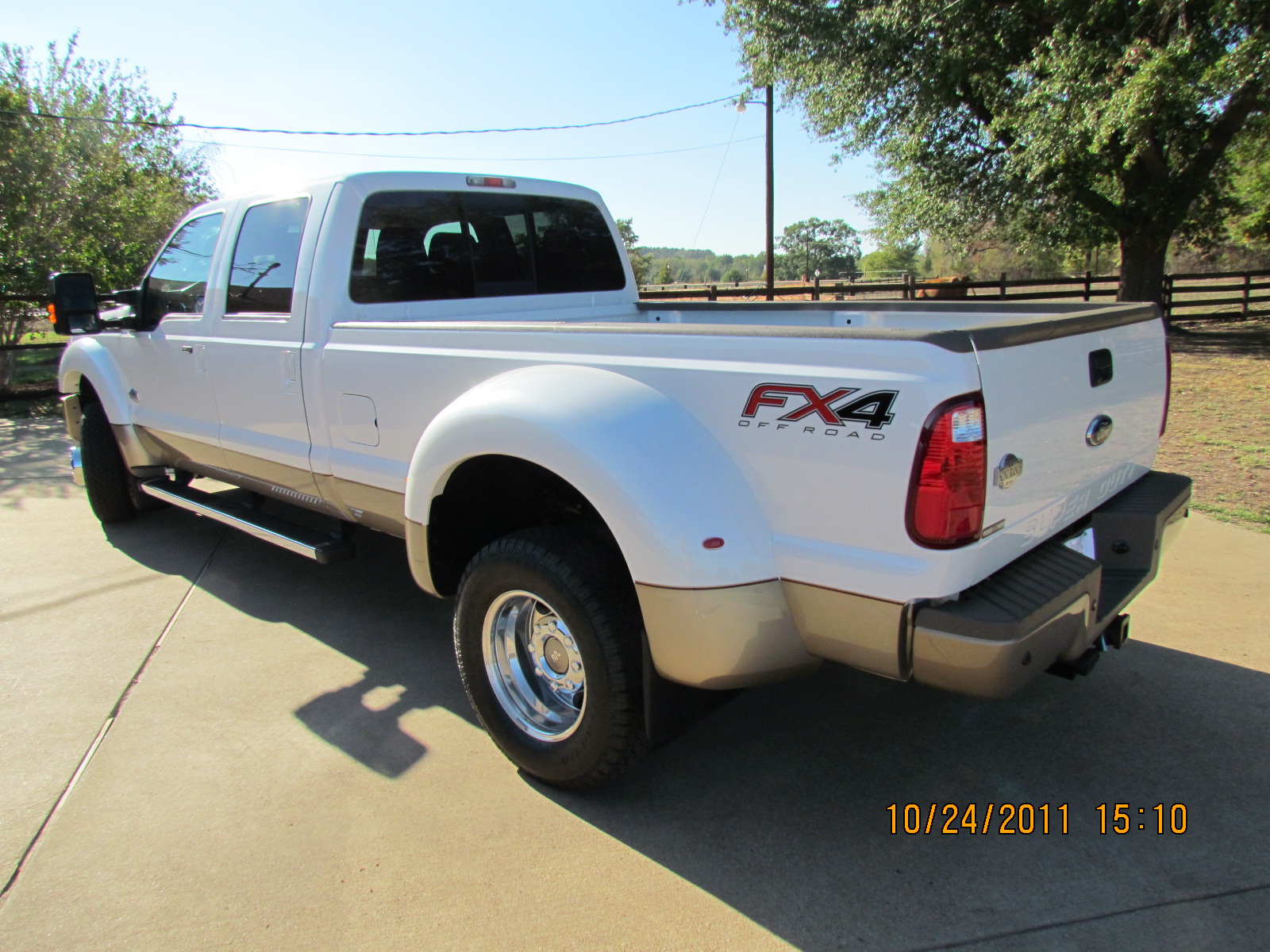

I just brought home a new '12 F-450 pickup. Only way I can afford a new truck is trade every 4 years. Really didn't want to get rid of my '08 F-450 but the 6.4 powered trucks are taking a hit since the introduction of the 6.7. It ran perfect but I still wasn't going to keep it past the 5 yr powertrain warranty. Even with only 50 miles on it, I can really tell a difference in power from the 6.4. No turbo lag at all. The 6 speed auto makes a difference, too.
Lets see it. Please let me (us) know how it runs and give us updates. May be doing same thing next year.
   / After comparing, bought an F-550 #54
My first impression of the 6.7 is that it's a very powerful engine, no turbo lag, quiet but still has a good sound to it. The 6 speed trans must have been configured a lot like the Allison. This trans will hold any gear and you can manually shift it also. Engine has an exhaust brake. I'm anxious to try this out because the system on my '08 worked very well with the integrated brake controller and downshifting the trans as you use the brake. The F-450 pickup comes standard with diesel, 4x4, wide track front axle, crew cab and 4.30 axle ratio. Rated at 33,000# GCWR, they are one serious towing machine. I really liked my '08 and almost didn't buy this truck. I do wish they still used the 19.5" commercial tires and wheels on the F-450 but the 17" wheels look good.
