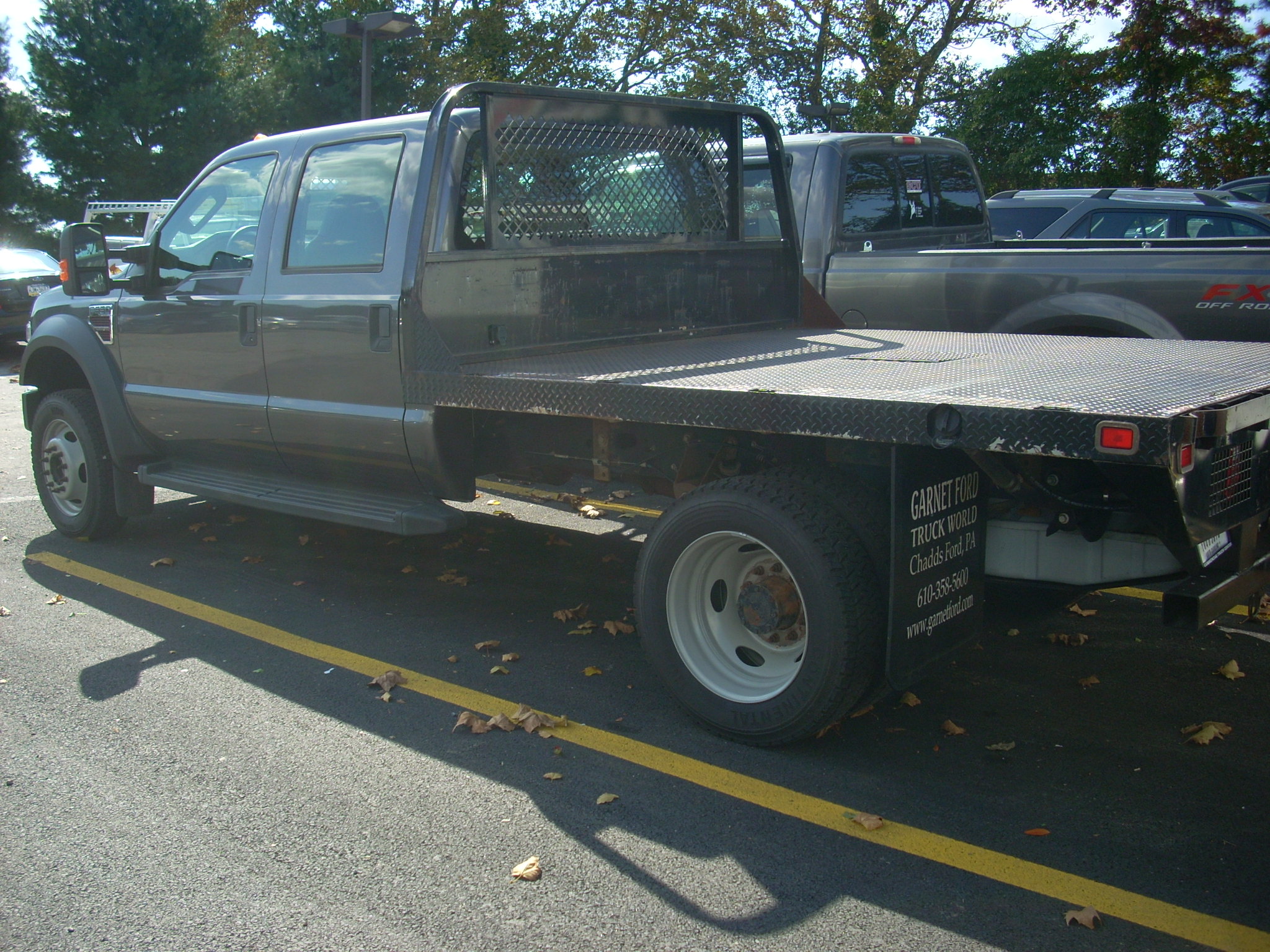

Builder, 7 pages and still no pic. Did you actually buy this truck or are you just messing with DP?
Matt:laughing:
Matt:laughing:
Yep, I'm just a big fat liar. :rolleyes:
I love messing with DP. Such an easy victim.
BTW: How's the DMAX?

   / After comparing, bought an F-550 #68
Looks good, the dmax is good I've been disappointed with the mileage but was on a 3 hr highway ride yesterday and the mpg was way up so I guess it's just a better highway truck. I'd say you did pretty good on price for the 550. I really like the bed and trap door.
Matt
#69
That was the picture taken after I dropped it off at the dealer to replace injector & wiring harness.
I have since removed the running boards, added a fuel transfer tank, a small backup camera and all the decals to the doors.
Wanna talk bad fuel mileage? You oughta see this pig chomp down some fuel. Definately single digits around town.:ashamed:
My DMAX is getting 13.5 around town toting 2K in tools in the utility body.
