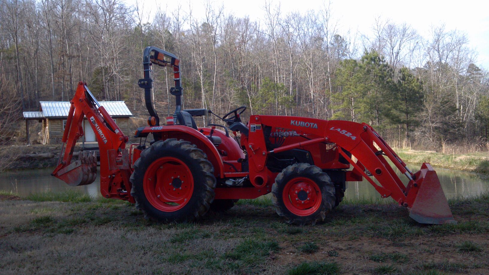

I know this isn't a BX model, but I thought you might want to see the 55 watt Halogen lights I put on my L3200 rops. I ran them on a separate circuit from the battery with in-line fuse, and have had no problems with them. There are two to the rear and two to the front. They produce plenty of light, but as mentioned by several TBN members here, if you want less power consumption go led, but for me the cost was way too high to justify that....maybe later! Just thought this might give you an Idea of what you could do on a BX rops like I did on my L3200.

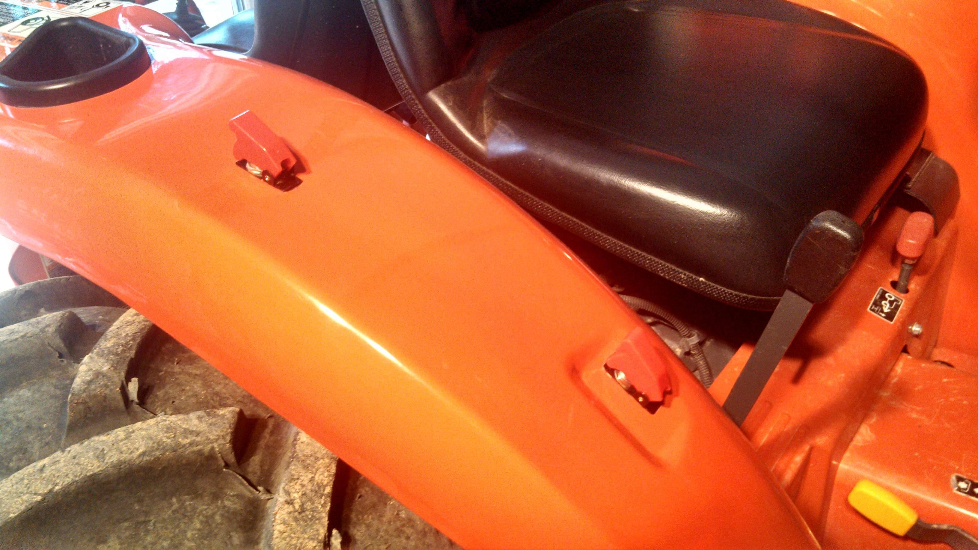

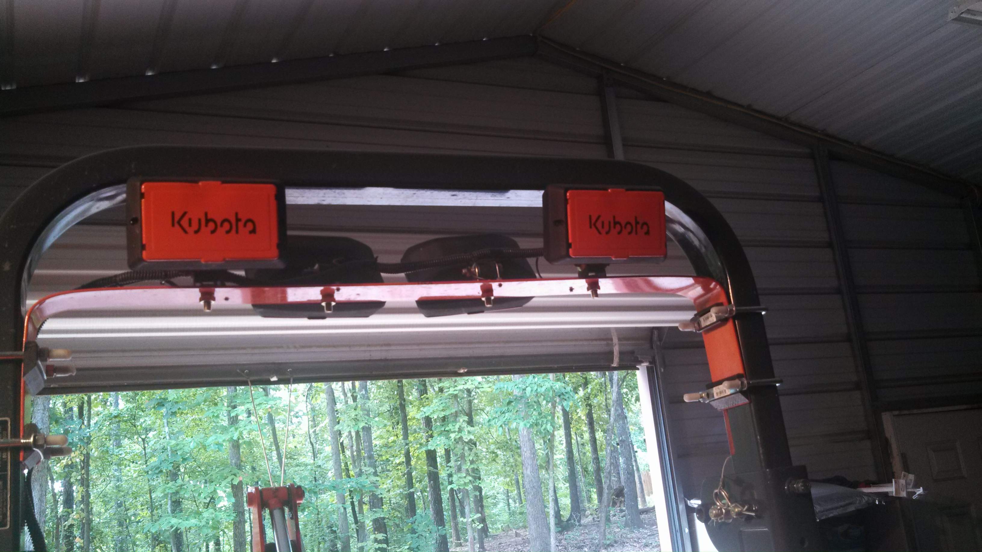

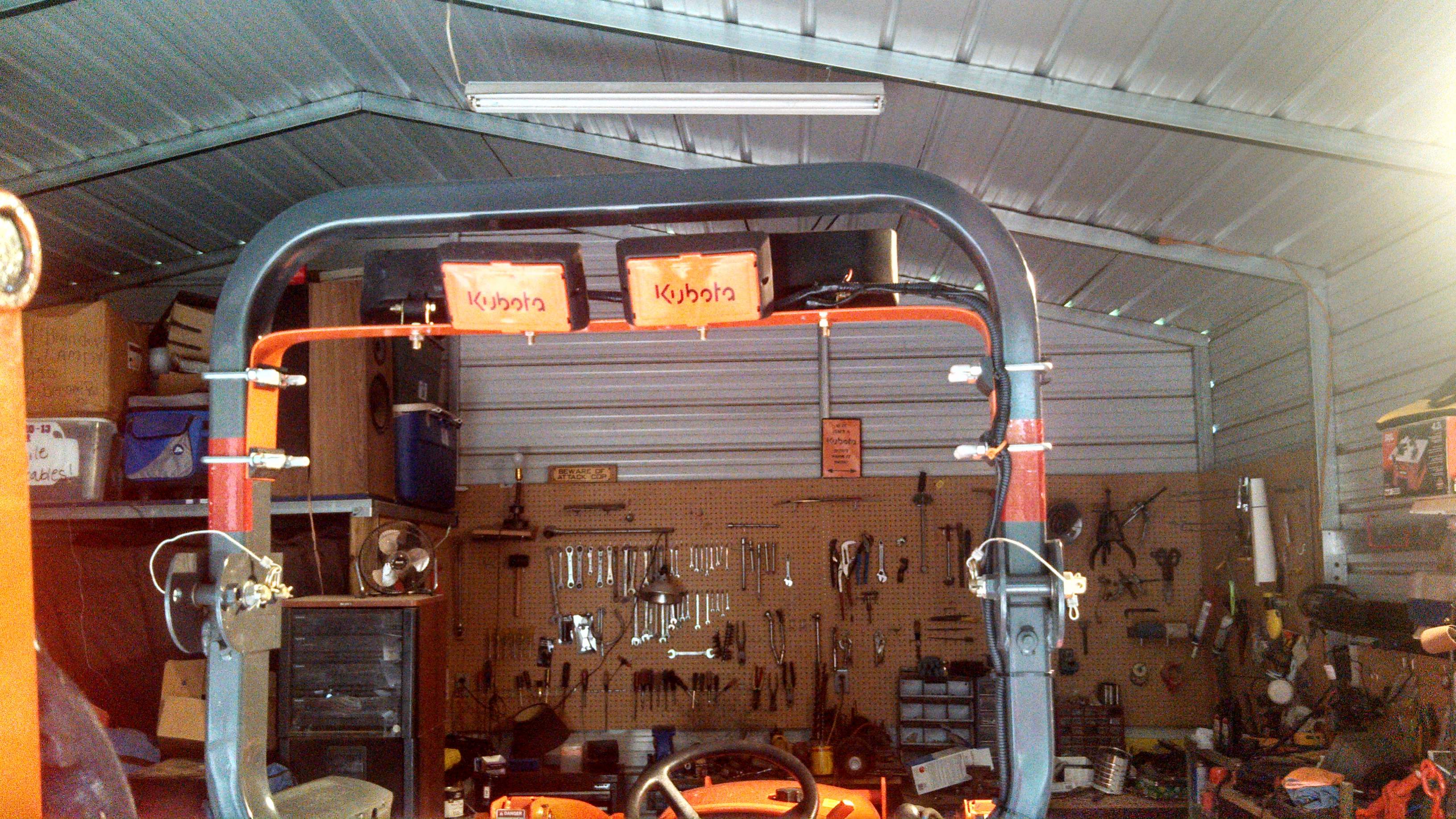

Here are pictures of what I did. The lens covers I custom made (painted Kubota orange, then had small Kubota vinyl letters made), and the switches fit perfectly in the holes already drilled by the factory for an optional right handle. Also, the bar holding the lights is NOT drilled into the ROPS (this would void the warranty)....instead, I fastened them with u-bolts to the rops, then capped the excess bolt threats with plastic caps to avoid bumping your head and cutting yourself. I also included a picture of the in line fusable links located onder the dash cluster for extra protection.:smurf:

You've done a fine job with those lights. Everything you did looks nicely done - from the painted and curved mounting bracket, to the secured and shielded wiring, and to the fuses and switches. Well done! If necessary, are you able to fold the ROPS without removing the lights? Switches look like they have a security cover to prevent accidentally turning them on. Good idea. Are they weatherproof switches? I have purchased and mounted a grab handle on my right fender using the predrilled holes. I will have to come up with a different place for the switches. I'm not real keen on drilling holes on the tractor unless absolutely necessary. The light covers you fabricated are a nice touch. Anyhow, good installation and thanks for the info and pictures.
