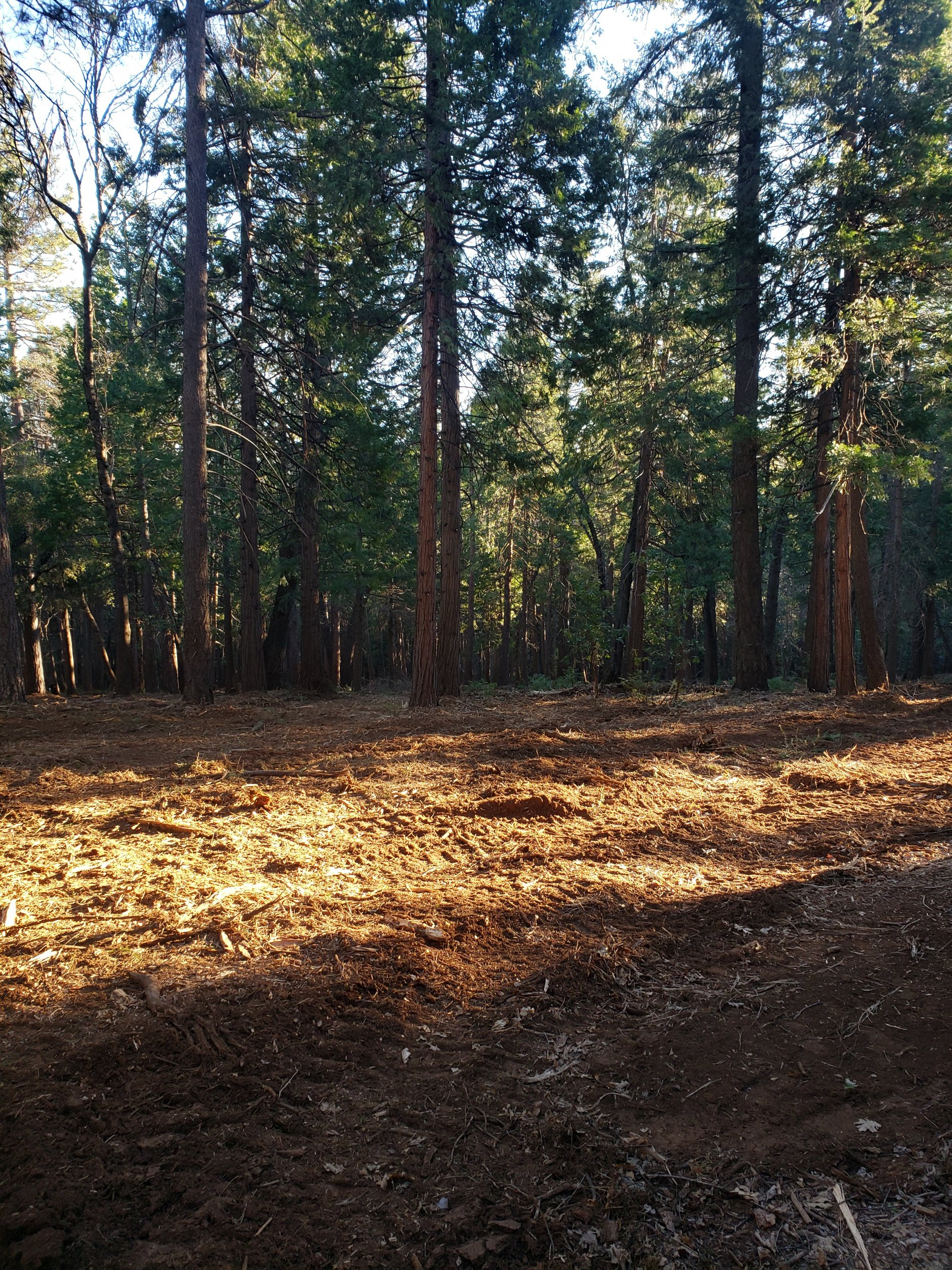

So...I just had my 15 acres of heaven masticated. It opened up the forest and looks freaking amazing!! Here's the issue. It left the forest floor torn up.
Question 1. How do you recomend I level out the forest floor? I have a box blade and a forest rake. I don't want to rake up the masticated mulch. Its good for the forest and the animals. Same issue with the box blade.
Question 2. My property is/was covered in brush, small cedar trees (we call it cedar grass!) and black berries. To maintain the cleanliness of the property, I'm thinking a flail mower. Would that be a good choice? The tractor is a Kubota M6060

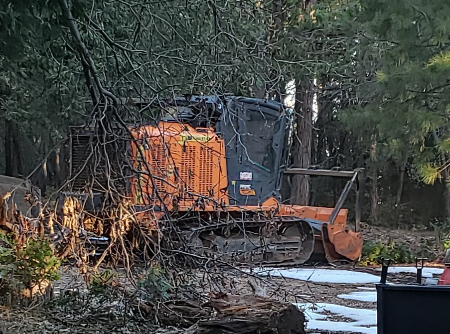

My forest was so overgrown as to be unusable. Its also a way to drastically reduce fire hazards which, in California, is a BIG DEAL!!!! It also make the property more usable.

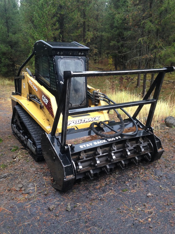

A Masticator is a skidsteer on steroids that eats trees!

Whatever you do, make sure that you distribute the chips so they are not more than 3-4” deep and are discontinuous with gaps of bare soil so grasses and forbs can grow. Otherwise you will have no ground vegetation and just wood chips.

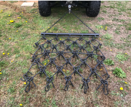

How about a chain drag?

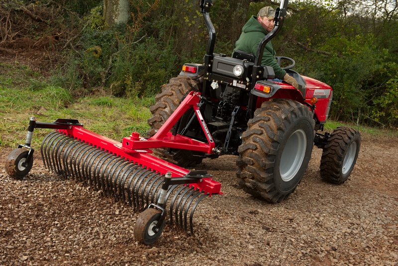

Or maybe a landscape rake?

chain link drag harrow works well for us.
one side is aggressive,
other side is not - good for grass seed prep and turning in small seeds.

Chain drag with tires for ballast might work. I have a landscape rake. To aggressive. I think the harrow would be to. I want to leave the mulch.

I had ten acres forestry mulched (what we call it in Tennessee). I used a landscape rake but I removed every other tine so it allowed the mulch to spread and flow through the tines.

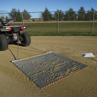

This "drag" I made out of scrap lumber works very well. Pulled with my ATV using a rope harness. One side - aggressive -- other side - smooth.
