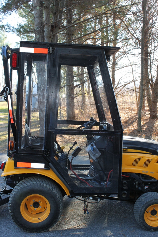

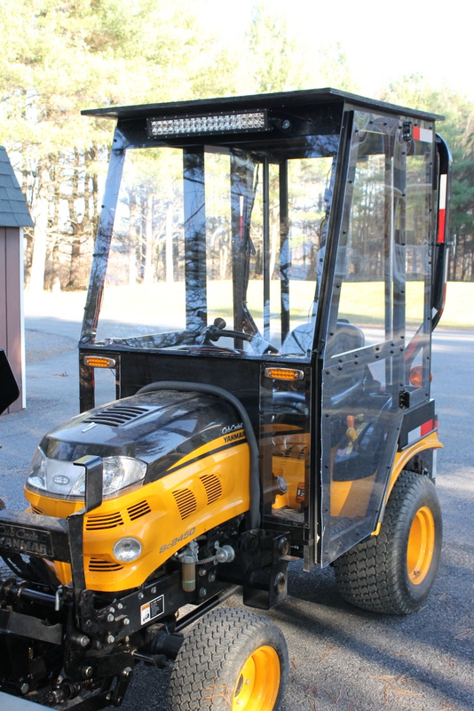

I had one from Bercomac for a few years until built a winter cab.
4" Soft Cab for Compact and Sub-Compact Tractors
Was not the greatest, still let in some snow and wind around the bottom but it was alot better than nothing

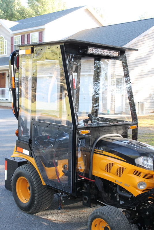

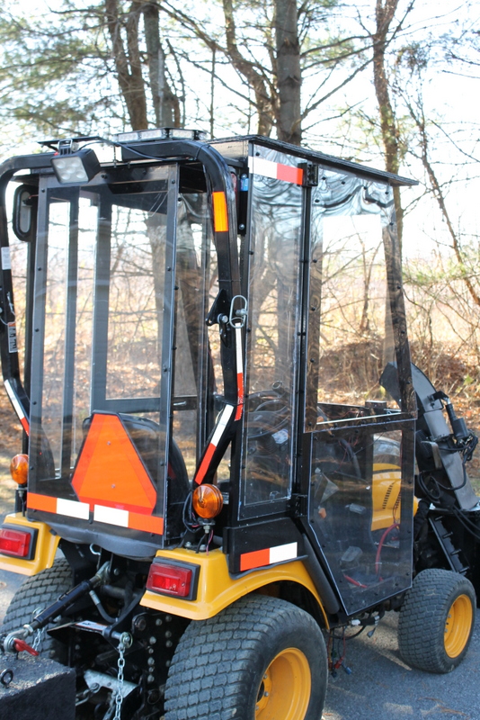

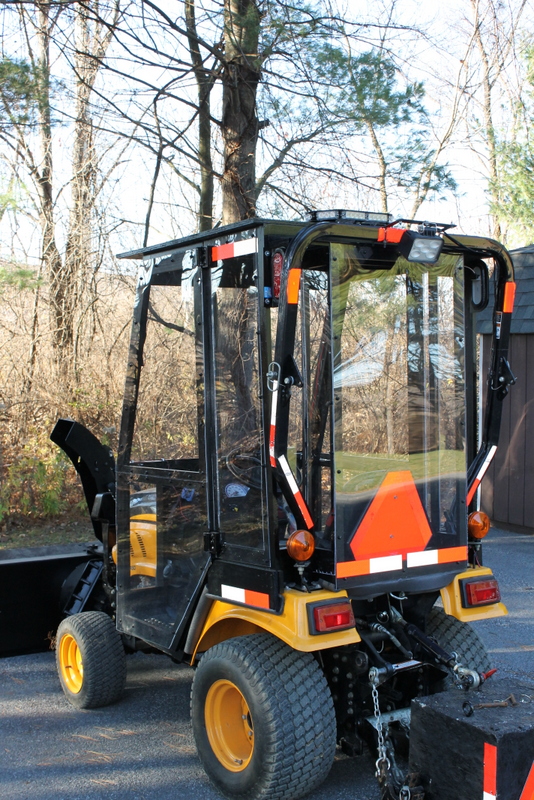

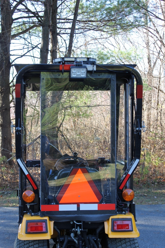

Here are some pictures of the cab I built out of wood and plexiglass:
