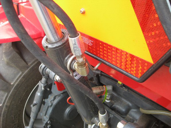

By chance if you were to twist the OEM holder hook 90 degrees, would that then latch onto the hydraulic port? That is what I did for my 3215 and it is about perfect.

I tried to bend it, no go

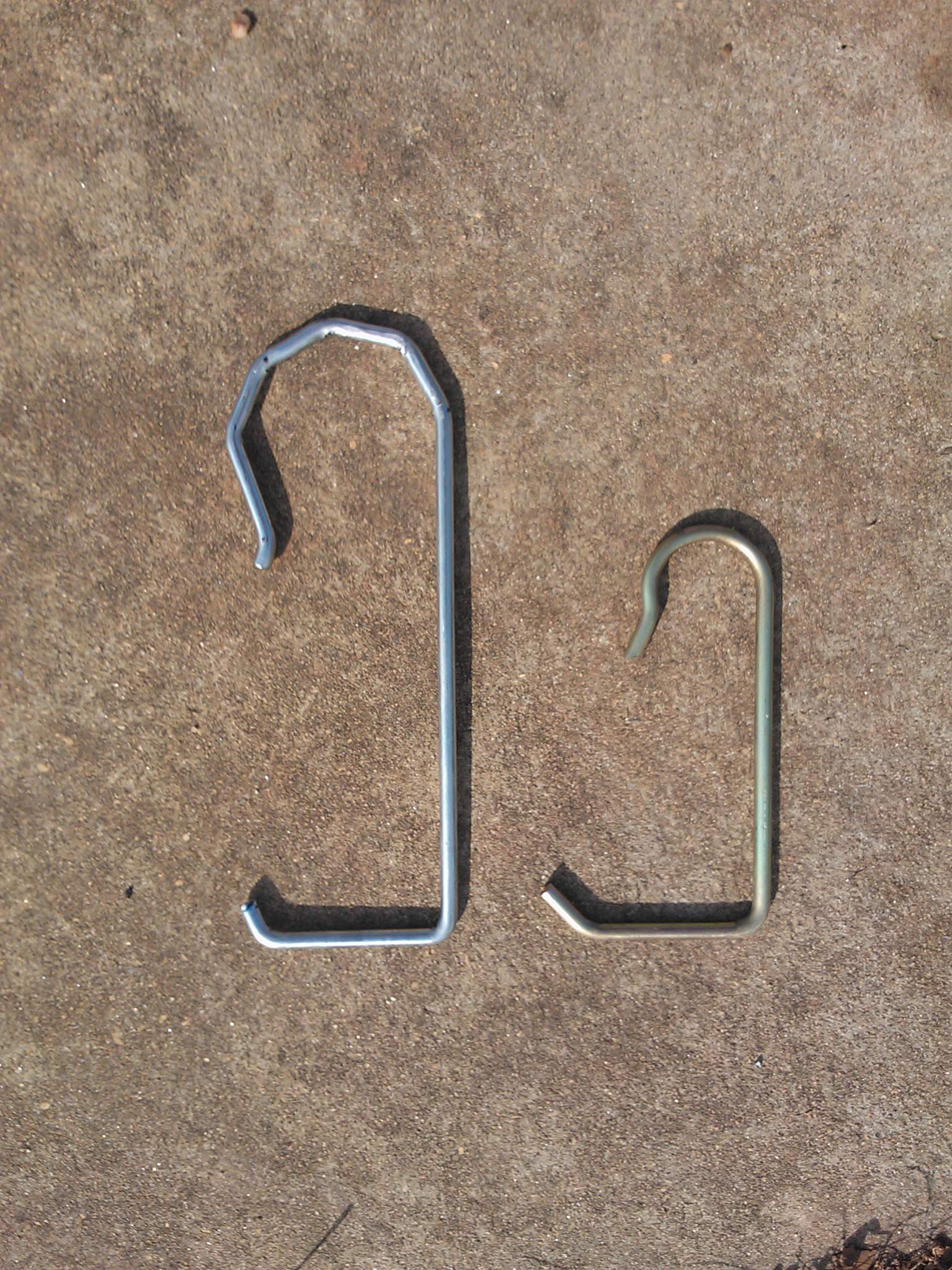

I went to Home Depot. Got a length of 1/4" zinc plated rod. With a hammer and a vise I bent into shape. I even slid a piece of clear 3/8 tubing on the hook end to keep it from scratching the top link cylinder. Then I mounted it where the original was. You can see the original and larger toplink holder I made in the pic.
