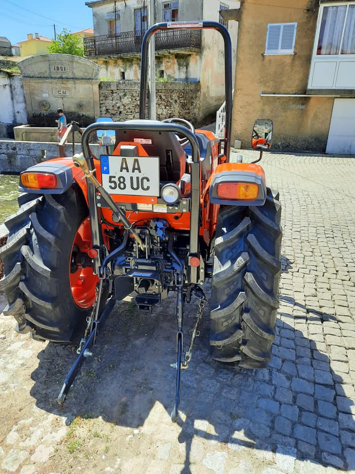

Hi -
Let's assume you are in the market for a new 45-55 HP tractor with FEL. It will work about 30 acres tillable land and 50 acres of woods. Land is almost completely flat.
These days, it seems R4 tires are more or less standard on compact trators. What's wrong with good old-fashioned Ag R1 tires? What would be the downside? Where do the R4 tires outperform R1 tires? The tractor will not be used to mow a lawn - that's what a lawn mower is for.
Thanks!
That kinda answers your own question.
For your application, I would definitely go for R1 but even better than that, I would go for R1 radials. Better traction, will last longer, offer a better ride, better stability are just a few of the advantages. Main disadvantage being the price.
While is not common in the US to use radial tires on smaller tractors, on this side of the pond, we used them from 20 HP tractors up to the big boys.
100478613_1514826088675956_8005536671414091776_n.jpg100090262_1514826168675948_4819208027737423872_n.jpg
Best post yet.
