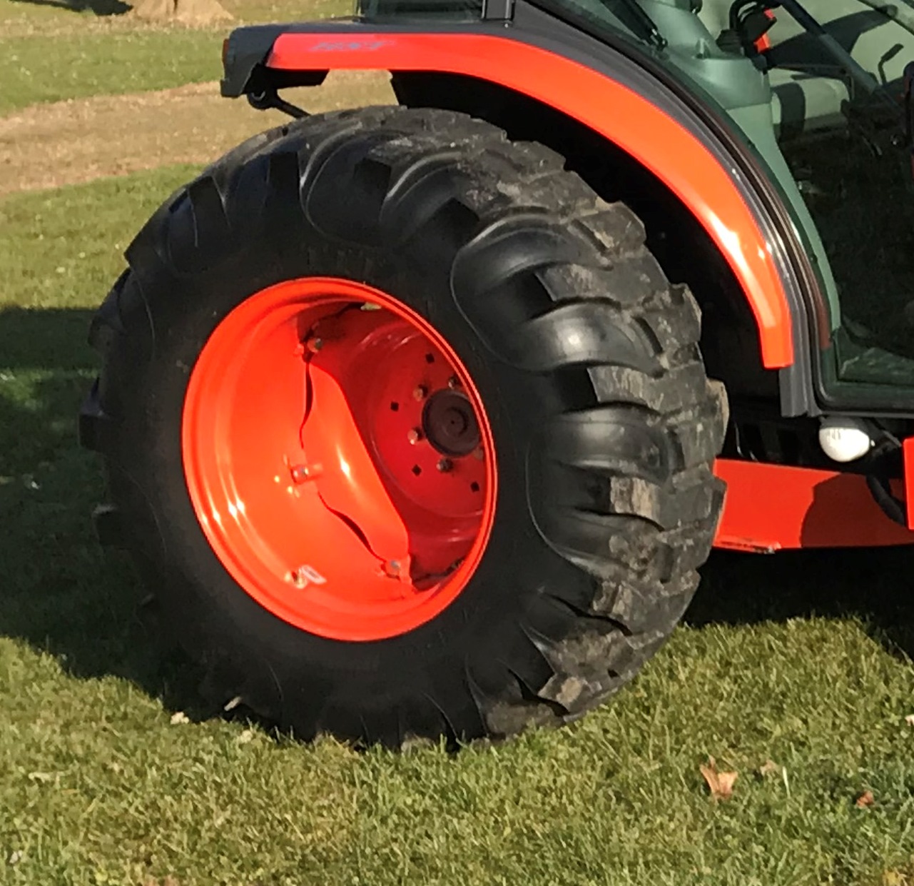

The rear wheels on both my Ford (R1) and Kubota (R4) are adjustable for width. I'm thinking the adjustment is based on rim choice rather than tire choice. Flipping and flopping the rims and centers allows a wide variety of width choices. Here's the Kubota.
   / Ag R1 tires or R4 #18
Nice tractor!
If I remember correctly, I believe you can widen the R4s on the Grand series, but not on the economy L like mine.
