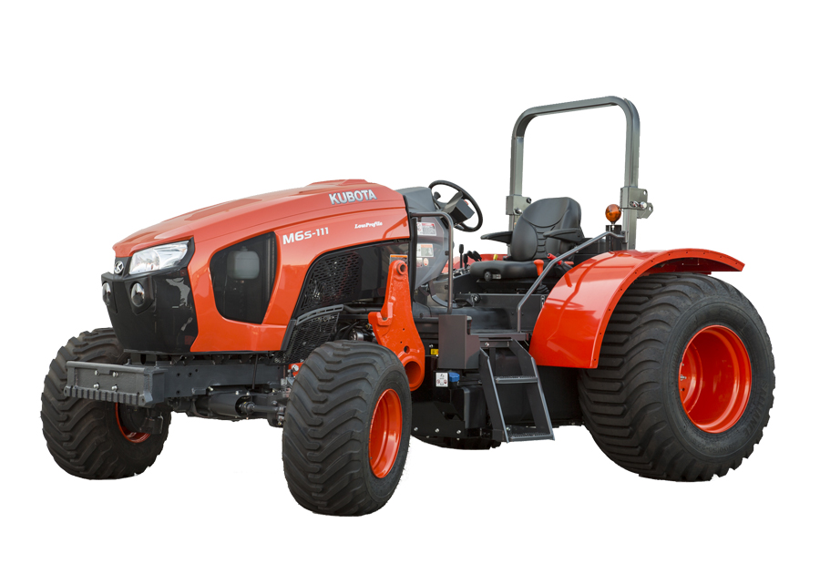

   / Age old question; which tractor for steep hills #2
Maybe:
https://www.kubotausa.com/products/tractors/specialty/m-low-profile
Bruce
Unfortunately that comes in at 58,000 for the base model...
