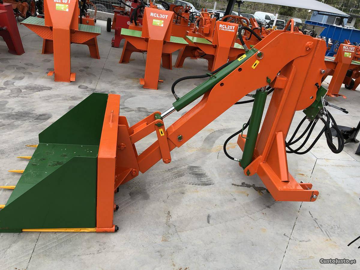

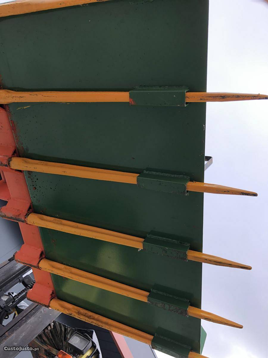

Here is very common to use rear loaders made for the 3 pt hitch. Might be a good solution for you. It's cheaper than a front loader and it's still very useful.
It's a good solution for articulated tractors like Antonio Carraro, BCS, Pasquali and a some others. Specially with reversible driver platform.
These are often made for loading manure onto trailers, that why you see the spikes on the picture, but it can be easily changed to a grapple or something. Some will also have extendable boom.

Those are very clever. I've not seen those here before. Might be a good option for the OP. I'm fortunate enough to have 2 other tractors with loaders on them so I haven't had a real impetus to 'solve' this but something like that clearly would.

I can give you a couple websites but it will only be Portuguese websites. I'm afraid that there aren't any companies doing this type of loader in the US or Canada, so it would need to be fabricated.
https://agroramoa.pt/wp-content/uploads/2019/08/Carregador-Traseiro-Agricola.pdf
Agriduarte
These two are two of the best brands here when it takes to implements and loaders.
I'll give you some specs for those rear loaders. Both have telescopic arm with 3 positions.
Max lift/height: Position 1 - 1800 lbs @ 100"
Position 2 - 1600 lbs @ 112"
Position 3 - 1488 lbs @ 124"
You can also get buckets, spikes for manure or bales, grapple, forks and a hook to use it as a crane. Since it's a single arm design vs the two arm on a front loader, the attachments are usually narrower (40" wide) than what you are used to.
The price here, goes from 900€ (1000$) to 1100€ (1220$). The cheaper won't come with its own valve, so you would need 2 sets of remotes, one for lift and another for curl. The expensive one comes with a 2 element valve.
