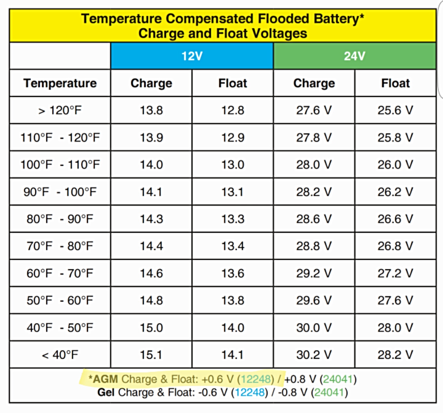

AGM batteries actually have a higher static voltage than lead acid and do infact take higher voltage to charge. In colder temps Ive seen OEM car manufacturers pushing 15.5 volts or just over to charge them. As temperature rises the voltage drops. See the attached image i highlighted the bottom showing that the battery minder uses a 0.6 v higher float and charging voltage.

Definetly get a multi stage smart charger prefferably one that is temperaturecompensated
