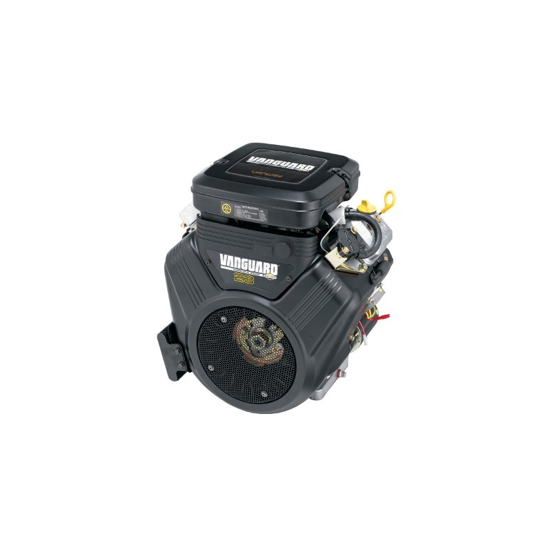

B&S engines are made in factories all over the world, and they don't seem to be much if any better than a good Chonda. It seems that lots of parts interchange between the big thumper Hondas, Chondas, and B&S. But NOT Kohler. There are some good comparisons on Utube by TarylFixesAll.

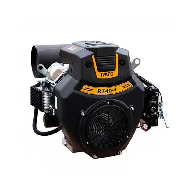

Looking at Lots of Auction Photos, The B&S don't have Orange Labeling, Tin Exhaust Shields with "HOT" stamped into it,. I think that the "R" in AGT QS12R/QH12R stands for RATO. H15's are starting to show Knock Offs
It's not a Problem, hec even B&S isn't B&S anymore. My Mini Skid has a RATO a B&S Vanguard Copy
ChongQing Rato has been around a long time. The 420 motors are affectionately called Chondas, as they copied Honda GX390s many years ago. If anything, Briggs
engines have gotten more like Honda GXs lately. They used to be considerably different. Who copied whom?
Rato has been one of the suppliers of Chondas from HF. Predator engines are looking pretty good these days in the crowded arena of Chonda engines.
As for the twins, I bought a new Predator 670 twin a couple of years ago, and it was nearly the same as the Honda GX620 I replaced. I have a Vanguard twin here, too, but it is way different.
   / Agrotk excavators: Does anyone have one? Opinions/comments/critiques? #160
My 739cc is very similar to a Vanguard not sure if it is sleeved or not though. I only have 4 hours on it but great so far.
