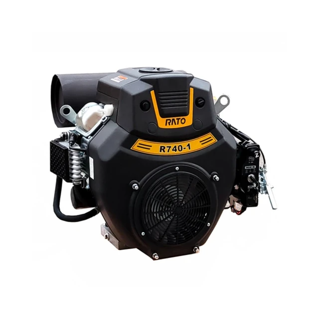

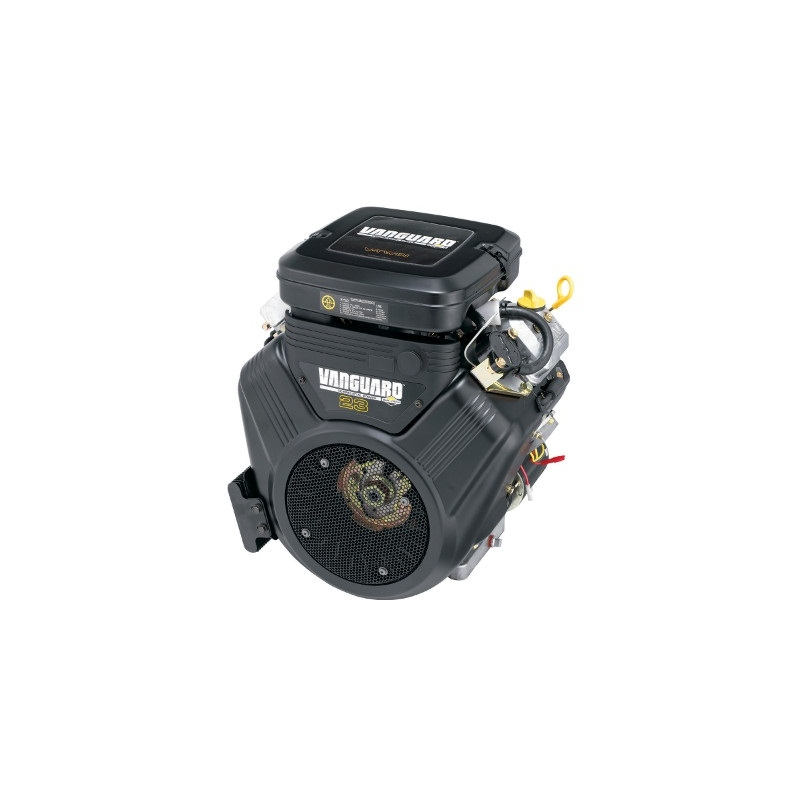

My 739cc is very similar to a Vanguard not sure if it is sleeved or not though. I only have 4 hours on it but great so far.
It was shipped with heavy oil I believe, anything around Freezing Point, it won't crank over without a Booster Pack.
Heavy Oil, No Hydraulic disconnect, any a low CCA battery
That Rato is a good looking engine. I hope its as good as the Vanguard. IMO the Vanguard is the best engine Biggs ever made.

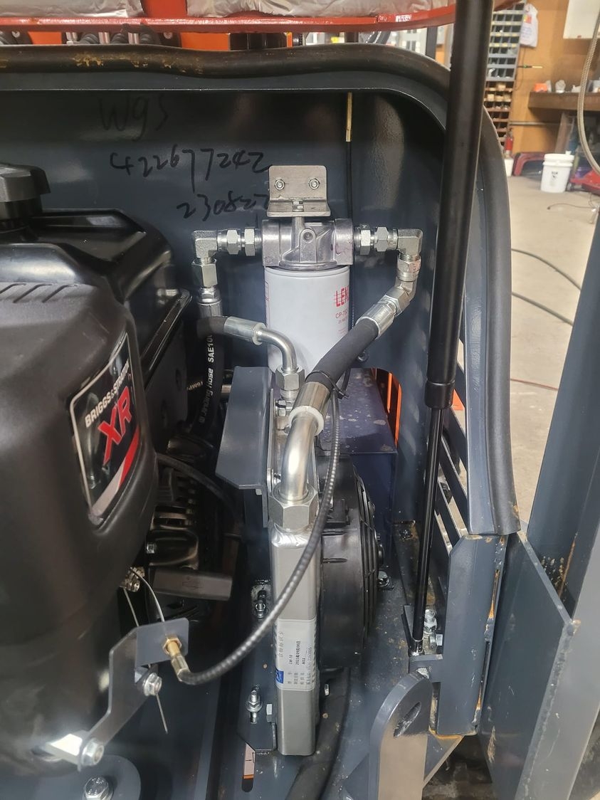

2 weeks ago, I gave 6500 for my AGT L12, delivered and tax included. After 12 hours of use and a few improvements, I am very satisfied with my little machine. i will continue to update problems and fixes as I find them.
Access to the engine compartment is way more convenient than the H12 model. How has that worked for you? Did you get the hyd. filter installed?

Access to the engine compartment is way more convenient than the H12 model. How has that worked for you? Did you get the hyd. filter installed? What model engine do you have?

I have the Briggs 13.5 XR, which so far, has been flawless. I am trying to find a local shop to make the hydraulic lines for my filter install.We had a Napa in town that did almost everything anyone would ever need. Sadly they went out a few years ago. This is a pic of how I am going to install filter. Hope this helps.

I have the Briggs 13.5 XR, which so far, has been flawless. I am trying to find a local shop to make the hydraulic lines for my filter install.We had a Napa in town that did almost everything anyone would ever need. Sadly they went out a few years ago. This is a pic of how I am going to install filter. Hope this helps.View attachment 846045

I will be ordering my L12 on Monday. Any information on the hyd filter parts set up would be appreciated. What are the oil spec's & quantity for the engine. I want to have that on hand when it gets here.

Its possible the 2024 L12 may have improvements over my 2023. They seem to be listening and learning as they go. Would be nice if they have added filtration. You should read my post on some flaws with the L12 before you decide.
