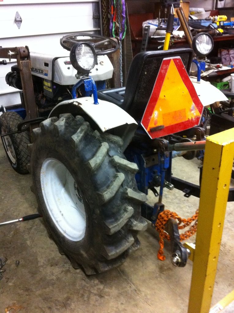

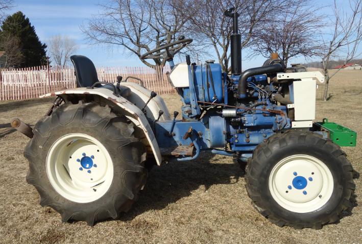

I just put 9.5-16 rear Firestone R-1s and some china brand 6-12 fronts on my Beaver:

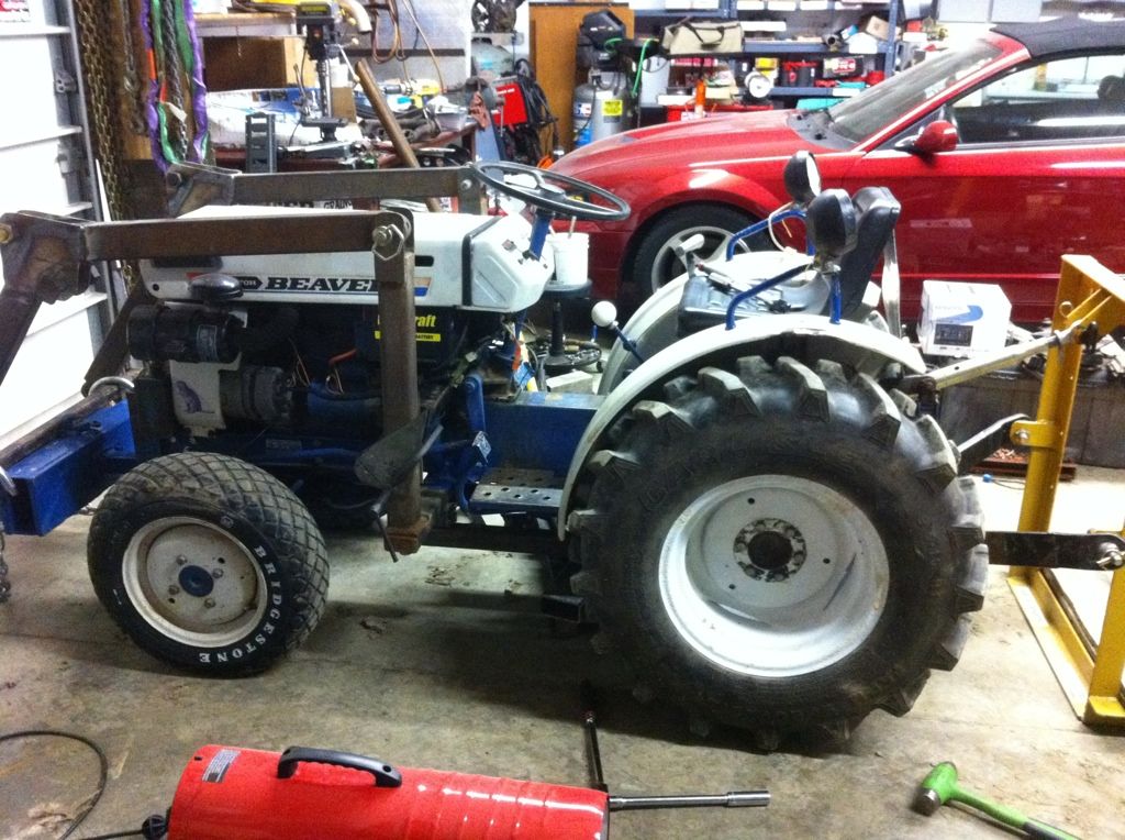

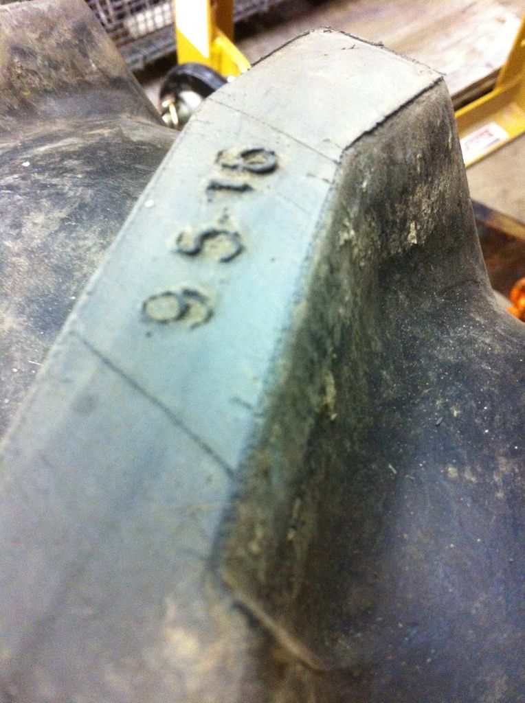

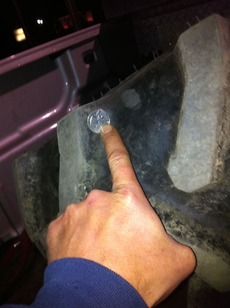

Well I just assumed a 9.5-16 turf was the same as a 9.5-16 r1 ag...
I ended up trading the guy. He had restored a ford 1220 for a baseball league and didnt want to destroy the field...Wheels were the same bolt pattern. Tires are brand new Carlisle R1's 6 ply with tubes and calcium filled. Traded even up for my bridgestones... They are taller...
Before....
After...

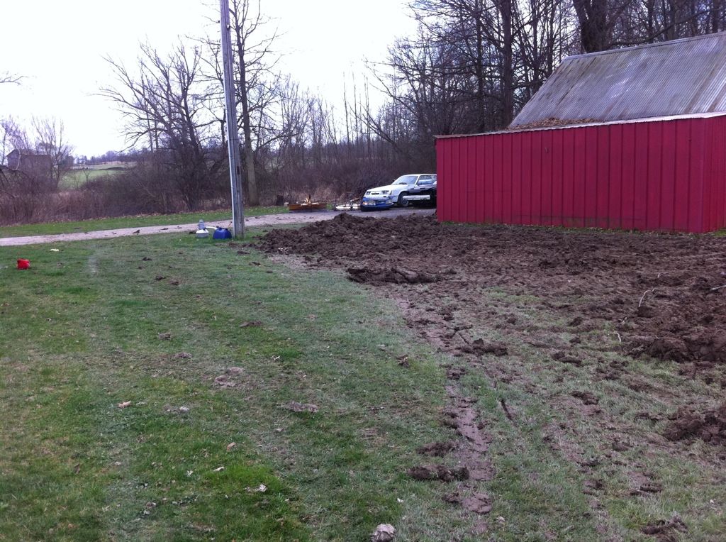

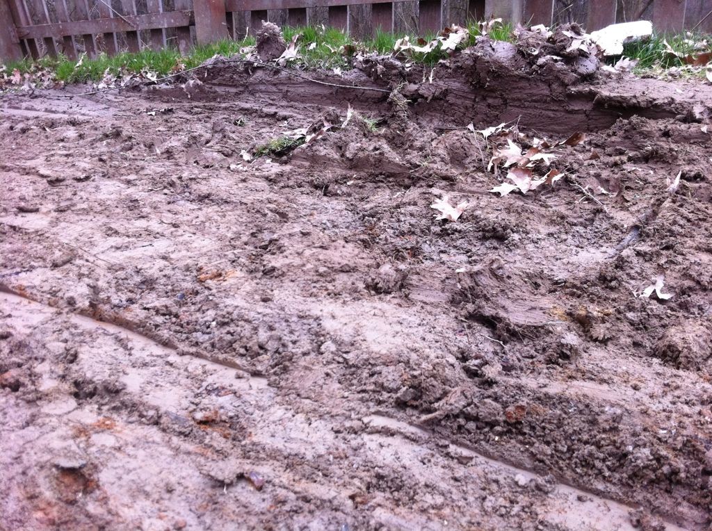

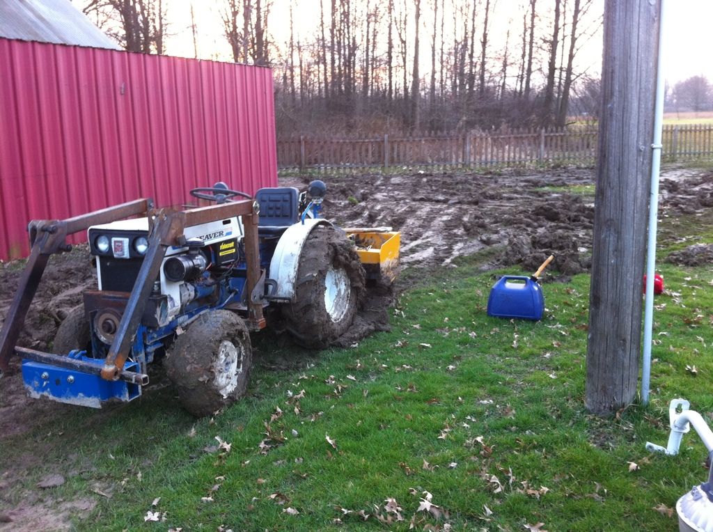

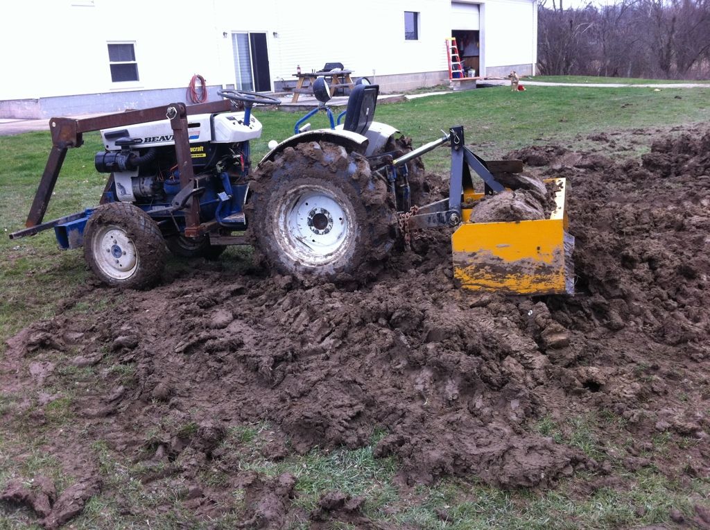

I could not believe the difference with the filled ags over the unfilled turfs. Even in two wheel drive dragging a 4' box blade in wet muck, I was amazed.
4 wheel drive seems fine, no binding or pushing with the 6-12 turfs. My ags should be here in the next few days. I basically destroyed my yard, but the swamp at my new house doesn't dry out. Im hoping my taking down about a foot of high ground above the low mushy spots, it will dry out and I can put a small graded ditch in out back. Goons have tons and tons of fill dirt and drain tile put in this summer once it dries out.

All that built-up mud is changing your tire diameters. Better be careful... :laughing:

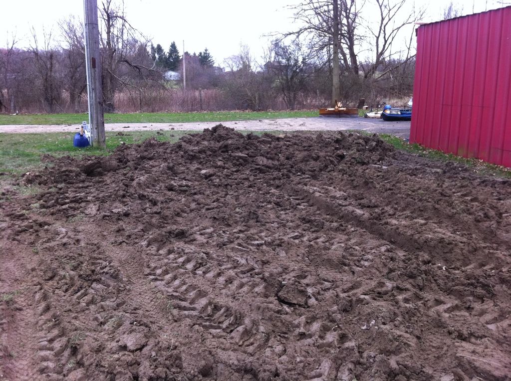

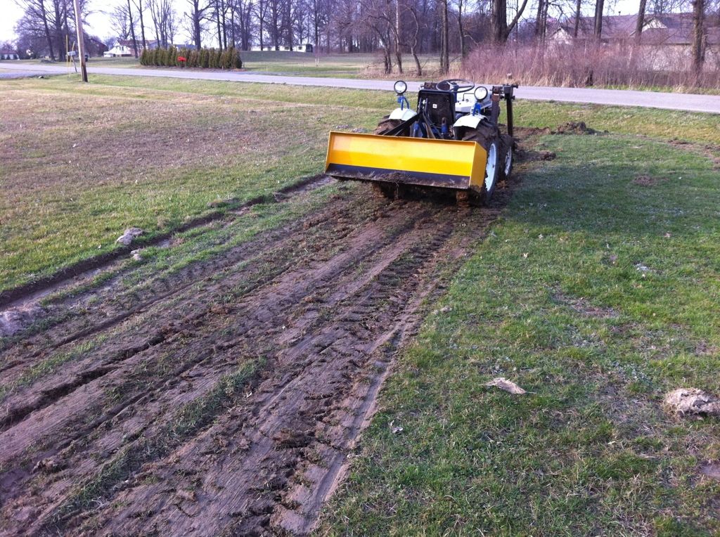

After it dried out some the last two days, I went back to work. The back corner behind the red barn and the fence was about 2' higher than the low spots in the center of the yard, along the side of the red barn. I ended up taking about 3' out of the back corner and re-distrubuted it elsewhere. Made a nice grade along the fence line down to the back corner.
Even got some help from Turbo

got the new front ags on....
9.5-16 rears and 6-12 fronts. same ratio as the OEM 8-16 rear and 5-12 front tires. Everything seems to work great
