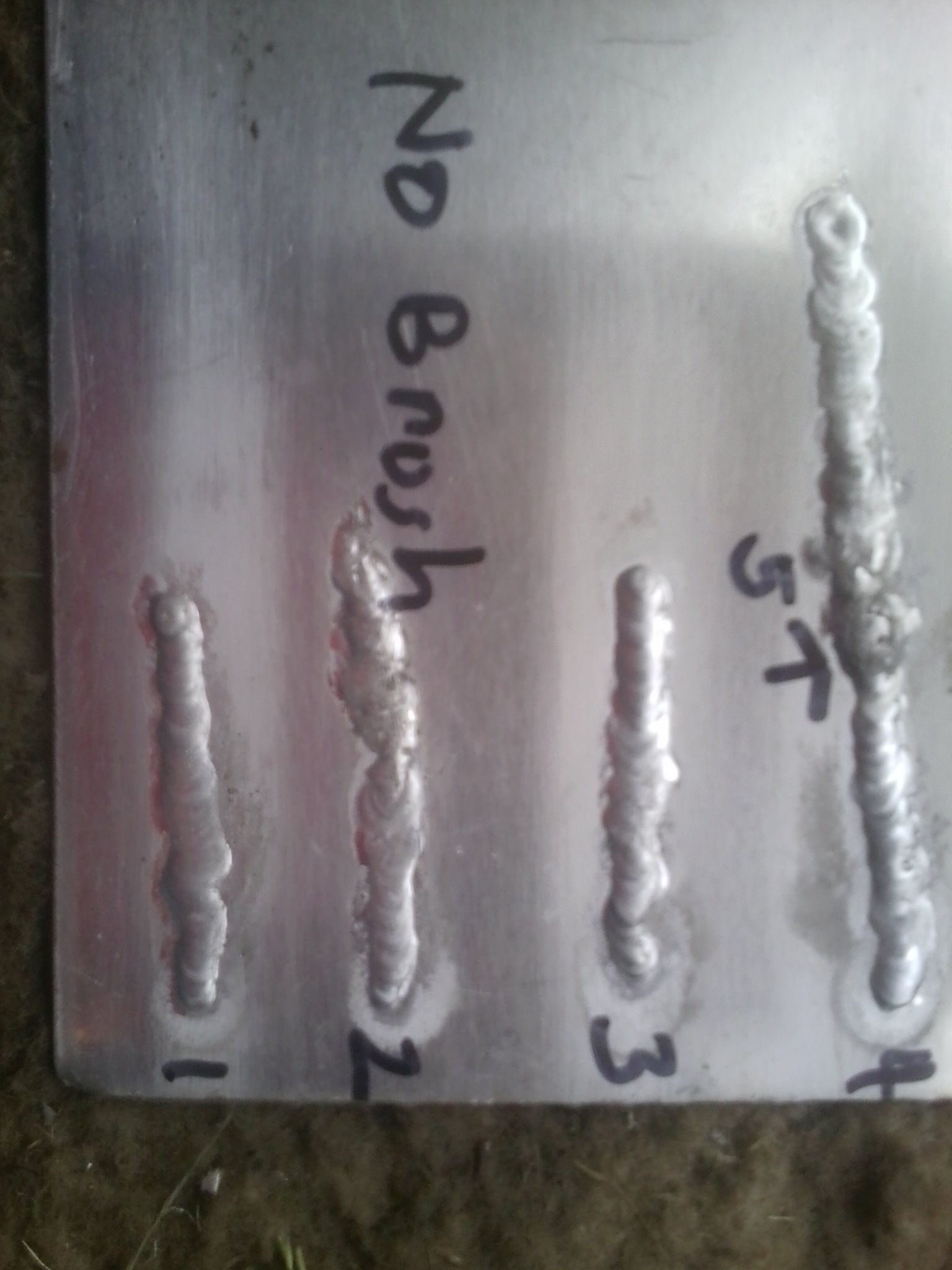

Like everyone else said clean with Acetone and stainless brush. Plus heat it up to 400-500 degrees to burn off any embedded oil and dirt.
And you may want to try running bead with no filler. This will leave a charred mess. Then brush again, and run a bead again. Repeat utill the soot goes away.
Somewhere Weldingtipsandtricks.com has a video showing this technique.

Yep, acetone, and a new stainless steel wire brush. And never use that stainless steel wire brush on anything but aluminum again!

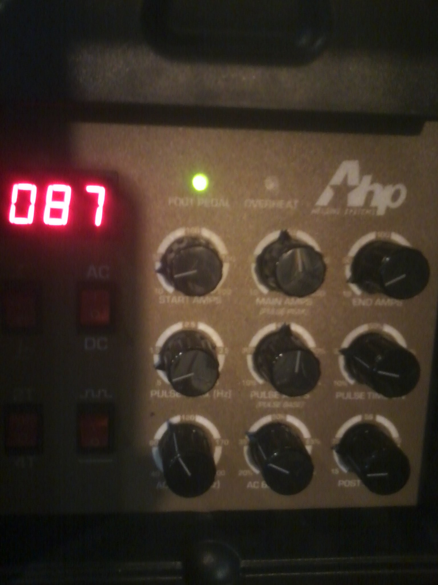

Here's some experimentation on fairly dirty 1/8" plate to test the effectiveness of brushing with the dedicated SS brush. Main amps 87, start amps 25, end amps 15, AC frequency 100hz, AC balance 30%, and post flow 4 sec. Weld one was moderate brushing, weld 2 no brushing and welds 3 & 4 vigorous brushing. Weld 4 & 5 was practice resuming a bead after cool down and I built it up on the end of weld 4 for that reason. Next time I'll turn the amps up a bit to account for the extra thickness:

OK, my welds are looking tons better as I am learning to keep the torch steady and close to the work. Here is some Dr Pepper can welding just to test the machine on low (very low) settings. For this I found the AC frequency needs to be at about 30hz, amps at 20:

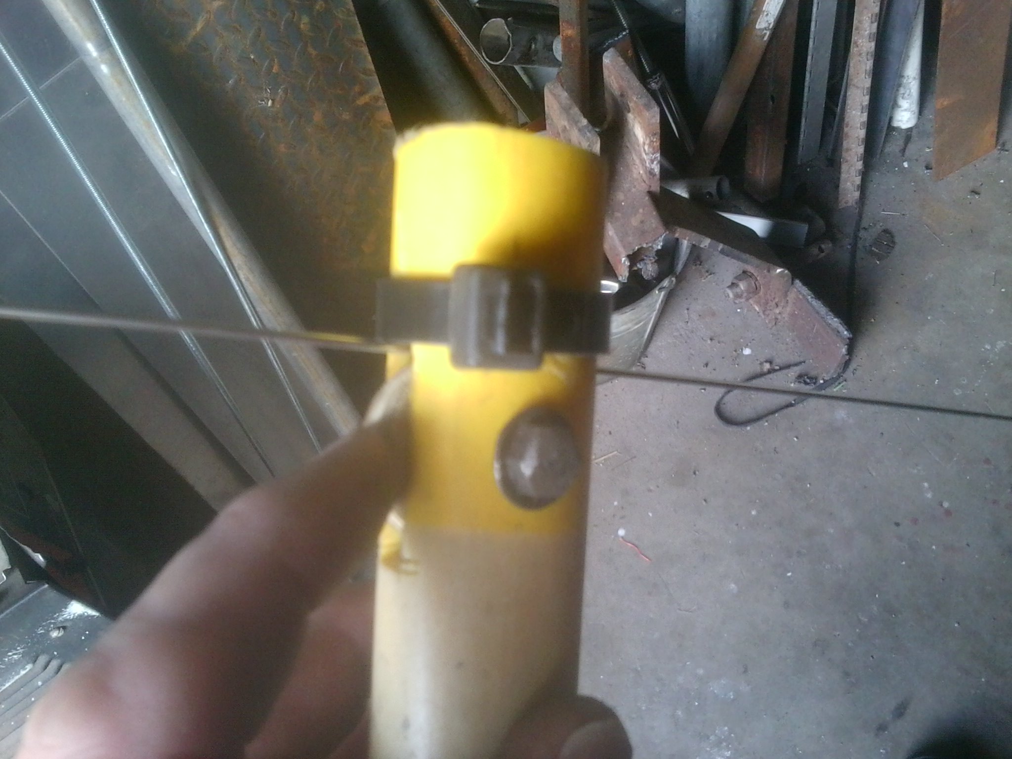

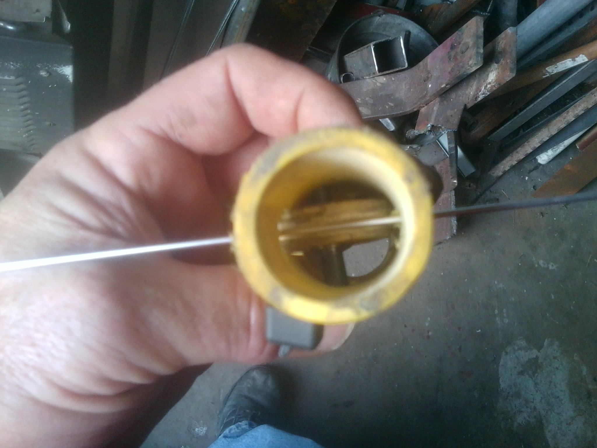

I made a small device out of a piece of broken fiberglass shovel that lets me advance the filler with one finger. Also keeps bare hand completely insulated from the filler. This helps me a lot as advancing filler with a glove on was driving me nuts:
