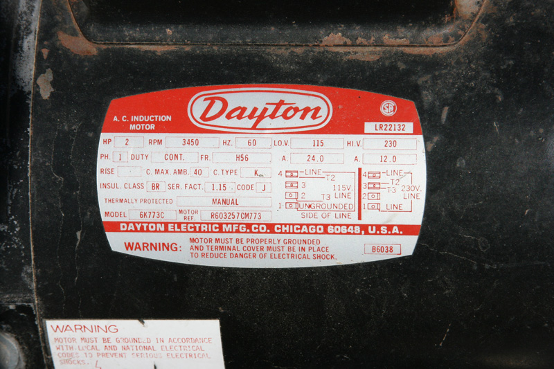

Sorry for the delayed answers, but here's what happened. First, I decided to see if a replacement switch for the centrifugal switch was available for my McGiver'd switch on this 35 year old motor. I called tech support at Graingers and they said that they would have to contact the factory. They told me that while the motor was labeled Dayton, it was actually an Emerson motor. A day lated they reported back that parts were no longer available from the factory. No big surprise there.
They recommended that I contact carbonbrush.com aka Arrowhead Electric Co. Carbonbrush asked me to send them pictures and dimensions of the switch. I sent them and a day later they came back and stated that a switch from Doerr would work. Doerr is a German electric motor manufacturer. I ordered the switch and it is almost an exact replica of my original switch. Only $16.00! The only difference was that the central hole that the bearing had to pass through was slightly smaller. Hole saw fixed that problem.
I installed the switch and did some testing. When connected to shore power, the motor draws 30 amps inrush according to my Amprobe clamp on. It has a "hold" position for maximum inrush. Next I hooked it back up to the generator. Inrush on the generator was 40 amps, but the motor ran fine with no release of factory smoke.
For now my problems solved.

I originally had a 3500 watt generator and tried to run the compressor. After about a minute it started to release the factory smoke. I stopped it and inspected the motor. One of the points on the centrifugal switch was completely melted off. I McGivered it as the motor is 35 years old and I couldn't find a replacement part. I dug through my junk box and found an old set of automotive points that had a large contact. Silver soldered it to a piece of brass shim material and then silver soldered that to the metal spring that contacted the centrifugal mechanism. The nylon "rubbing block" was also gone so I found a small piece ofnylon and epoxy'd it to the spring.
This has worked for about a year when I could access shop power. I got a new 9000 watt running 10000+ starting generator and thought it would do the trick for remote operation. I hooked it up and tried it again, closely watching the motor. After about 10 seconds,the factory smoke started to reappear. I quickly killed it. No noticeable damage this time. Tried it again on shop power and it runs OK.
The only thing I can think of on the generator power is that for some reason the motor is not geting up to full speed and the centrifical switch is not disengaging allowing the start capacitor to remain in circuit. This will cook the windings in short order.
The 9000 has more than 3 times the power needed to run this motor which has a RLA of 12 amps.
Since I just use this compressor a couple of times a year for small projects, I think I will just install a 120PSI blow off and let it run. This motor doesn't have a governor so there is no practical way to make it idle down. I'll just manually adjust the speed to keep the pressure close to blow off pressure.

By ACTUAL testing the compressor only had an inrush of 40 amps on the generator and 30 amps on shore power. The 9000 generator has a run capacity of 37.5 amps and a start of 42 amps.
Where in the world did you come up with the 10x figure?
