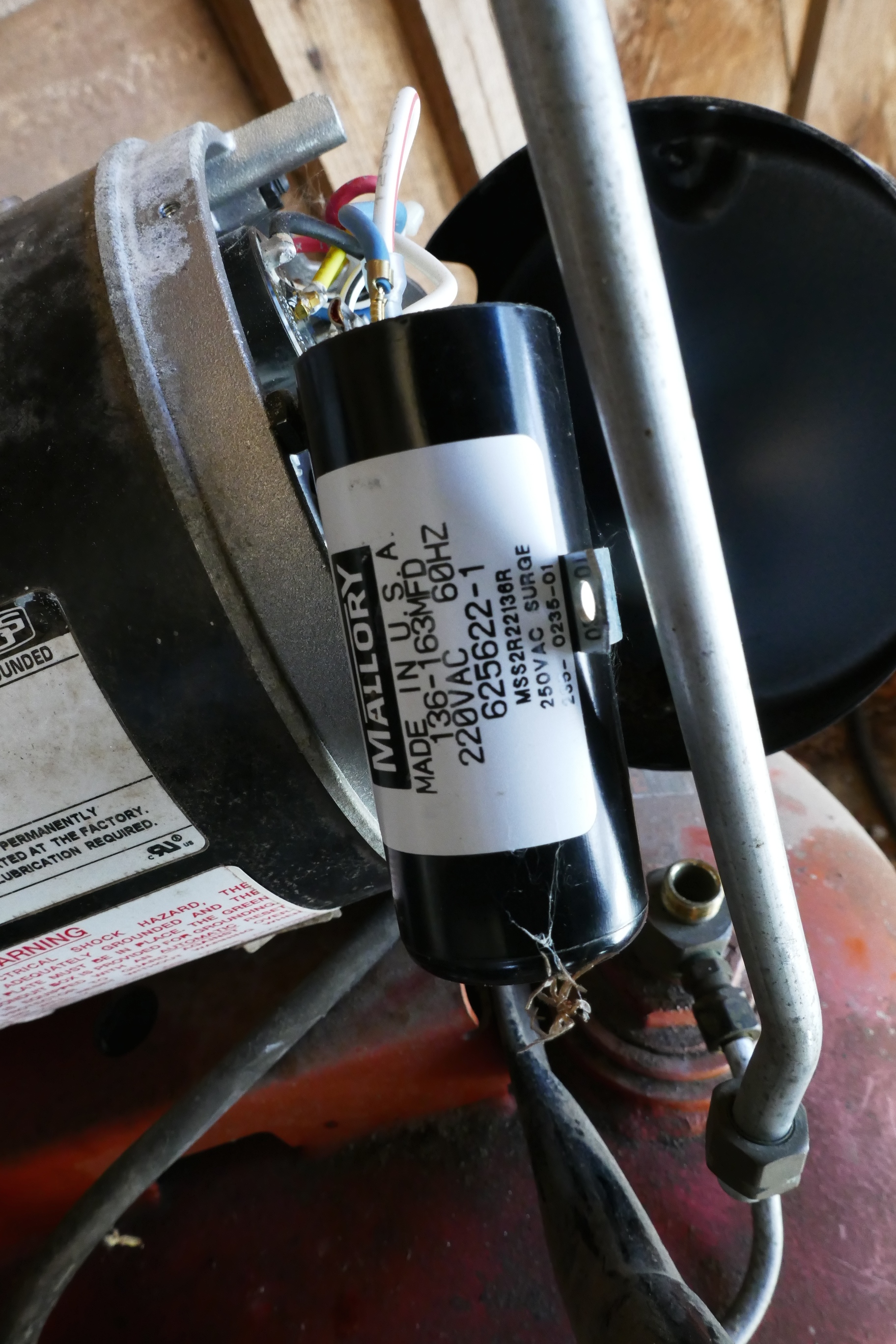

Craftsman 30 gal. oil less. Attempted to start it one day recently. Motor ran weakly for about 3 seconds and then it tripped a breaker. Tried it on different amp plugs and still always blew the breaker. No air in it at start up. Turns easily by hand. Tried a new capacitor (cheap enough at $9) of the same 30 mf -370 v. Did the same thing. Tried it with no capacitor and it did the same thing. Tested both capacitors and they both react the same on the volt meter with a quick swing and back so I guess it was never the capacitor. It does not have two capacitors, just the one. Why does it do the exact same thing with no capacitor and what clue is this giving me?

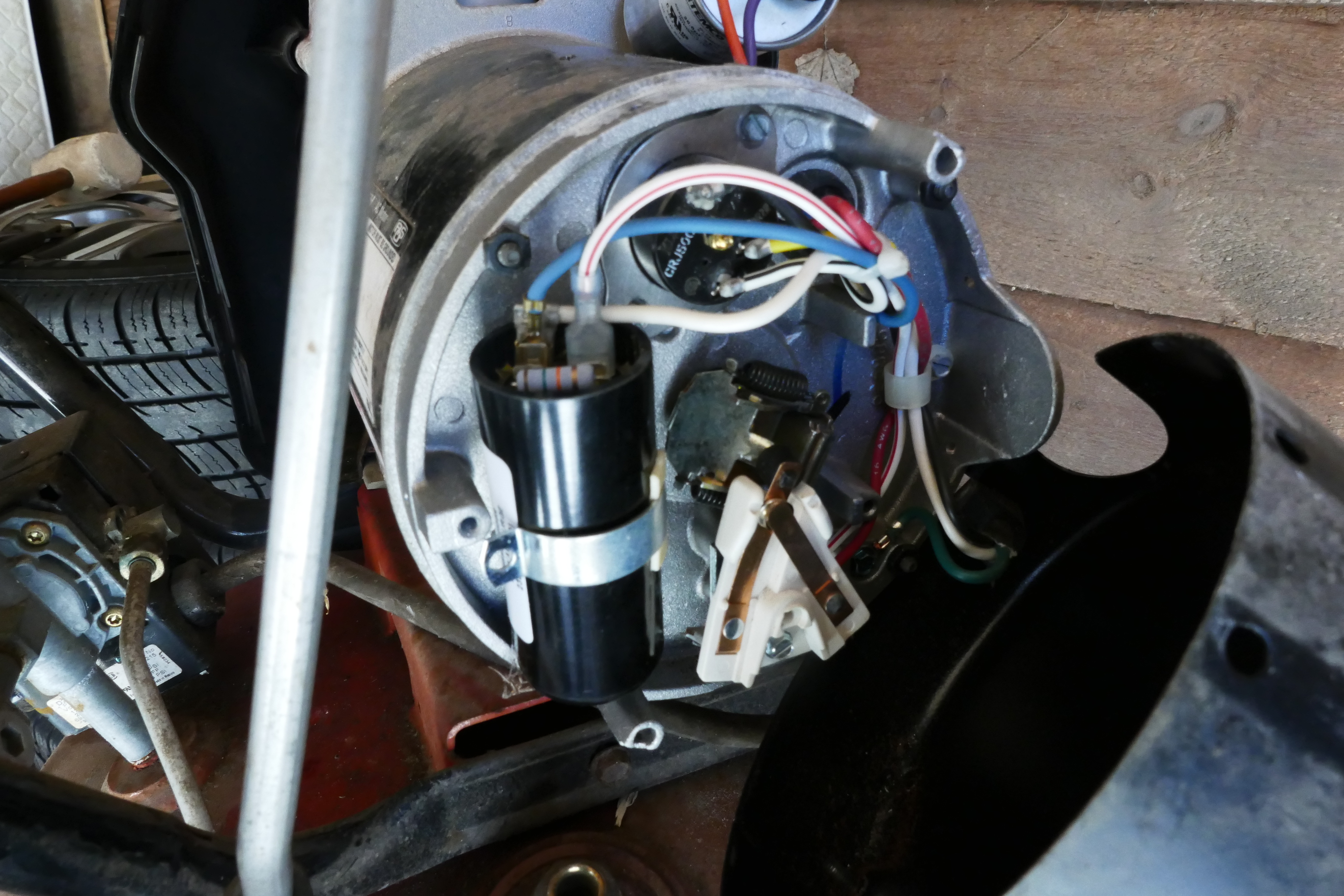

Thanks Raspy. Did as you suggested to no avail. Points were together when I found them and there was a little oxidation that I filed off. Everything else in there looked new. I spun the motor slowly by hand at that point but saw no difference in point separation if that was supposed to happen. I then attempted to start it and again saw the points pulse back and forth but did so as a unit and still no separation. Starter switch checks out and even if it didn't, I'd be reluctant in buying a $132 non returnable part on a $300 compressor before I bought another compressor. This thing is only 13 years old of relatively light use. Perhaps that's oiless compressors are supposed to last motor wise. Am at a loss as to what to try next but I have a nagging feeling that there is something real simple causing this.

I was told by a Sears tech that this motor does not have a separate capacitor for start/run functions. The switch turns the thing on ok but it just isn't getting to speed. What's this thing I found in there?
