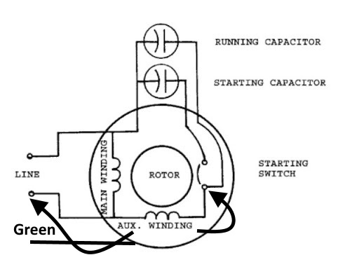

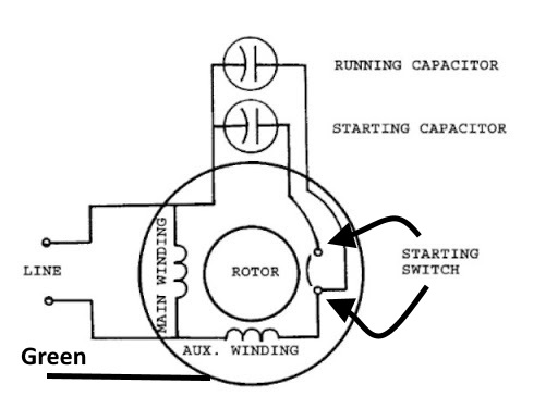

No, measure across (one probe on each side) the switch and across the winding, in Ohms to check for continuity.
The switch opens after the motor starts spinning, so it will be closed with no power applied.
Note: black to ground is for measuring DC voltage.
Read and learn: How to Use a Multimeter

Thanks XFax. I have some type of reading deficit. I can read a small paragraph but anything after that my brain doesn't process in a cohesive manner.
Please bear with me but I think you mean one probe on the start contact of the switch and the other further up the circuit (winding?)

No problem, ask again if needed.
Across the switch.
Across the winding.
