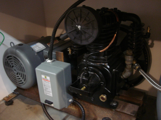

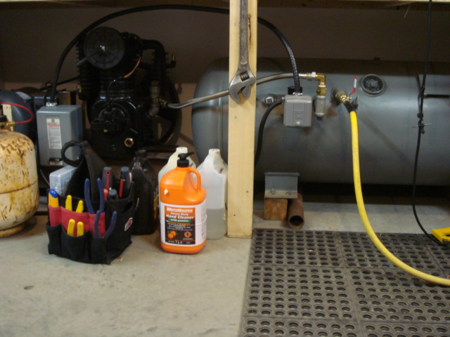

Just a thought for the build it yourself discussion page. Attached are a couple of pictures of my unit, built from components commonly available. The compressor head was purchased on sale for $299, the 5hp commercial motor was the same. The electrical (heater start and switch) portion was purchased new off Ebay for $40 and the pressure hose (stainless weave over silicone hose) was $70. The tank is a propane tank from a large truck. I picked it up at a local auto wrecker for nothing. (They cannot be reused as fuel tanks unless tested, a costly proposition. The guys thought it would make a great tank and just gave it to me). Total cost was $750 dollars including the belts and pulley. The unit produces 18 cfm @ 175 psi. Because of a number of issues (the used propane tank and an off shore two stage compressor head), I set mine to cut in at 125 psi and out at 150 psi. I use it for everything, but built it mainly for sandblasting, which uses a LOT of air. I can blast none stop @ 90 psi without drawing the tank below 125 psi. This compressor runs really well and is extremely quiet. The reason it is so quiet is simple, the compressor head is mounted on a steel frame and not on the tank. A tank simply acts as an amplifier for the head, kind of like a drum. While this is running, you can easily have a conversation standing directly in front of the bench. I am going to have a plywood cover for the front which will make it even nicer.

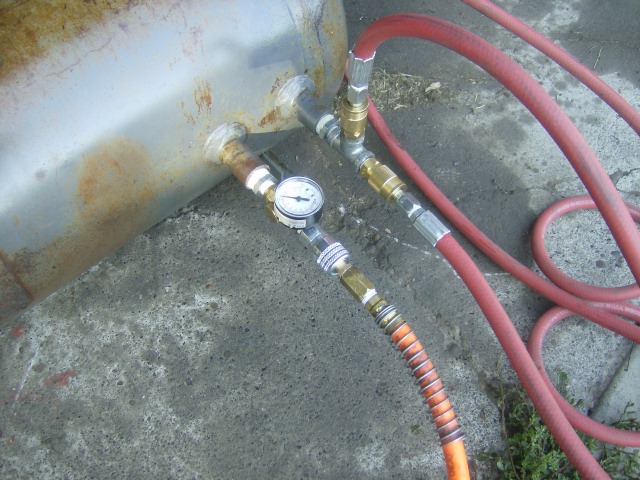

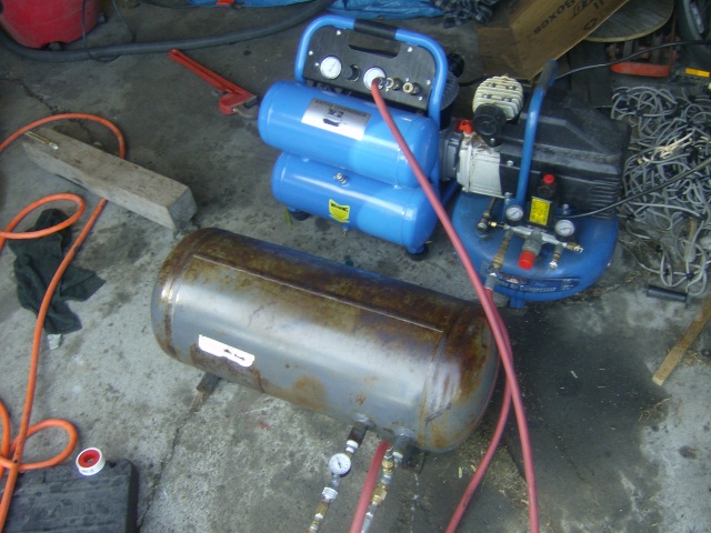

I cut the fittings off the refrigeration tank with my sawzall leaving about a 3 inch stub on each one. You'd be surprised how hard it is to find someone who can tap female threads in a pipe. Everyone can put the male threads on, but no one seems to have the tap for the female pipe threads.
I looked up an old friend of the family who has a plumbing shop and he helped me get the accessory tank fittings threaded. I bought the necessary pipe fittings from him and he didn't charge me a dime to tap the threads. I also bought a ball valve to replace the drain valve on the opposite side of the tank from the other fittings. See the first picture. The total bill came to $17 and change. That gives me a 10+ gallon air tank good to 400 PSI for under $25.
The fittings and hoses I needed to get the two compressors and the tank plumbed together were not so cheap. I could have bought everything I needed from Harbor Freight for about $20, but because of my impatience I went to the local hardware store and bought the quick connects and had them make me the short hoses. Total bill for these was almost $60. I got three female I/U type quick connects, four male, a five foot hose, and a ten foot hose. See the second picture. The last picture is a close up of the connections.
The two hoses have a male QC on both ends to allow me to go from the QC on either compressor to the Tee'd inlet on the tank. I already had the little regulator that is on the outlet.
The guy at the plumbing shop warned me that there was still some oil left in the tank. I dumped as much as I could out of the drain valve opening before I plumbed the valve in. Flash forward to when I am filling the tank for the first time. I plugged in the first compressor and started it up. Things were moving along nicely, so I went to plug in the second compressor. As luck would have it I left the QC that is straight up to connect to while the tank was under pressure. I pushed the hose connector into the tank connector and before I could get everything hooked up properly, I got a face full of oil out of the tank.
Boring is not something I complain about in my life.
