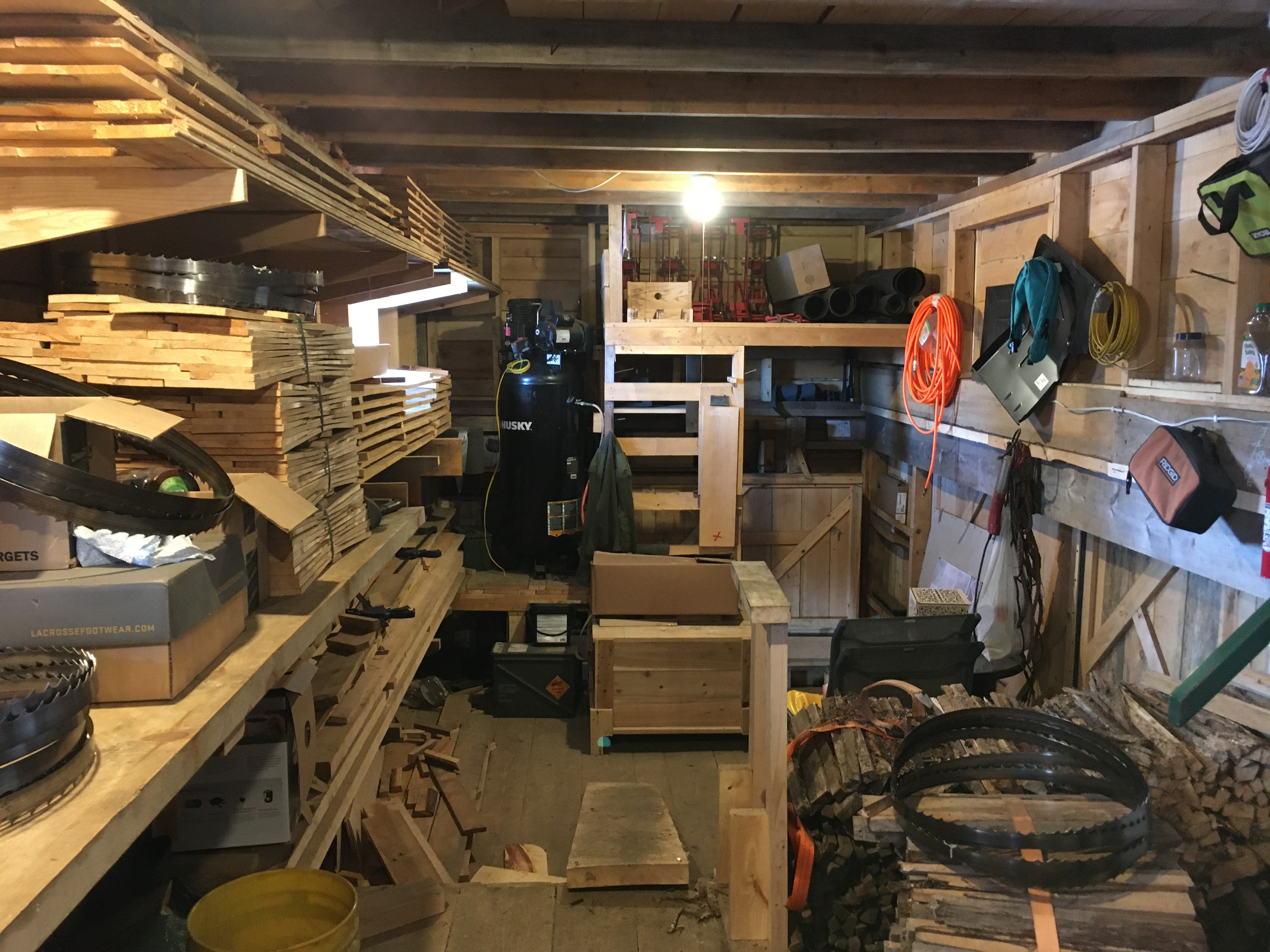

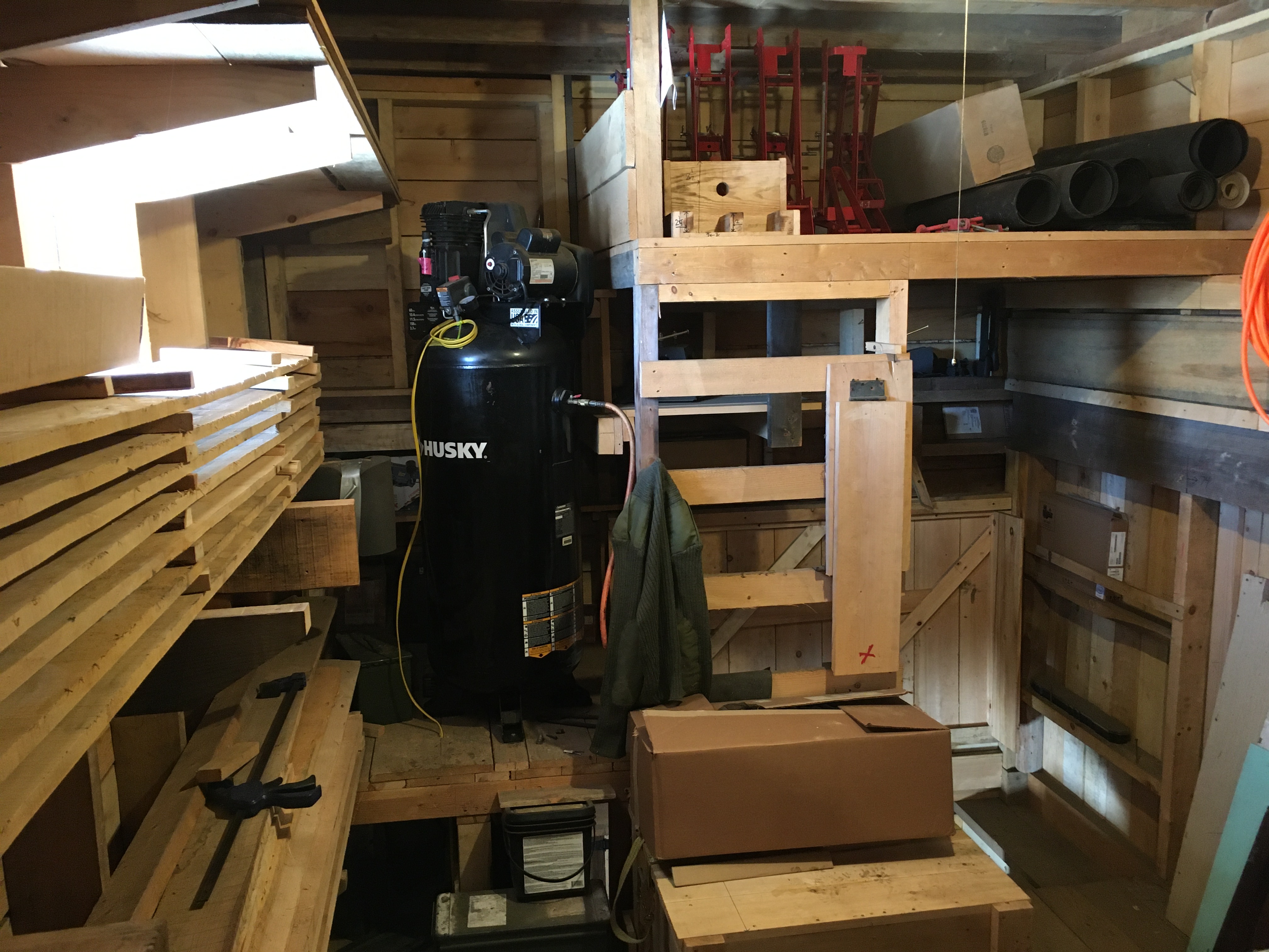

My compressor that came with a dryer doesn't dry the air going into the receiver, but only going out. Kind of suggests that moisure going into receiver isn't as big an issue as moisture going out to your tools.
The guy who spoke of making a cooler, or coil, before going into the tank. Thought about that. So where does the water go? Still goes into the tank.

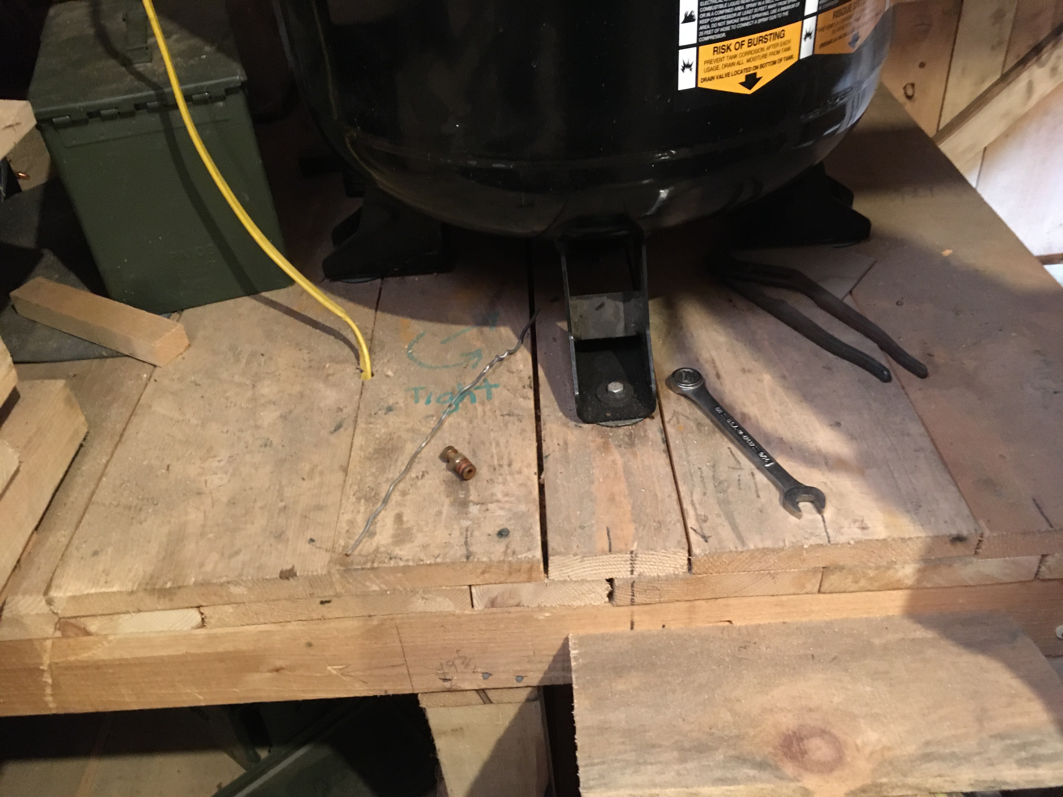

As I took this picture, I noticed the DRAIN DAILY sticker and tried to do that. As often happens with me, the valve won't work. Plugged up!
Compressor lives in a small second story, very tight, heated room with two tiny windows. Would be UGLY if it ruptured.
/ Air Compressor WARNING! #83
All this compressor talk made me go check mine, haven't drained the tank since last July and bout a quart of water came out. So checked mine today, first drained the air, then loosen petcock up and I was shocked, not one drop of water came out, thought it might be plugged I took out the whole petcock then ran a piece of wire up through the hole, still no water came out.
Its usually running about couple hours a week, I dont get it there should've been least a teaspoon full come out. In summer I've seen water come out of a cheap HF water separator but this time no water came out of that either, maybe only get water in summer time...
