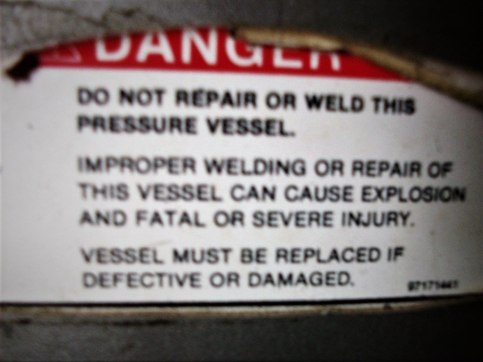

I only skimmed the comments here, but did anyone notice that it looked like the drain was booger welded in? Not saying that's 100% what caused the failure, but the damage that heating the metal can cause, it could easily contribute.
DON'T WELD ON PRESSURE VESSELS.
There was a fairly involved thread over on Welding Web where a Youngster was intent on repairing an old pin hole rusted compressor tank.
He did weld on it and eventually water pressure test it- but still a Really REALLY bad idea.
Who wants a time Bomb in their shop.
If a tank is to be welded on it should be inspected, and then only welded by an ASME Certified welder and then hydro tested.
