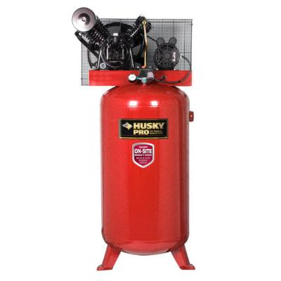

Hey Tractor Friends,
I am looking for a good compressor in the 1K range single stage to run impact and sanders. Looking for a 220 volt stand up. Any and all answers would be appreciated.

i got a husky from home depot a couple ys ago. 489$ 60g upright.. single stage.
has done great for me.
I paint tractors. use up to 1" air tools ( for 3/4 and 1" air tools use the large air outlet and large ID hose )..
looking at the tah on the motor/compressor.. it says campbel hausfeld
hard to beat 60gal of air at that price.

I would say dont buy one with a motor that turns at 3250 RPM. they put up lots of air because of the speed where a good volume compressor with a 1740 rpm will last forever & not fly apart because of the speed. ( my opinion )

I did look at a CH #TQ3104 5hp 80gall for 999.00 but I'm not sure I need that much compressor.

I also have a Husky compressor from Home Depot but I have the 80 gallon one. I use it for all my air tools and tire machine. Bought it a few years ago on sale for about $800. It also has a built in regulator with 2 ports the you can cut the pressure down on and yet maintain full pressure off the main line. It's made by Campbell Hausfeld (I think that's how it's spelled). I have it wired for 220V and pressure set for about 150 PSI. I just looked at HD site and they have a whole bunch of air compressors online with free shipping to you home. They have several units under 1k.
Husky 80-Gal. 5 HP 2 Stage Air Compressor-HS5181 at The Home Depot

Quincy, Devair etc. are true slow speed, industrial compressors. Likely over your budget. The Devair HDi's (likely my next compressor) are approx $3k.
At $1000, your can get "slow" speed if you carefully shop around.
For size, You always "need that much compressor. " Sanders eat air. I have close to 20CFM @90PSI and wish I had 2x that when sanding and sand blasting.
