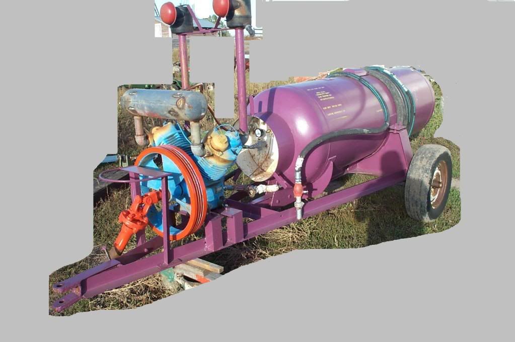

fwiw - I hooked up with a fiend of mine that was working in AT&T facilities. They were doing some hvac work there & part of the overall project was replacing the air compressors on the job. They had several 5 hp 3 ph units that they just scrapped because of their age (maybe 30-35 years old). It is my understanding that they cycle these out of all their facilities periodically. I managed to snag one of them. I replaced the 5 hp 3 ph motor with a 3 hp single phase and wired up my own low voltage controls. I have air piped to the garage now and the unit in my basement workshop. My only outlay was for the 3 hp motor. Everything else I had or scrounged. They are built like tanks (it is AT&T after all). It might pay to inquire at any local AT&T. . .
The unit:
and my low voltage control with monitoring light:
The unit:
I have a kelloge compressor almost like the one in the picture model 331 and it is getting water in the oil . When I bought the compressor from a friend i had to put a new head gasket on the compressor . There is two small tubes running to the head was wondering what these tubes do . I made the gasket my self and didnt know if I did something wrong . The oil looks like milk . I know this isnt good. Please help. Thanks, Larry
