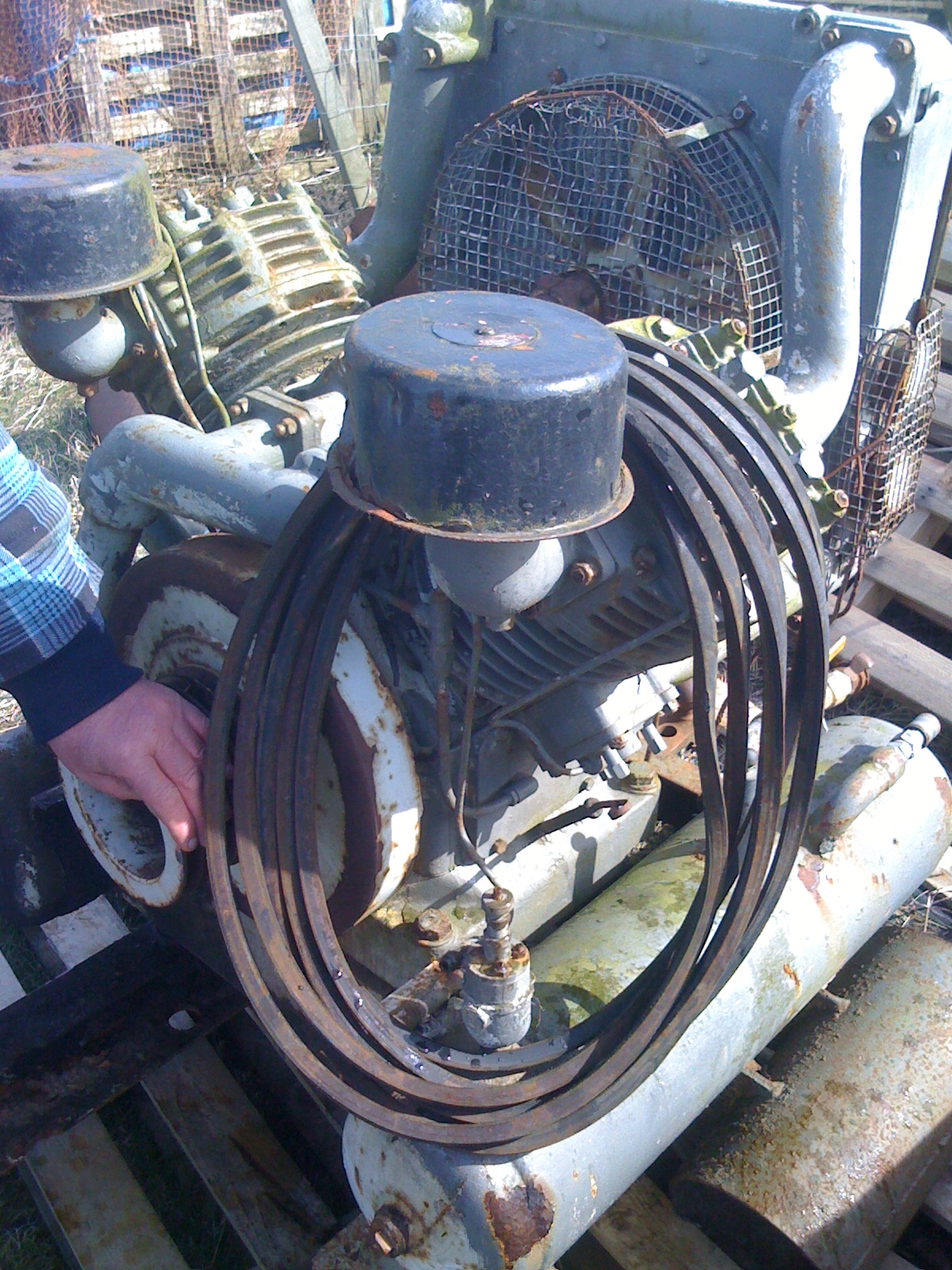

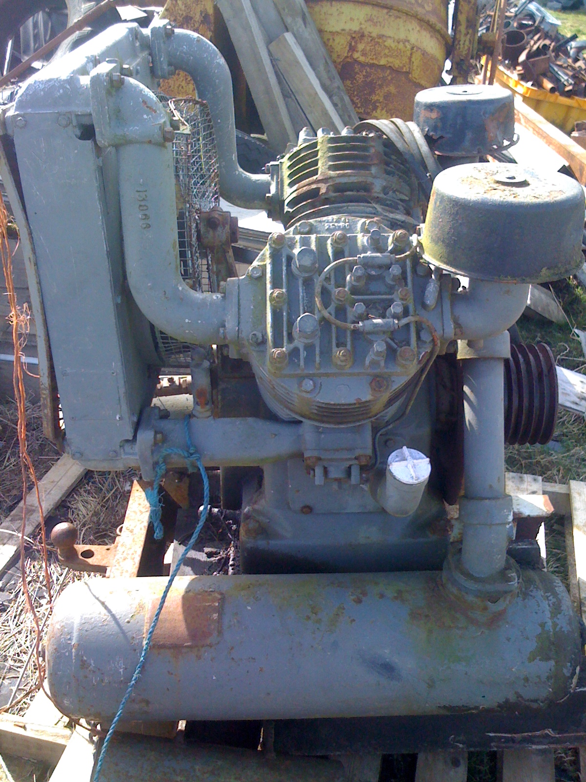

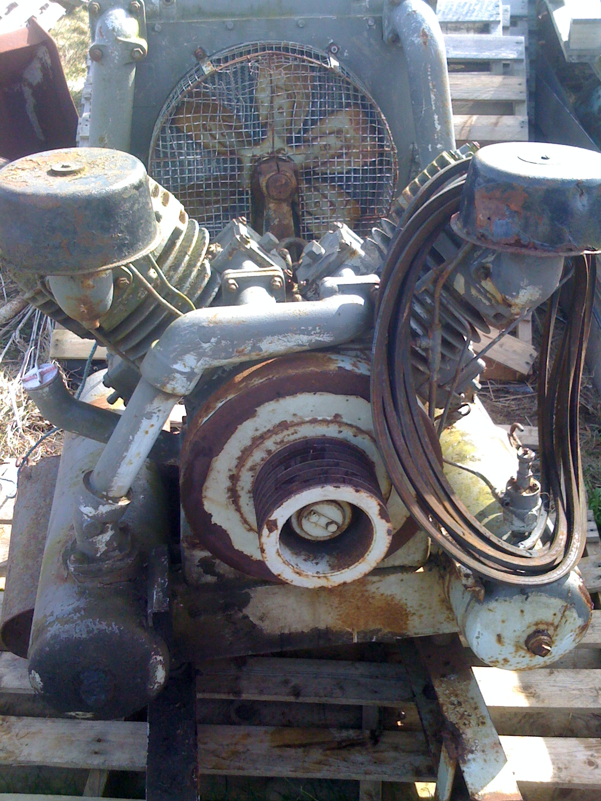

Ive just bought an air compressor,it was cut off a tractor,what type i dont know,its a monster of a V shaped twin cylinder pump,with oil cooling rad and fan,driven by the PTO ,via an unknown type of pulley( it didnt come with the pump), and then onto the pump pulley with grooves for 3 or 4 V belts.,its has two long tanks either side,underslung and two outlets,one with a crows foot type connector and another large push fit airline connector,it was fitted on a tractor which was used for road maintenance,for these air / jack hammers they used,so its putting out a fair amount of psi.It still has the original chassis attached where it was cut off using a cutting torch,channel sections.Ive searched the web and all i can find are small pto attachments,I would like some info on this type of machine,maybe someone will know what it is and the revs/pm i need to set it up,im reluctant to drive it off my pto ,.i have a feeling it will need high revs for long periods while im working with it.So Im thinking a stand alone engine will be more suitable.(I will post pics later,sorry I know its useless at the moment without pictures of the actual pump...)

Ive found a tag on it that had been over painted, careful rubbing down and alittle paint stripper came up with the make and model..,its made by Bristol Pneumatics Ltd,England.With 1400RPM and 160cfm.A quick company check shows they disolved the firm in 2001..so much for a shop manual then,,any information would be helpful.Its a 6 V groove pulley(not a 4 as i said earlier),seen with hand beside it ,gives a scale of size,its quite large pump.If I could gear it with a PTO pulley so my tractor (MF 135)could run it without racing the engine Id be happy to use it that way,save me finding an engine to use on it. ladarear121 1644331695.jpg ladarear121 1644331694.jpg ladarear121 1644331696.jpg

Ive found a tag on it that had been over painted, careful rubbing down and alittle paint stripper came up with the make and model..,its made by Bristol Pneumatics Ltd,England.With 1400RPM and 160cfm.A quick company check shows they disolved the firm in 2001..so much for a shop manual then,,any information would be helpful.Its a 6 V groove pulley(not a 4 as i said earlier),seen with hand beside it ,gives a scale of size,its quite large pump.If I could gear it with a PTO pulley so my tractor (MF 135)could run it without racing the engine Id be happy to use it that way,save me finding an engine to use on it.View attachment 419306 View attachment 419307 View attachment 419308
How much air delivery do you need? What is your intended use for it? Depending on your needs you might be able to turn it much slower than the max 1400 rpm and get plenty of volume.
/ air compressors
I need 110cfm and around 100psi for my blast pot and air supply to my helmet,my old hydrovane /compair towable compressor struggled at 90cfm to run my pot alone,this one is more than capable.just dont fancy having my old tractor sitting for long periods at high revs.
/ air compressors #11
Don't think your MF 135 has enough power to run the compressor at 110cfm output. You need either an electric 30 hp or a gas engine about 50 to 60 hp to do this. For full output @ 160 cfm at 100 psi you would need a 40 hp electric or 80 hp gas engine, this would allow the motors to run constant without over heating.
