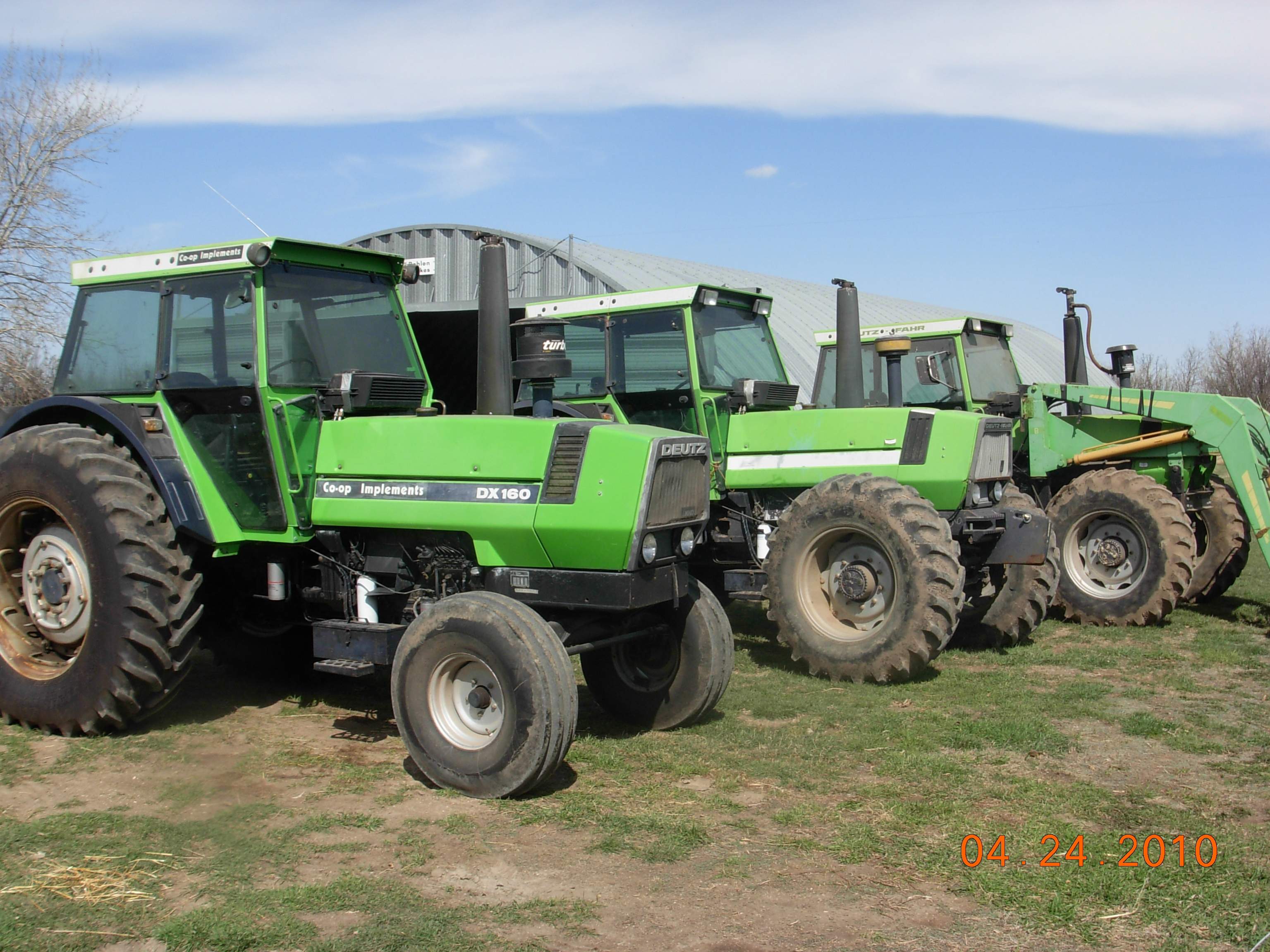

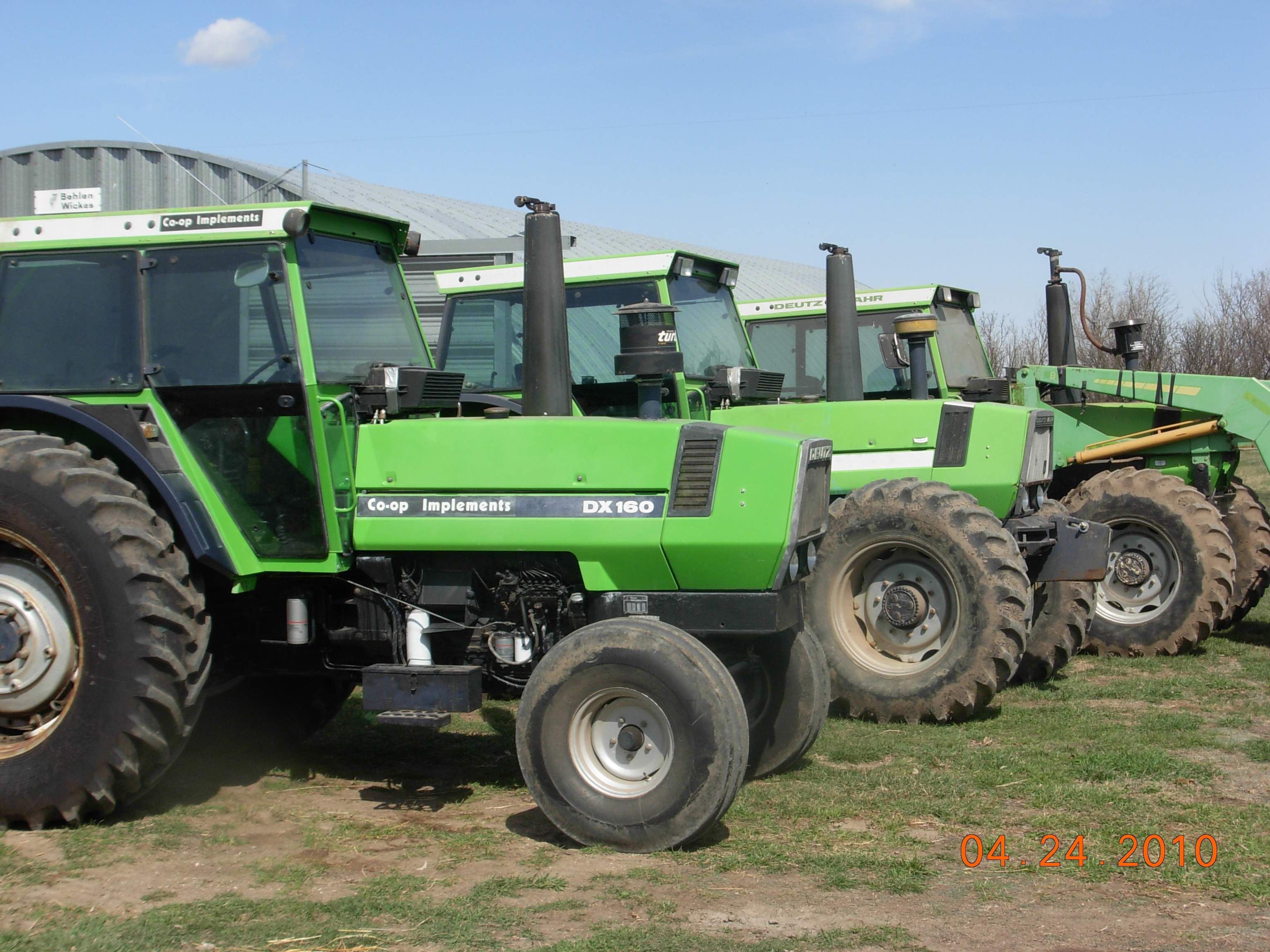

We have had great luck with our air cooled tractors.. Lots of power, worked them hard and had no problems. We have five tractors with a total of 43000 hours between them.. Thats right 43000 hours and never touched a motor

That sure is impressive.:thumbsup:

Might be a Deutz F6L913 in the DX160. Looks like a 6cyl and the diaphragm on the back of the fuel pump was something I believe the turbo model had. Also looks like the oil cooler right behind that.
Depending on the year model that is, not sure if the F6L913 is still made due to emmissions.

913 air cooled is now sold as 914 series in certain markets. The stroke (roughly 13 cm) has remained the same even though the last two numbers of the type have changed: They already have a 1013 series so they had to move away from the traditional numbering system.
Did the DX160 have the 913 or the 514 engine ? The DX230 had a masive 413 or 514 for sure

The dx160 have a Bf6913 motor with turbo
