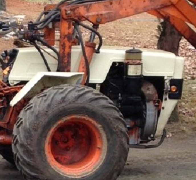

I HAVE to use a foam pre-filter on my Pasquali 993 to keep the dry snow from getting sucked into the air-filter neck & freezing into a lump. I just cut a piece of air filter foam (happened to be pink, not my personal choice), into a donut shape & slipped it over the neck covering the intake holes. Works great during the winter, & I use another in the summer saturated in air filter oil, to keep 90% of the large dirt particles out of my oil-bath air filter unit.
