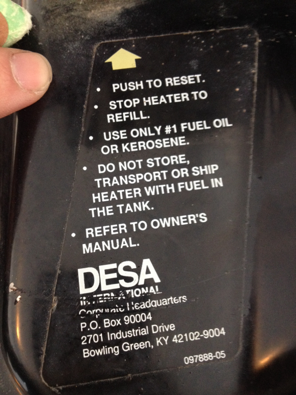

Just re-read my instructions "Diesel or number one fuel oil only"

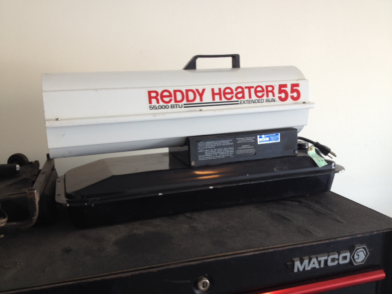

You guys talked me into it!! I just bought a 55k btu for 85$. Not bad!! Check it out! Can run kerosene, fuel oil no 1 (diesel #1 is close), and jet fuel! Very happy. New a similar model is 180$ or more. I was hoping to get one that runs on diesel but that's ok. I own a diesel Massey ferguson so I figured I could have 5 gallons of diesel fuel at any time and run in both the tractor and the salamander. It's not for the expense I wanted to run diesel but for the ability to have only one fuel. Now I need three types, gasoline, diesel and kerosene.
Can anyone tell me more about this heater please?

I have the same heater. Not that it works! lol But I was surprised to find out you can burn Diesel. I bought expensive Kerosene all these years for nothing. I was just confused because I didn't know #1 fuel oil IS Diesel and it says right on the unit. #1 Fuel oil or Kerosine ONLY!

I have the same heater. Not that it works! lol But I was surprised to find out you can burn Diesel. I bought expensive Kerosene all these years for nothing. I was just confused because I didn't know #1 fuel oil IS Diesel and it says right on the unit. #1 Fuel oil or Kerosine ONLY! Now don't go doing something STUPID like burning your shoelaces off!
LMAO thanks for the tip. Does yours ever make you sick because of the fumes ? I think some one put no 2 diesel or fuel oil in it. I am going to remove the fuel and replace with fresh from the pump kerosene
