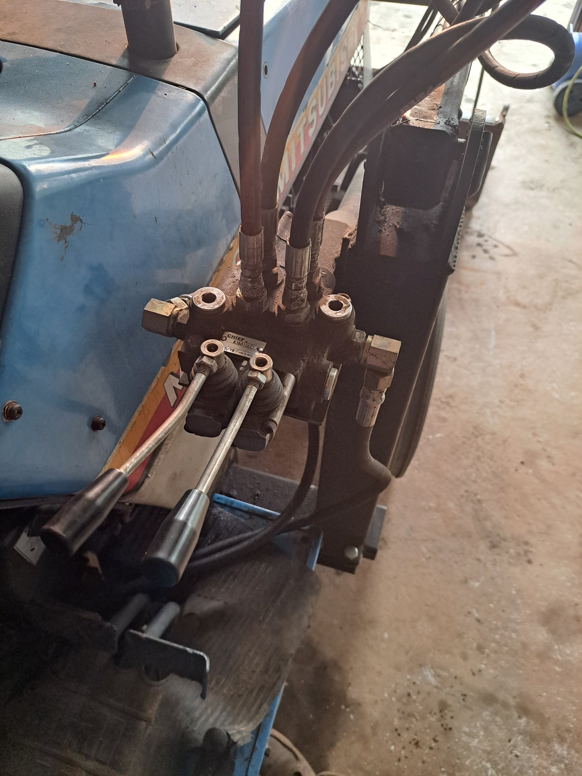

/ Air in backhoe?
Here's the valve body. Power comes in on the right. Which is the power beyond port?

/ Air in backhoe? #8
I can't tell enough from that photo. The pressure in port is USUALLY on the left, the same side as the relief valve. I don't see a relief valve in the photo. The power beyond sleeve should be on the opposite side, and will screw into one of the out ports, sometimes labeled N, but not always. Can depend on the make of the valve. As I see it now you have no operational power beyond right now. There should be three lines, not two, connecting the valve to the tractor hydraulics.
So what are you trying to accomplish, and how are you doing it? Show some photos of where on the tractor the lines on this valve are hooked up when the hydraulics (loader and three point) are working. Show us what you are trying to tie into this, and how are you doing that? Where are the lines you added, where do(did) they go?
Look at valve body closely it may have a "P" designation on one port for Power in and a "PB" designation for Power Beyond for out port, and possible a "T" port for tank (design dependent) ...
