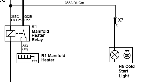

how do you know if it is working? the dash light doesn't come on (at least i think the 'glow plug' light should come on), but don't know if the bulb is just out.
does it make any noise when activated? doubt that there is any sensor to keep it from working if it the outside temp is warm.
thanks.
Dave

correct, but besides the light, there is no way to know if it is active? i've used some (non-deere) models w/ plugs and you can hear it click and such when in use, even if the light was out.
since my light doesn't come on, i'm just wondering if the bulb is out or the switch isn't working. if there was some other signal that the heater was working, it would save some digging (IE pulling the instrument panel or switch).
thanks again.
/ air intake heater #7
The tech manual for your tractor shows the light is connected directly to the key switch, so either the bulb or the switch has probably failed. The heater is connected through a relay downstream, but I don't know how loud the relay might be.

Your 855 works very similar to my 755, except yours has an intake air heater and mine uses glow plugs. Both use a temperature sensor to control operation and are activated by just turning the key to ON and waiting a few seconds before turning to START. The 4300 schematic shows it is a completely manual system with no sensors, and has to be activated by pushing in the key. I think you have a good idea to feel the heater, and in this case could be done by just pushing the key in while doing that. Cleaning the relay contacts is also good, but in this case there is less chance of that being the cause since the light is not working and does not go through the relay.
