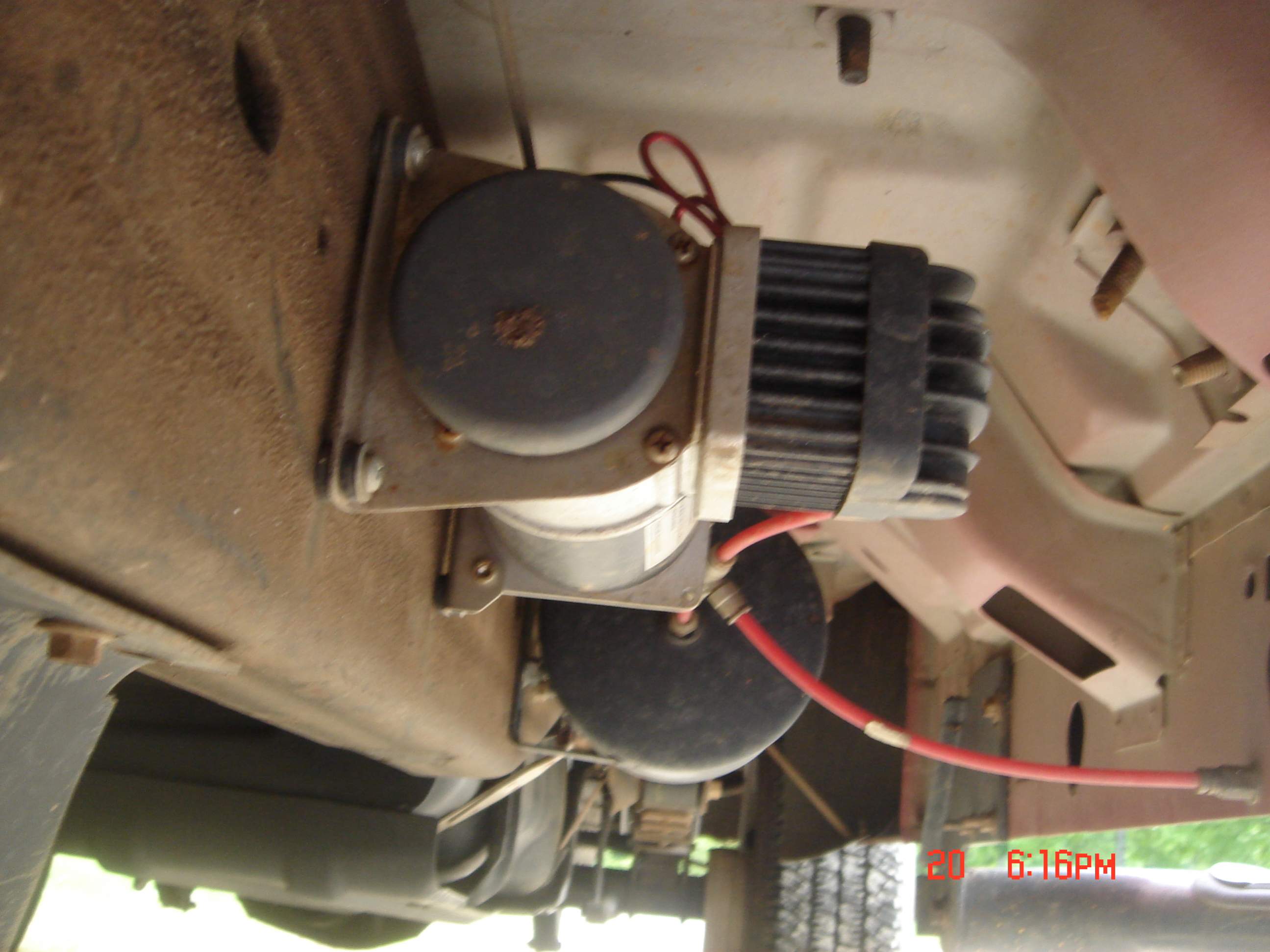

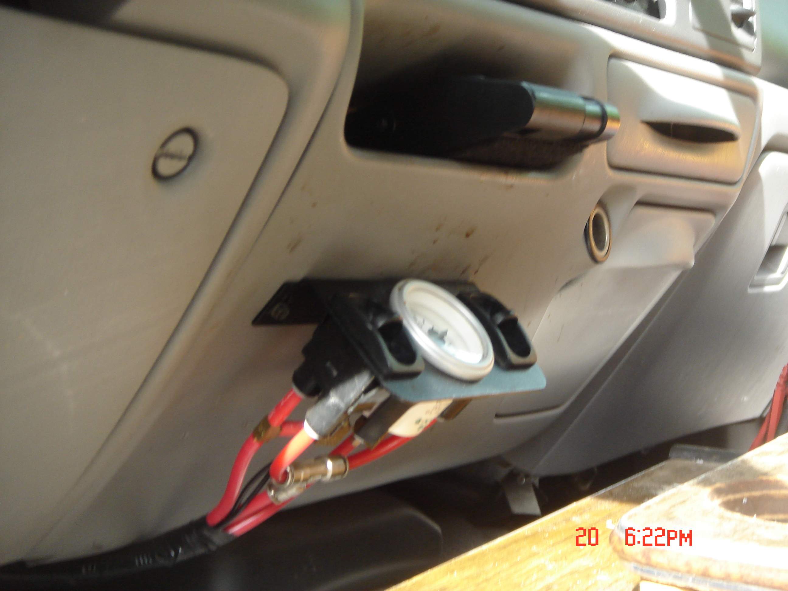

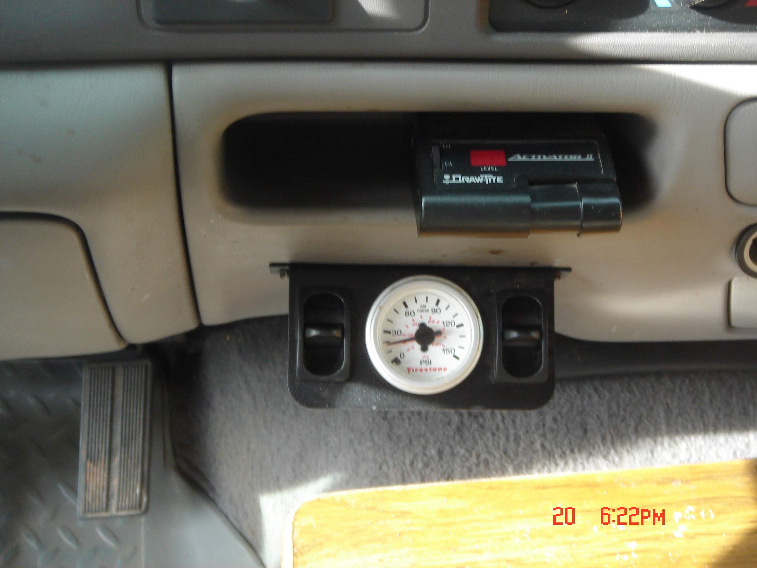

Cause I'm installing bags for towing reasons. That load is dead on the center. With all the gear in the back who knows what the side to side is but that 3500 doesn't care about that anyway. I'm wanting to level out the approx 2" sag I get from 1000-1400lb tongue load. Plus I probably have another 1000 in the cargo area.
   / Air Lift Air Leveling #15
pics
Dang..my truck is dirty.
