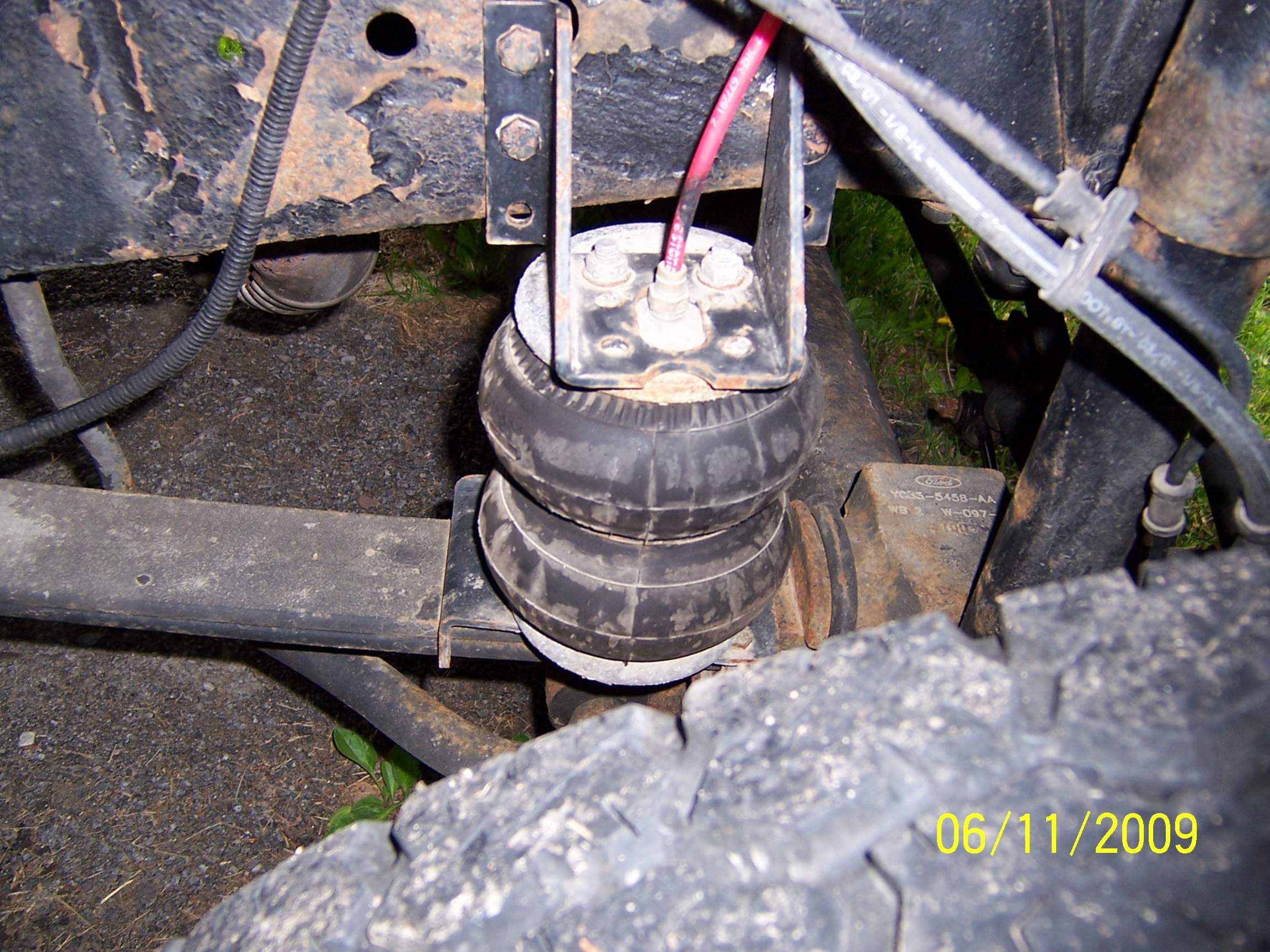

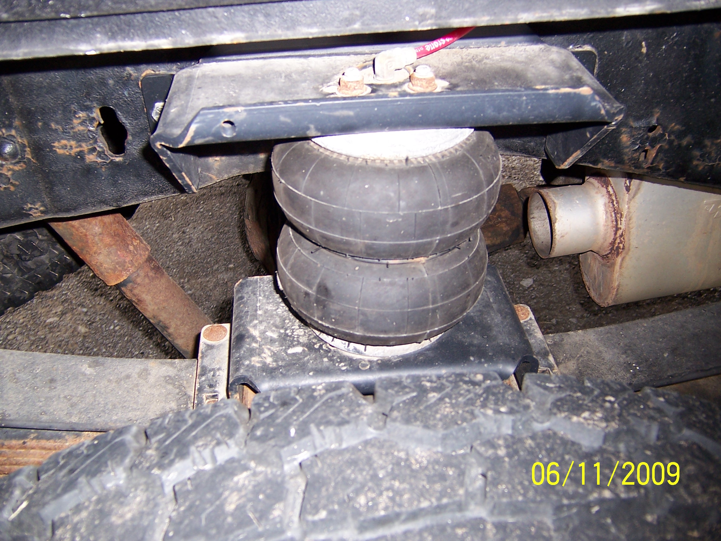

greatwhite i hope these come up. the first is the front they hook around the u bolt on my 01,second is the rear and they just use longer u bolts and then the gauge.it was kind of a pain to do. you have to split them side to side front and rear.one line from the tank to the guage then out to the front then teed them off left and right on one side,then do the same on the other on the rear at the bags. i thought it was a good place for the cb i don't want a trash bag hanging there.

Well Smith it looks like your in the rust belt as well. How long have the bags been on your truck? The rust thing had me concerned on where to mount the compressor. But it looks like it will fit under the hood away from the worst of the salt. I'm going to install them on the rear first and the the add the wireless air then the fronts. I hope I'm as impressed as all the threads I've read seem to indicate.

i put them on last september.yea i am right in the rust belt too,i plan on scraping them and the frame and shooting it this summer.i have my compressor mounted on the drivers side where the second battery would go if it were a diesel, but thinking about moving it so i can install a second battery.still have to run my aux ports so i can air up tires ans such, i am putting one in the front and one in the rear.
