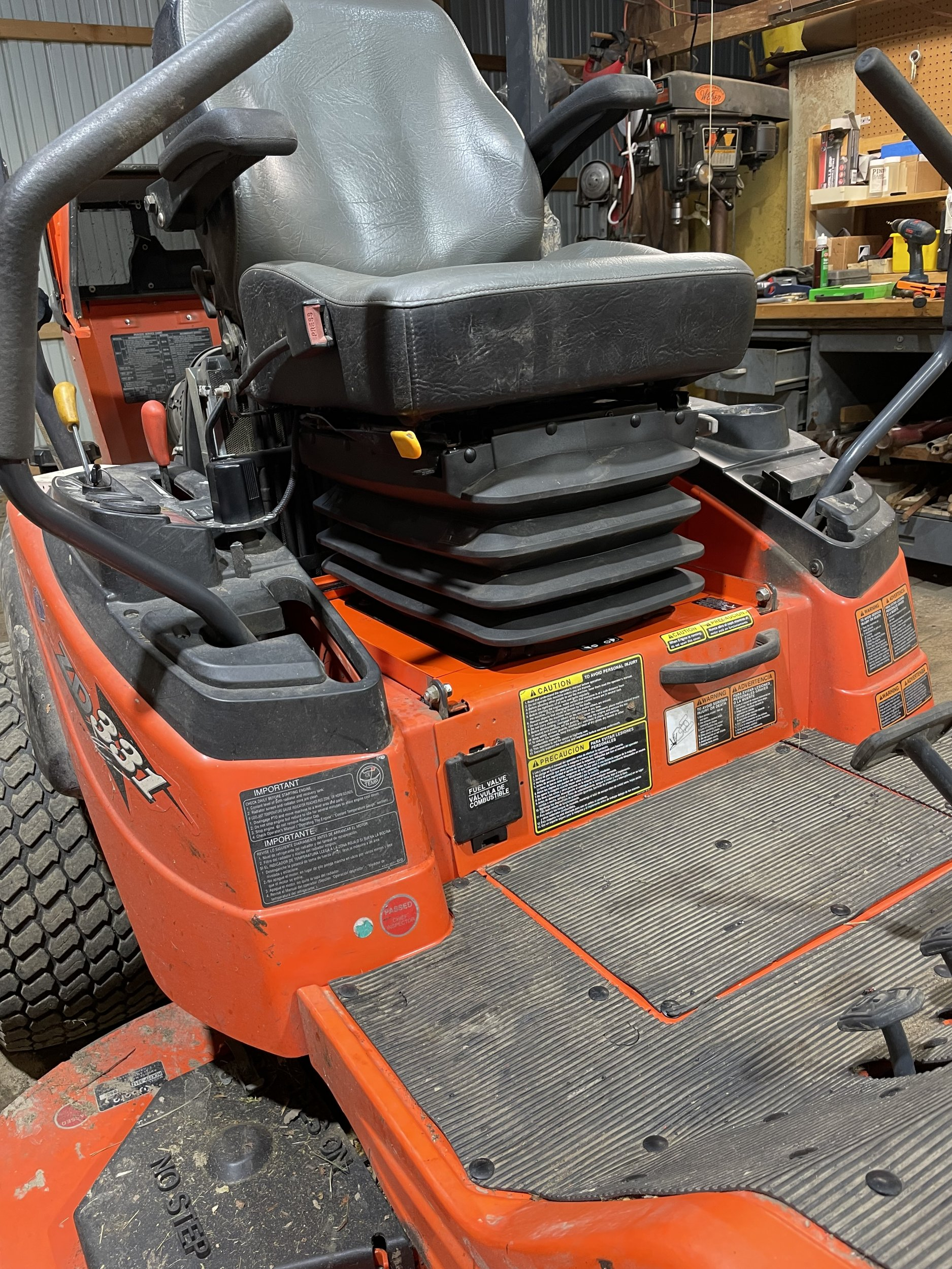

   / Air Seat Upgrade for my M59 TLB #23
Grammar seat on the ZD331

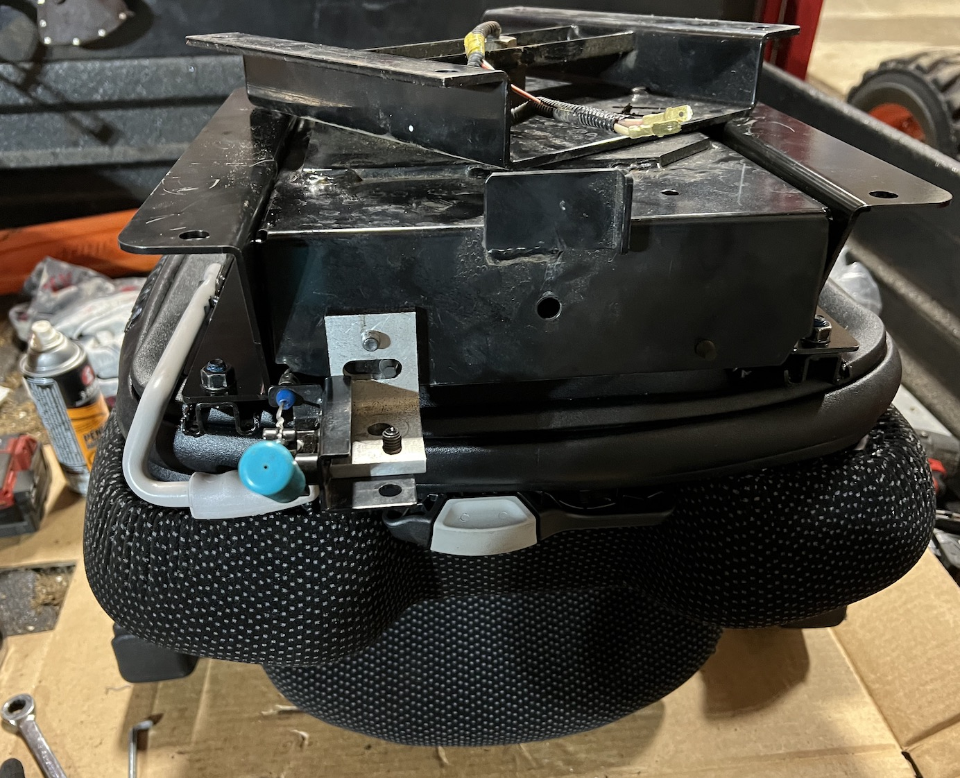

Just got my air ride seat was wondering if you have a few pic of hold you added you ome swivel the seat in my l4060

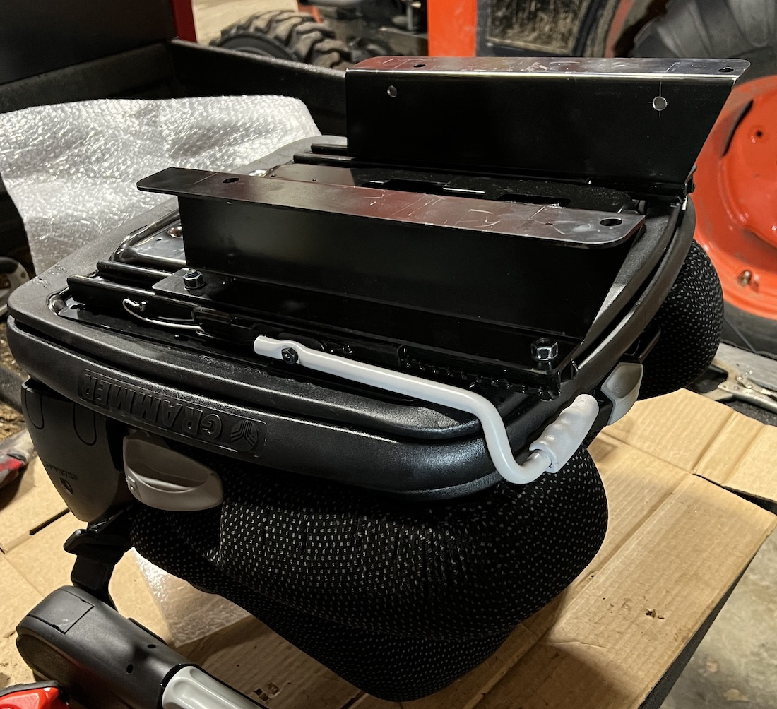

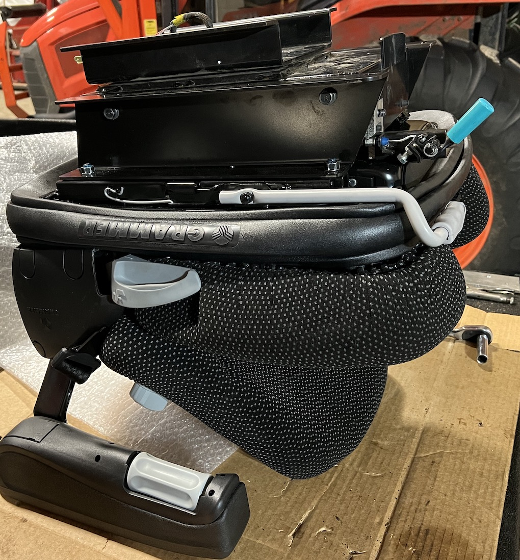

Hopefully these pics make sense.
My M59 OEM swivel base had linkages for the mechanical suspension mounted to the swivel. Four M8 bolts held the linkage on. I removed the 4 bolts to take off the mechanical suspension part from the swivel base.
First pic shows where I drilled 4 holes into the air ride seat base to mount to the M59 OEM swivel base using the existing M8 bolt locations.
Other two pics show the swivel inserted into the air ride seat base. I re-used the M8 bolts for mounting.
I don't know if I got lucky but it was a perfect fit, no shims or adjustment of either swivel or seat base. I had to add a bracket to mount the seat swivel lever - you can see the aluminum bracket I used.
I have more pics I can post if you have trouble figuring out what I did here.
The air ride seat is now about 2 inches higher than the mechanical seat which is perfect for me. I have more travel now front to back on the sliders, feels easier to get into the BH position.
