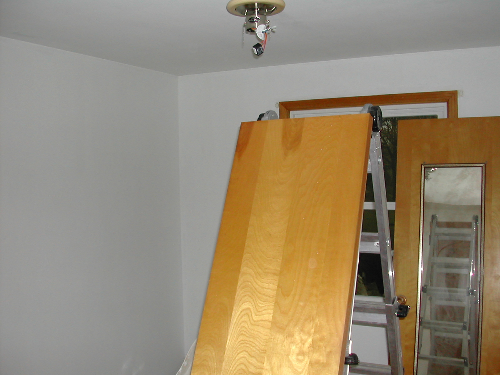

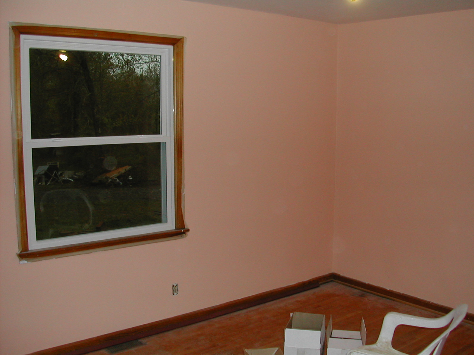

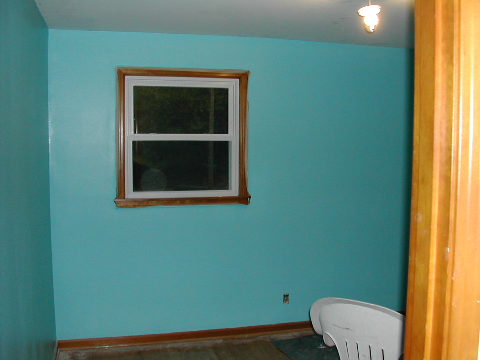

My bedroom is now painted, the ceiling fan needs to be bought, and the floors done, and that should be it for this room.
Dean's room is now painted, he bought his ceiling fan so it may get hung today, then his room will be complete short of floors.
Christina's room got the ceiling painted and the walls all primed, the ceiling fan got hung, but got wired incorrectly. Hopefully get that straight today.

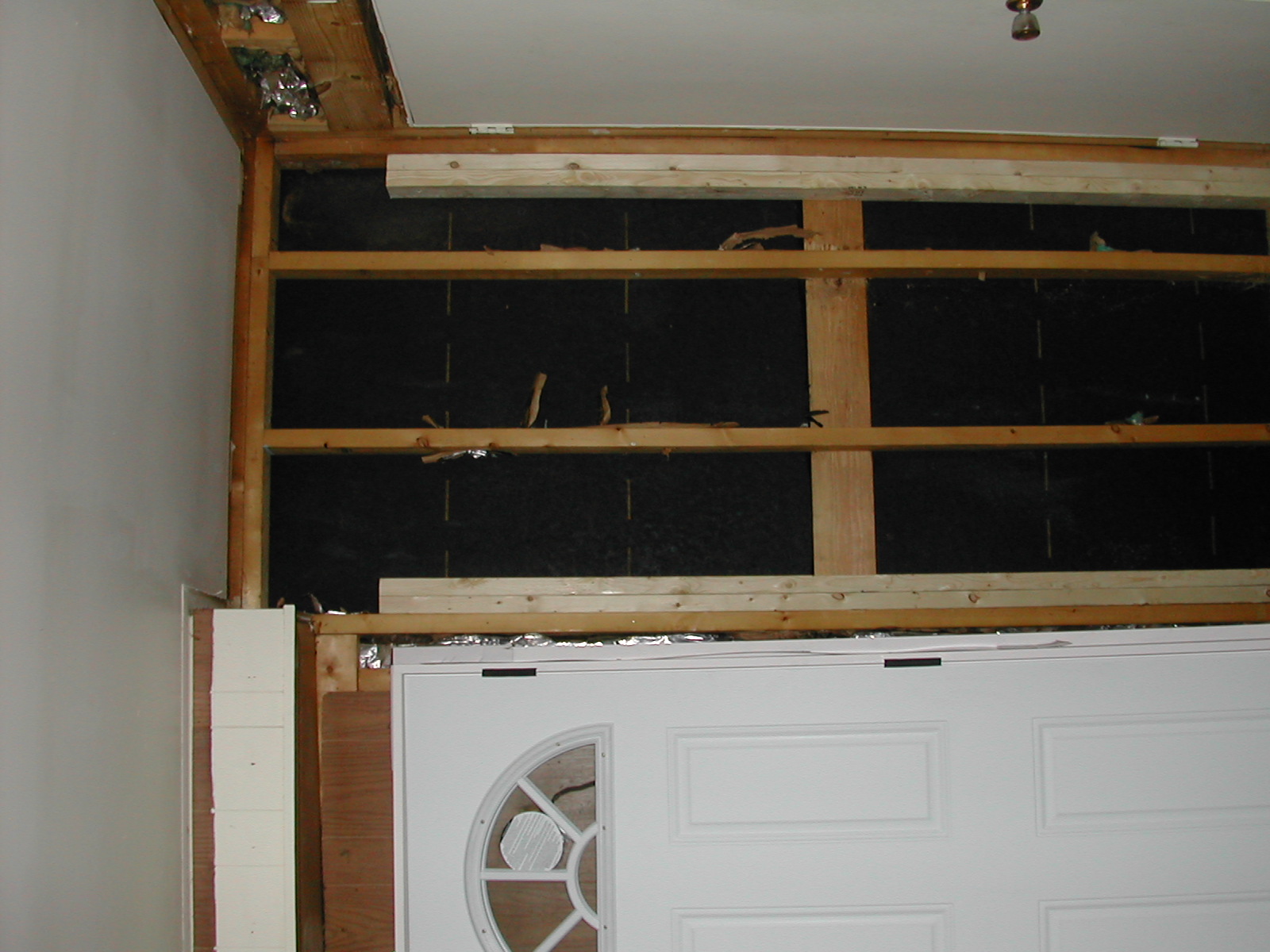

Started framing for the kitchen door entry to the outside.

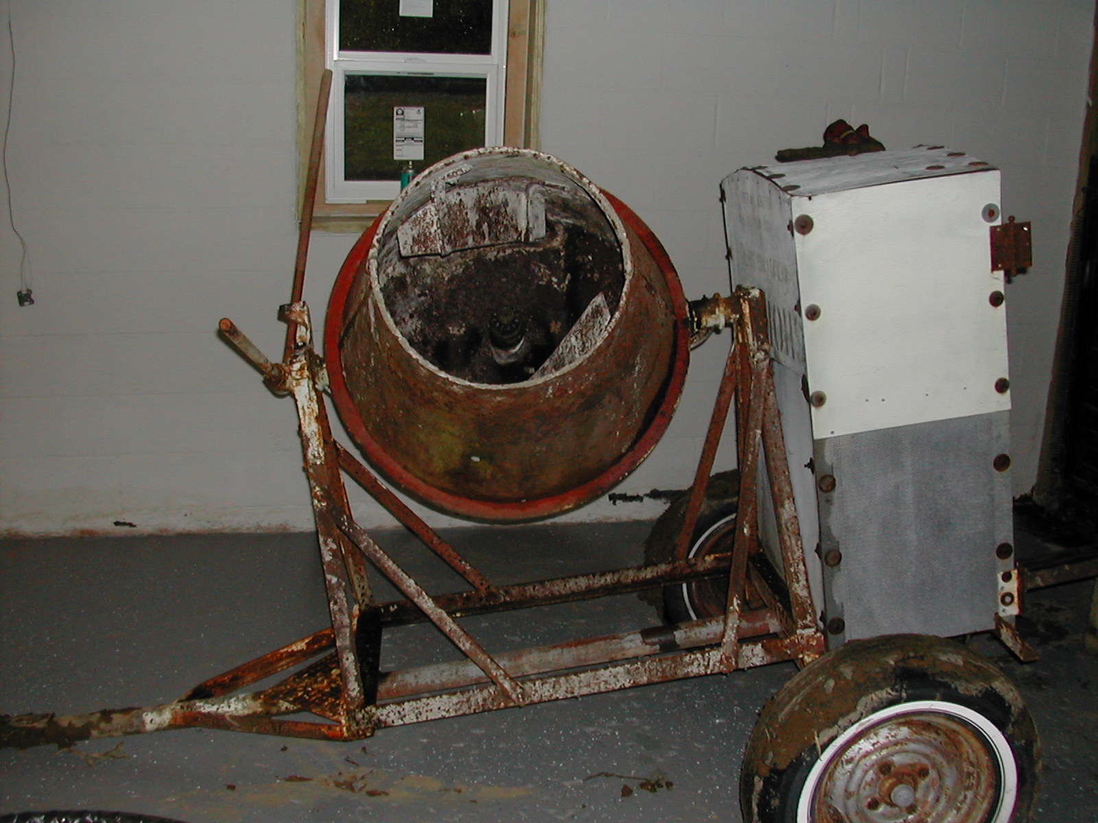

Georg got the big concrete mixer going.

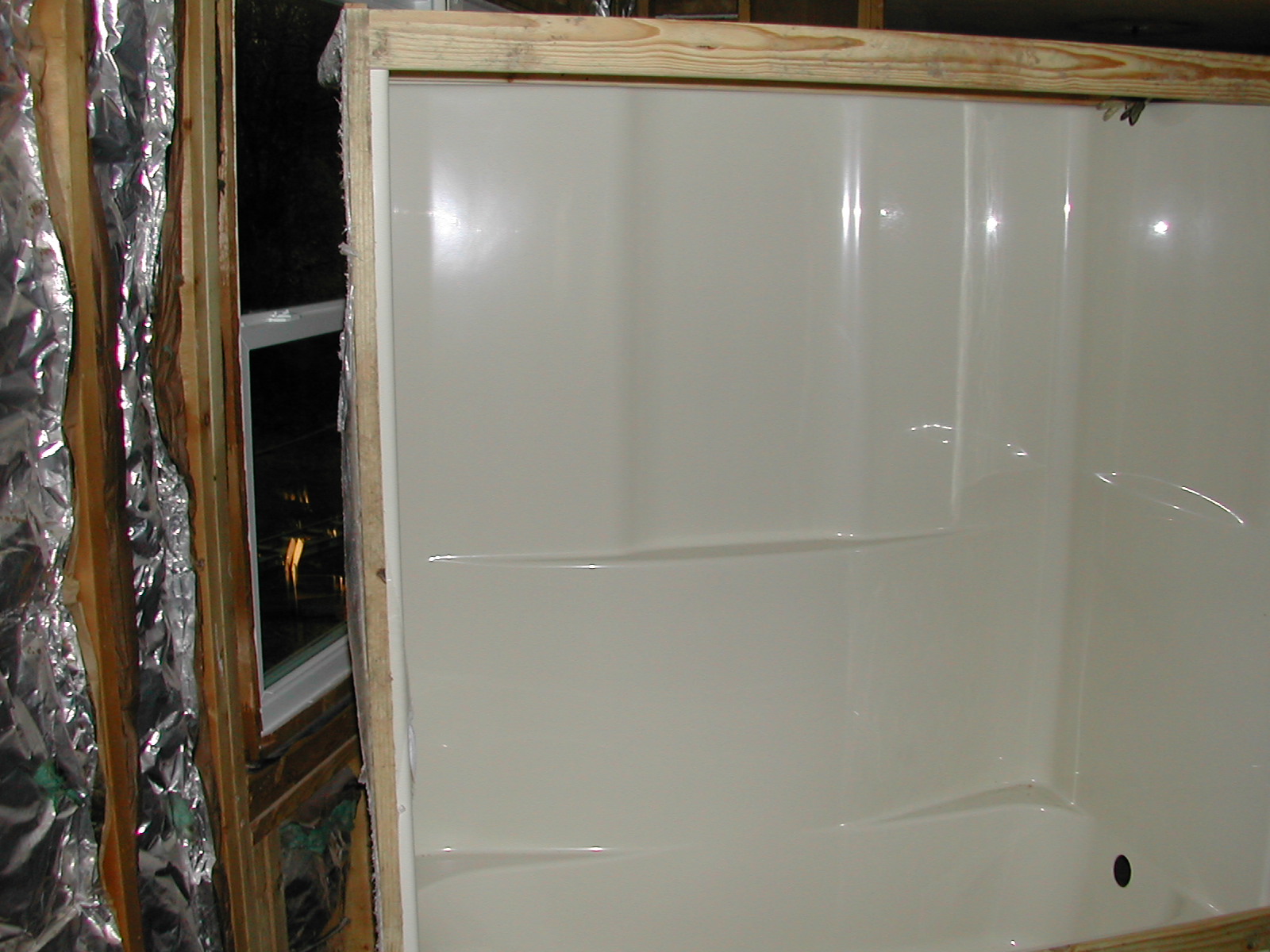

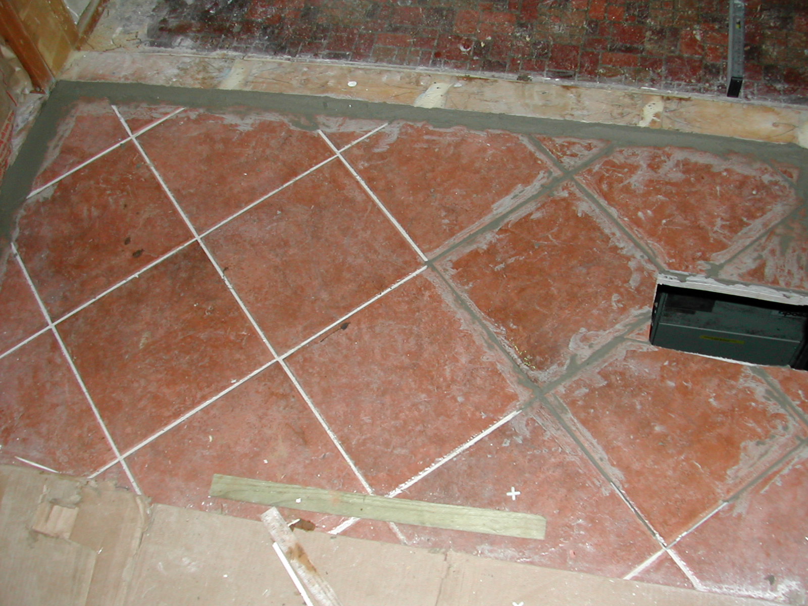

We removed the studs, to put the tub in place. Thought I could move two and pivot it in,,,, yeah right............. So, 6 studs later...........:D
Got the hole cut for the drain area under the tub.
Trying to understand the order for putting in the water parts for the tub. They are made to go in first, be hard mounted, then have the tub slid over them, or the wall built on top of them. Well, I cannot do that. Got to spend some more time studying on that one.... I did find it humourous that the instructions said it would take 85 minutes to install. Heck, I looked at the instructions and scratched my head for 85 minutes and I just dont think that was what they had in mind :confused:

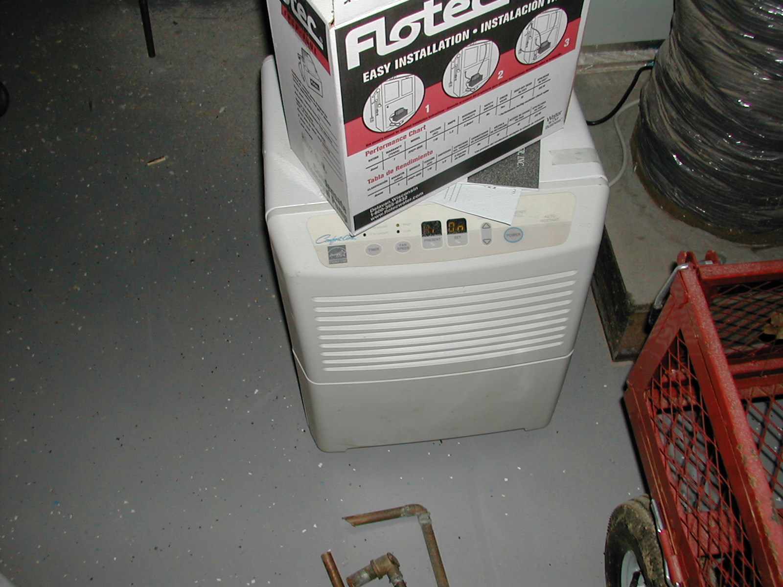

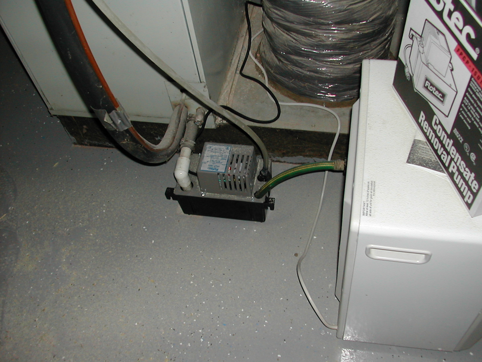

I put in another condensate pump. The one that was in the house I broke when servicing it...........:eek: The second one a Wayne, bought new from Lowes, the float would stick when the water went in slowly (like from my dehumidifier) and would not turn on till you shook it.....:mad: #3 another flotec, seems to be working right now... It is stuff like this that just kills me. I bought new, high quality stuff, and still had to jack with it, two trips too the store, 15 minutes on the phone with tech services (that told me I needed to clean the pump, yes, the brand new pump I just took out of the box.....) I cannot seem to just buy the piece, and put it in and be done. But probably more what it is, is that I do not notice it when it all goes smooth, becuase that is what I expect to happen.
Basement is still leaking water in from outside at the joint. Probably going to end up digging. :eek: But at least I got a hoe that will help me out :D

Some more pics, not sure how it will come out, but if you can see the dehumidifier, they kind of say it all when percent of humidity says
HI
It was pouring rain and the door was open, but a good test of the condensate pump...

So Sunday MikeB44 from here on TBN and his dad came up to give me a hand getting some stuff done on the house.
Folks like that make this such a nice place, and make this project work.
They were the Fan hanging crew I can tell you.
Course I must admit, I layed out a bit not feeling too peppy Sunday morning, and ran a bit late :( but I don't think they had to wait too long:)
So they started by rewiring and straightening out the fan that the hired help had installed....... it was the last thing I checked Sat evening, and it was wrong :( but mike got it wired correctly lickety split and going just fine.
We then noticed that the brace under the fan in Dean's room was holding the box down and crooked, so on closer inspection, realized there was problems with the blocking the hired help had put in :( So I got to drag my fat butt up into the attic and rework some ceiling fan braces. (NOT FUN) but needed to be done, on closer inspection of the others, I was sure not happy, but there was so much goofy stuff (bent nails, bent half installed screw's broken screws) in there that I felt they were "secure enough" and that I would do more damage fixing it, then it was worth.
So Mike and his dad smoothly moved through the fans as I corrected errors from the previous day, or worked other issues, I stared at my tub for a while and decided how to make my water valves work, I need to add some nailing studs in as well so that I have good places to attach too.
They did the fan in Christina's room, then moved to Dean's room, then to my room as I fixed the bracing in Dean's room, then back to Dean's room and finished in the kitchen. Man those guys knocked a big dent in the project and lent me a huge hand.

I have a question / problem for you knowledgable folks there.
I am adding in an exterior door in the kitchen, I figured I would leave the sill plate in place and go over top of it. There will be additional Hardwood flooring laid in the kitchen which will bring floor level about even (1/4" or so) with the sill plate, and I will be building the steps outside, so can make them any height I desire. Am I messing up by not removing that sill plate?
I have a picture in my mind finally of how to install the shower control that I like. Everything I read shows the shower control all mounted then the shower sliding into place over top of it, but the way my shower must come in, and how far the nose of the valve sticks forward will not allow that to happen.
What I am going to do is assemble it all on a board, or probably a grid of 2X4's and then pivot it into place from behind in the closet, after I have the tub in place.
I will not have tested all my connections, but it should be easy enough to take apart if need be and rework installed this way.
