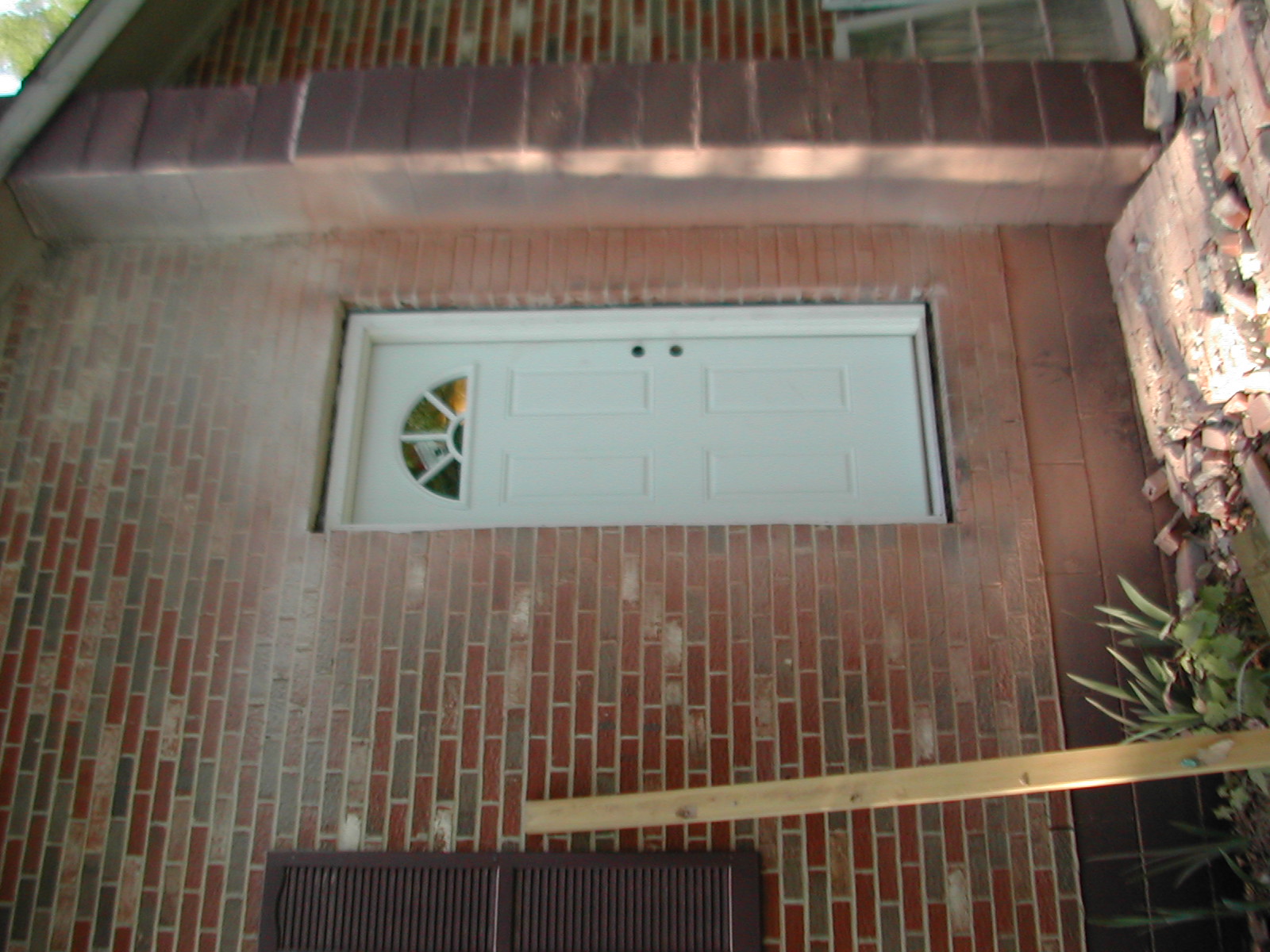

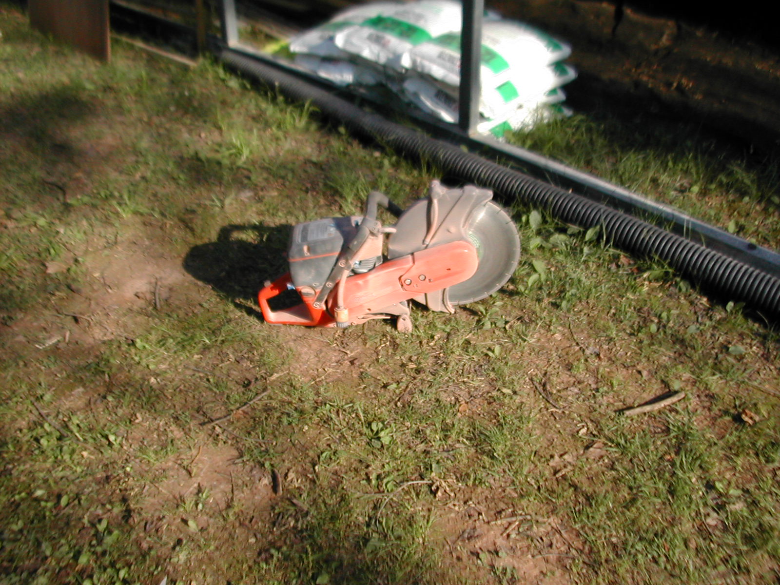

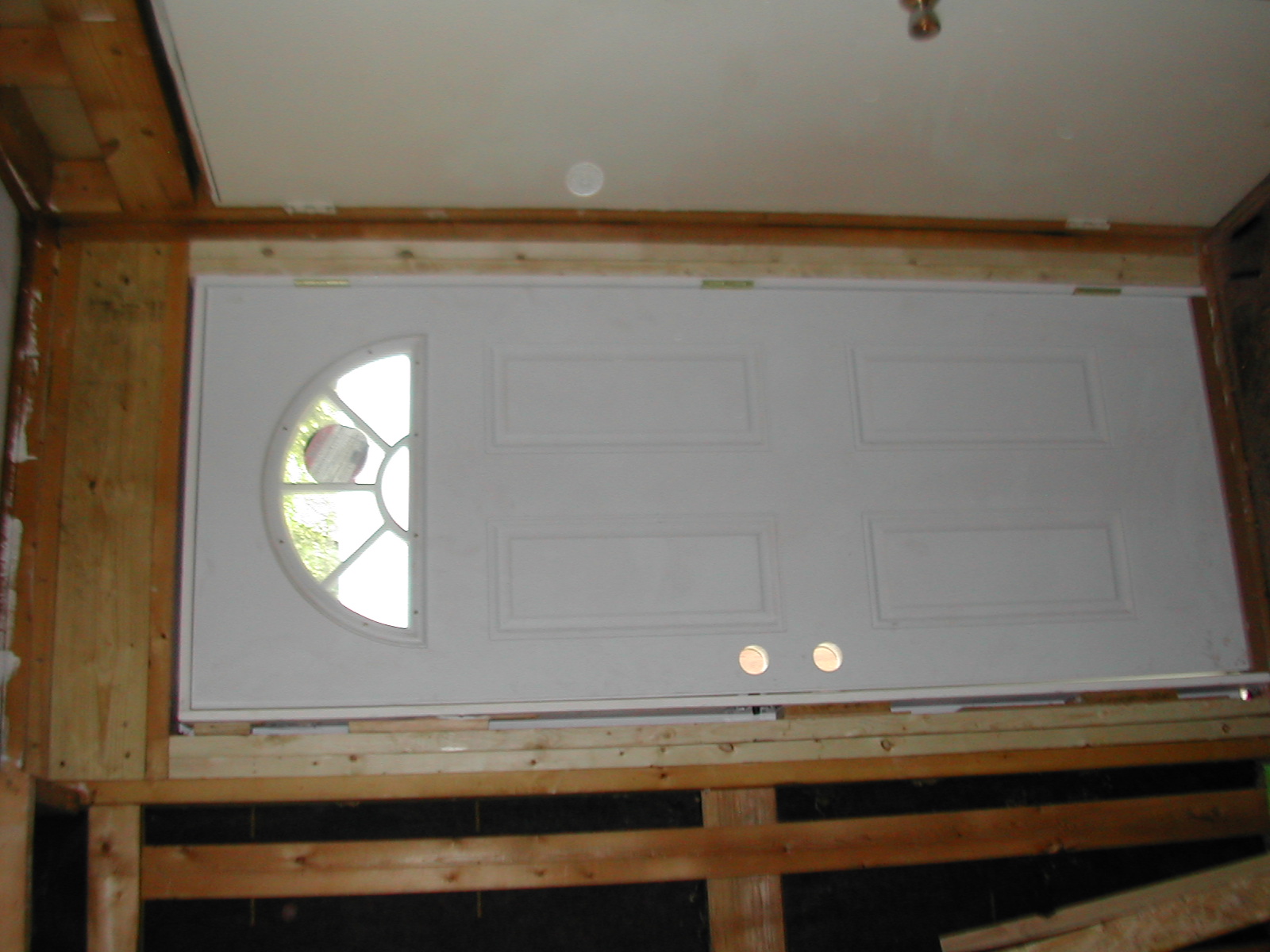

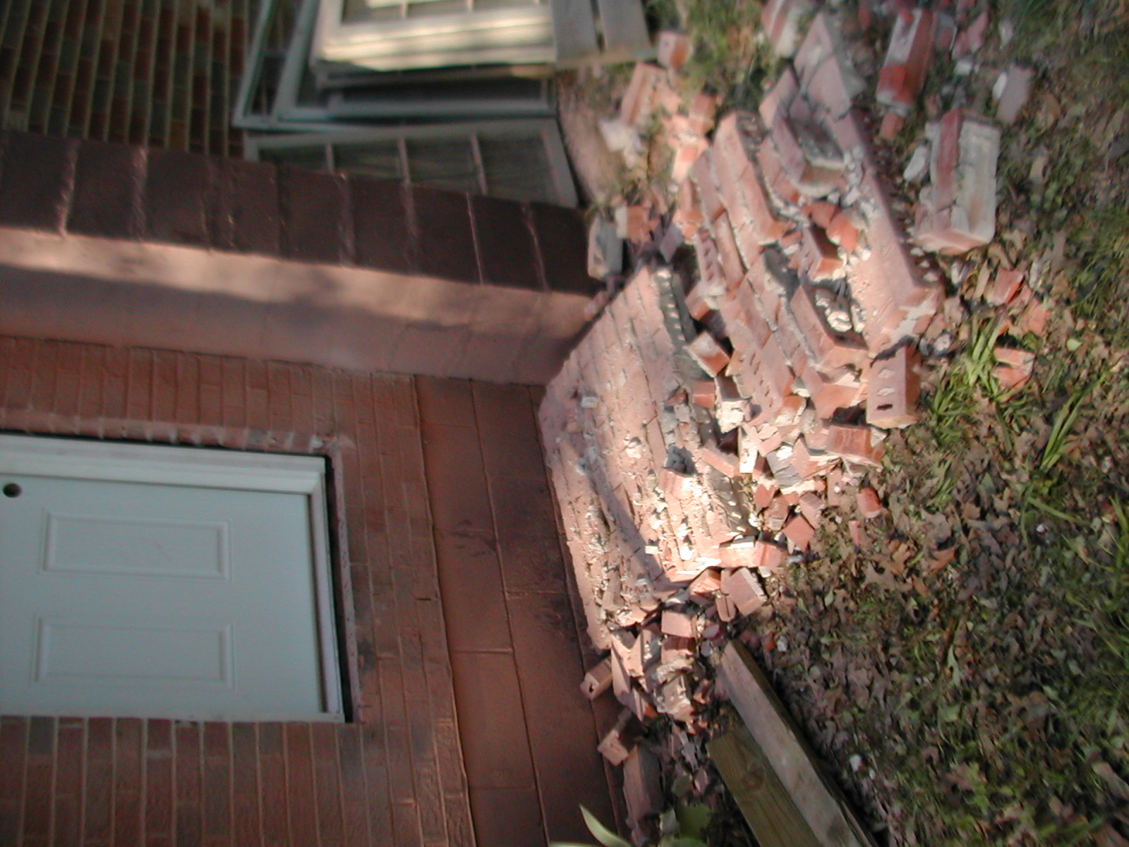

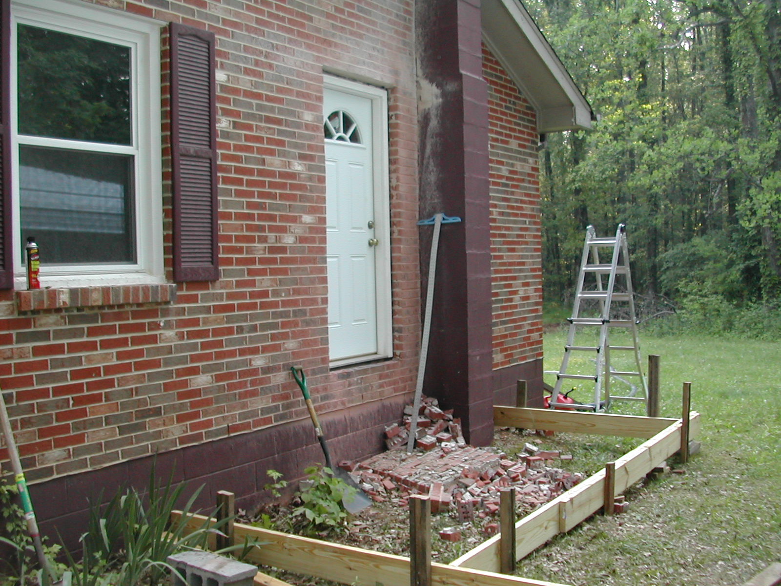

New door installed in the kitchen. Cutting a door sized hole in the brick with a 14" cutoff saw and diamond blade standing on top of a ladder holding said saw sideways with it running full tilt, does not add up to FUN in my book..... :)

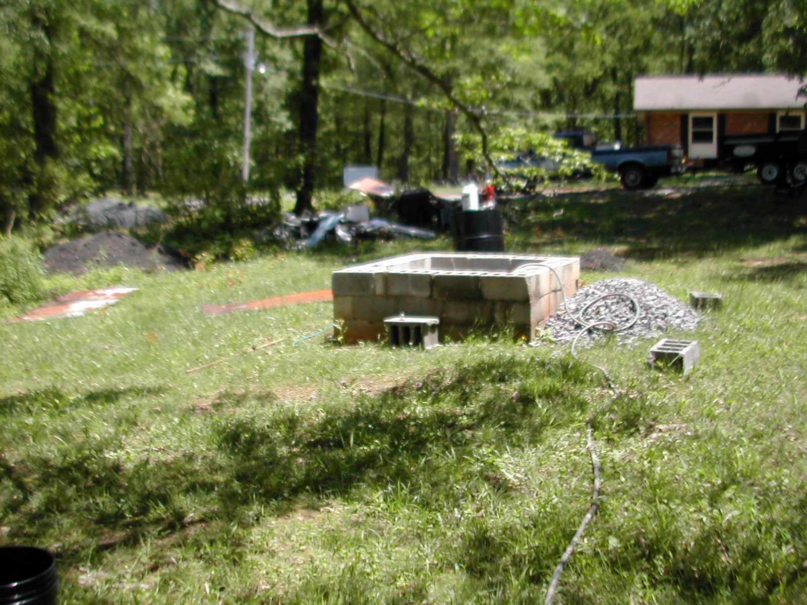

Hanni, one of Hanna's freinds was over, and say's, why doesnt the well look like a well? Well? I don't know, but thought it would be pretty cool, so that is what we are going to do. Need to fix the well head first, and the feed pipes, and the foot, but it will look like a big old timey well when I am done. Pictures to follow.

2299 outside the door
2295 inside view
2297 the saw that got the better of my back....:eek:
2300, the pile of "FILL" material :D

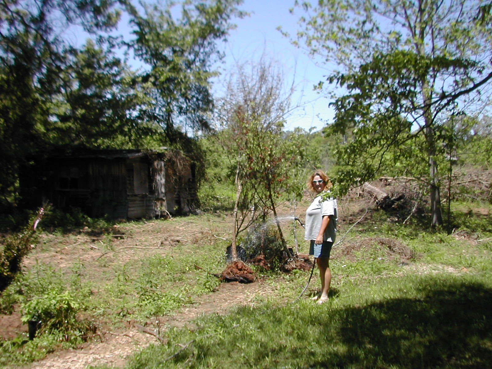

2301, yeah, we can at least think about relaxing :) got to find some trees a bit farther apart though....
2302, My ho "Lil" on fire tending duty
2303, Hanna saying, yep, I like well water for the plants......
2304 look at me know, when I grow up, I will be a cool looking wishing well :D
2305 one of the brush piles going to the land of "away"

Alan, congrats on the progress so far but, unless you placed a steel lentle on the inside of the brick to support the ones above the door way you may have to remove the framing and door to put one in so the brick and mortar will not crack. If you plan on putting up trim on the outside (face) of the brick you could leave the door and framing alone and put the lentle on the outside and cover it with the trim. Either way I would not wait to long toput one in if there isn't one there already.
   / Al B's House rework
#156
Steel lentel is in mind, was going to place it from the outside.
That was one of the things that MikeB and I sat and talked about for quite a while, I think I will hide it with a "fan" detail, echoing the window, and I think the boss said the steps would be round as well.
I am going to have the guy that did my window install come back and do the trim in aluminum, I am going to fill in around the door with PT wood, then balance my uneven gaps with wood, then cover the entire mess with aluminum trim and it should be right at the end.
Thanks for the insight though, it is comments just like that, where I miss things from lack of experience or knowledge or plain old forgot to see it, that make this forum so great.
One of the things I have not quite figured out is how to cut in to the mortar to put in the steel. Then again, I bet Mingo will know, and that is a project right up his alley :)
I can hear the "ohhh gott ohhhh gott ohhhhhhh got what have you done Alan" now.......

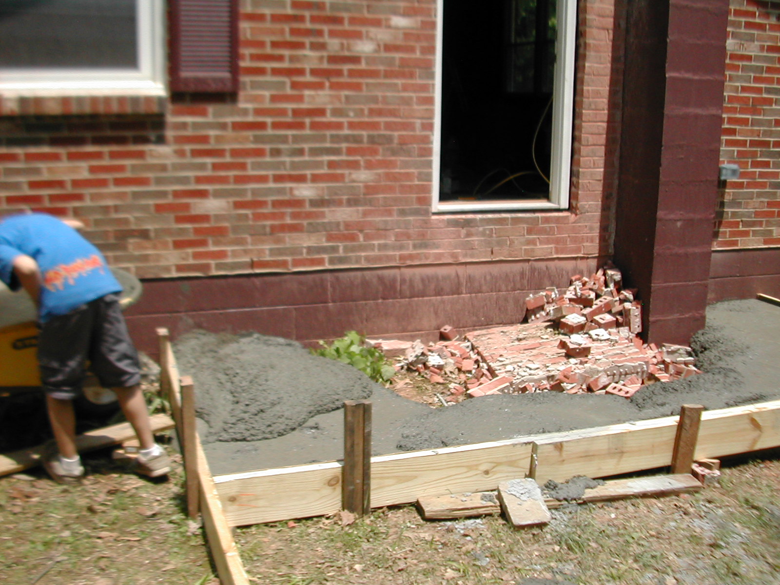

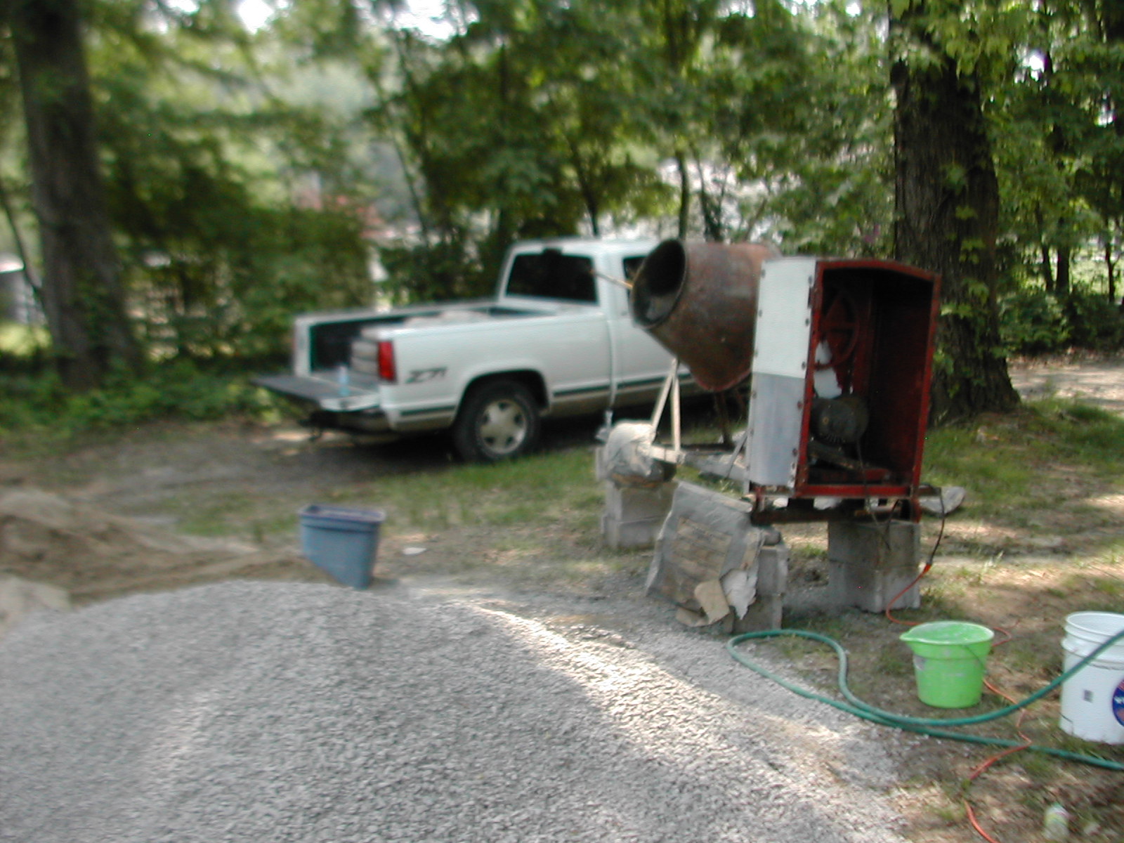

Got the concrete mixer up and running,,, of course it is a redneck concrete mixer as I have it up on blocks in my yard :D
More photo's to come, I was pretty beat this evening, and pictures where not high on my list.

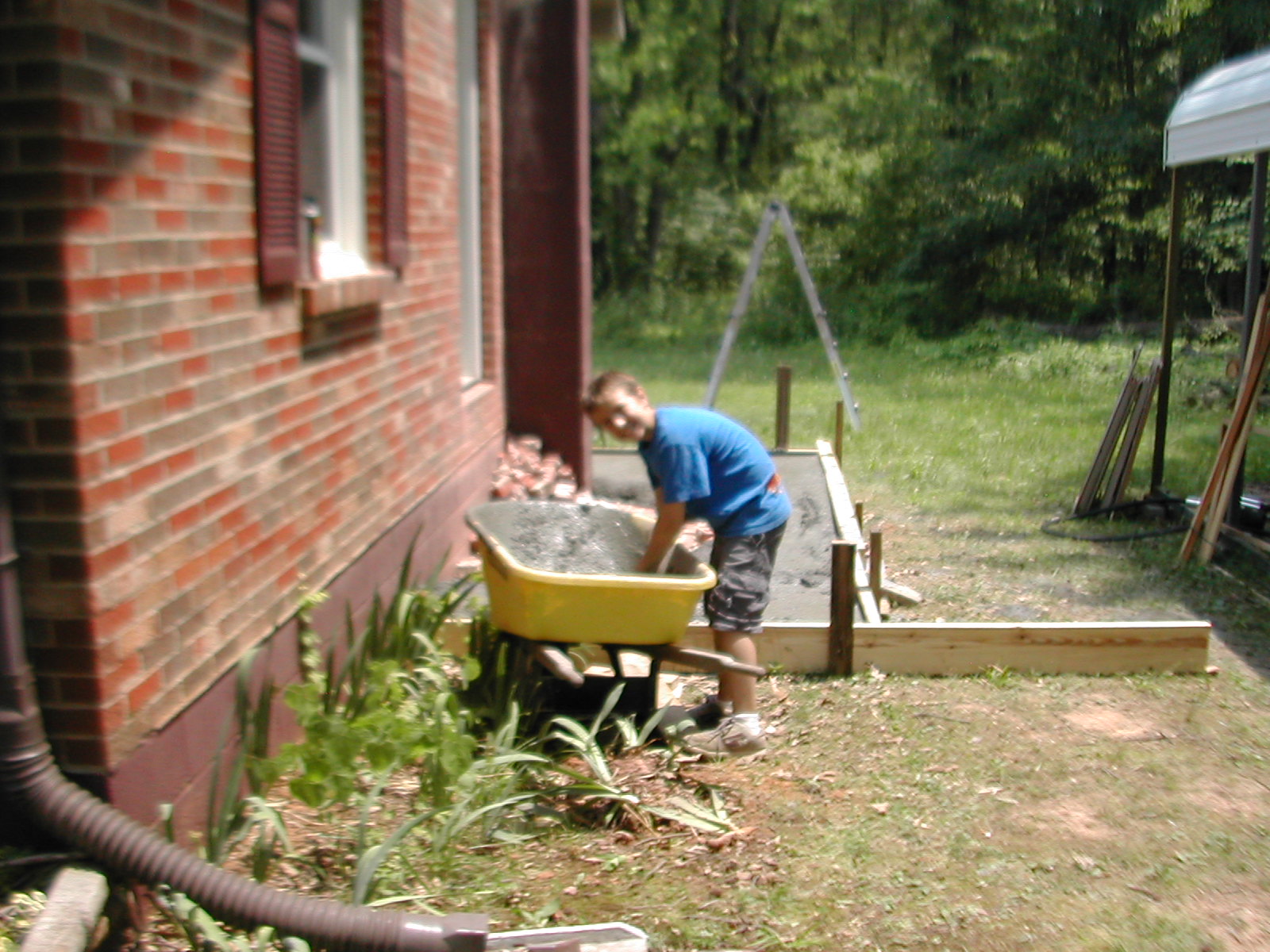

2312, form's up (done last night)
2313, Redneck concrete mixer
2314 Dean, actually held his attention for long enough to make him work :eek: (Mingo is Dean's Pad (pronounced BOD) which is godfather, this is a big deal in our part of Germany)
2315 I was trying to get a picture of Mingo, and he hates it,,,, So had to get one while he was not looking :D
2316 In the middle of pouring it up.
Sorry no end of evening pics, but will try and get some tomorrow.
