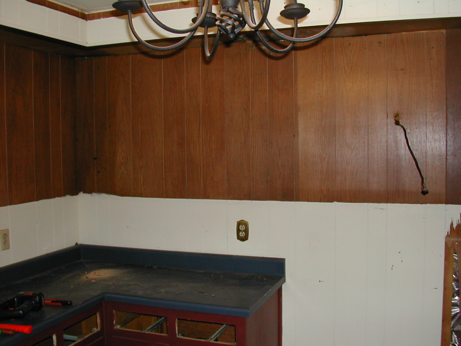

So the DW has sheetrocked over where she wanted me to put the electric outlet in the bathroom. :( Sometimes, it drives me nuts. There are 8 million things to do, and she will cover over what she wanted me to do and make it 3 times harder for me. :( What did you say Dave, just keep :) and moving forward.
So, has anyone seen a U-bend made into copper or just do it with soft tubing?

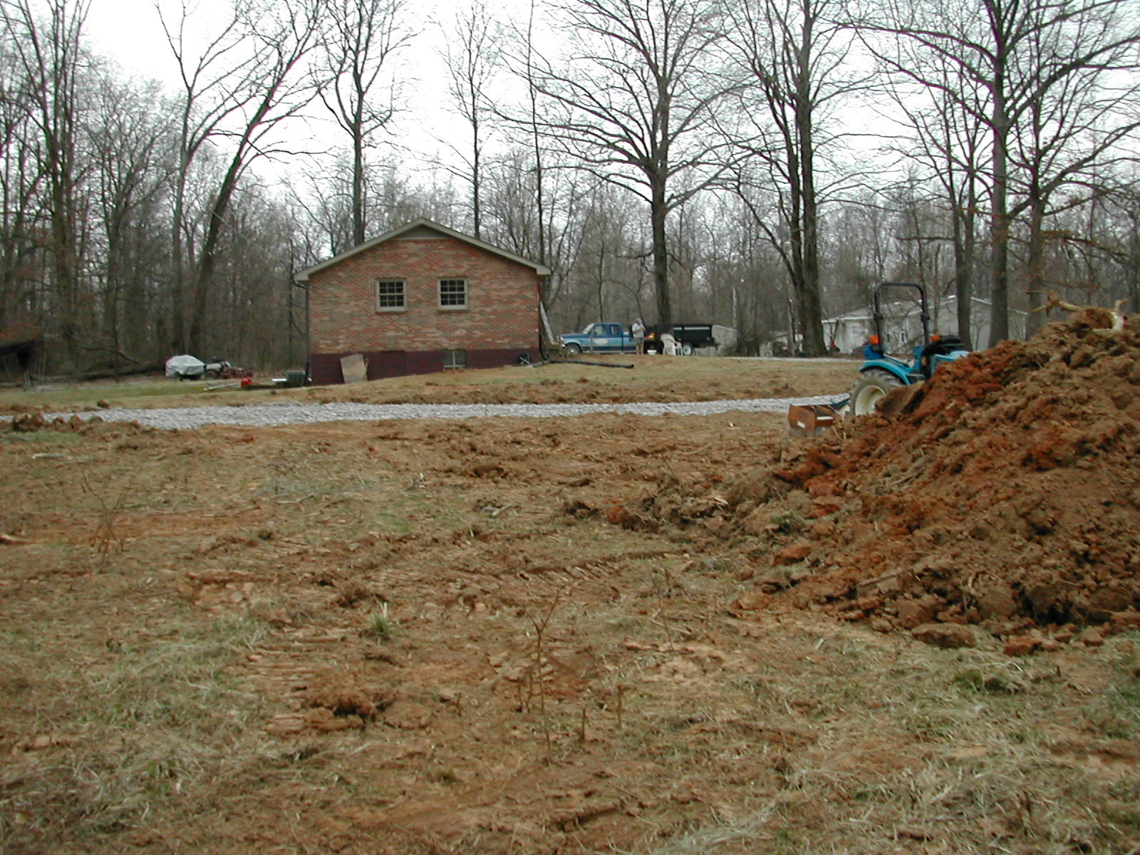

So this afternoon, I ran out of excuses about buying backhoes and had to actually do some work. :) So Bob the Bobcat and I set about getting my storage building into place to be picked up by the wrecker. One farm jack, One Bob, 4 pcs of 4" pvc, A rake and a piece of chain, and we can move mountains,,,, Well old truck bodies at least. :) Action shots are kind of hard when working by yourself. Mark made it out to help me as I was pushing the last push with Bob and putting the box in place on the roadway.
There were two wreckers across the street, neither of which wanted to move my storage box, so I called and scheduled the pickup with the guy I normally use, we will move it to the property tomorrow evening.
We are almost cleared of the property. I took a 4000lb pile of rock we had there out to the property this evening, so I could stare at my new HOE :>>
Man is it big when driving it in the areas I am used to the little 33 horse NH on.

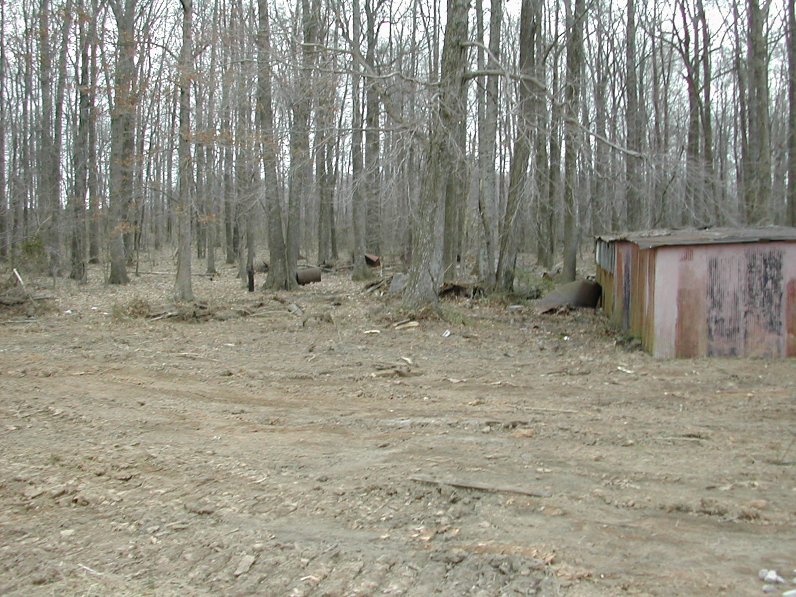

So todays job was to get the truck body to the property. It was a success. No muss, no fuss, and turns out Robert has a set of backhoe forks he ended up with and will sell them for $300. May be worth going and looking at :)
Think I found Bob the Bobcat a new home today, guy said he would be by at 1600 tomorrow and pick him up. That would be nice. Just have too see though, I do not have the cash in hand yet, and one thing this latest spate of dealings has shown me, is the deal is not done till it is done.
Talked to the former owner of my hoe today. Real nice conversation. Will cover more in the hoe discussion.
So, Picking up, moving, dropping off, unlevel but in the right place, and what 65 yards of mulch looks like in the new place.
It is starting to come together. Few remaining odds and ends to clean up at the property and we will be out of there. That is a $200 timeline I need to meet.

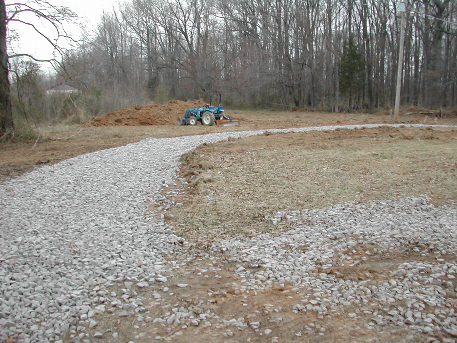

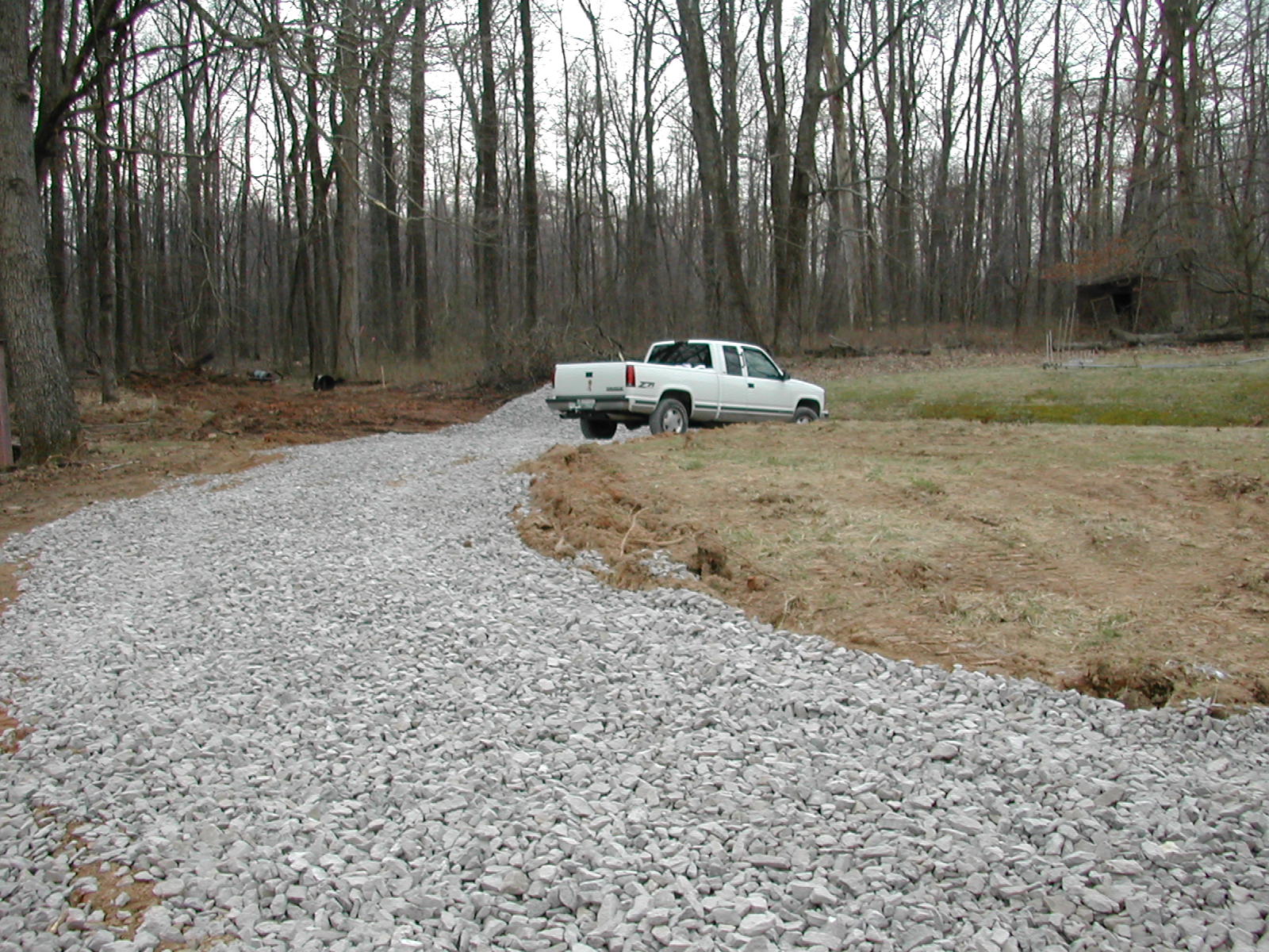

Hanna got another 4 tons of crusher run in and neatened up the gravel I did with the hoe behind the garage, for the first time in I am sure a very long time, I pulled a truck up to the garage door of this house.
