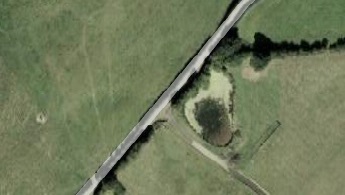

The weather had been very kind in the weeks that had gone by since draining. Apart from a couple of puddles of water in the depression that I once called a pond, the mud was still exposed almost exactly as I had left it.
To local knowledge the pond had always been there. I initially thought that cattle had probably enlarged it in more recent times by treading in the bankside, as none of it was fenced off. My wife then found a map dating backed to 1884 and this showed I was wrong, it had hardly changed shape in all that time. In fact the only real change in all that time is the addition of the track off the road that I put in when I first got the land.
attachment.php
attachment.php
1884 map with pond colored in blue. Image from Google prior to digging

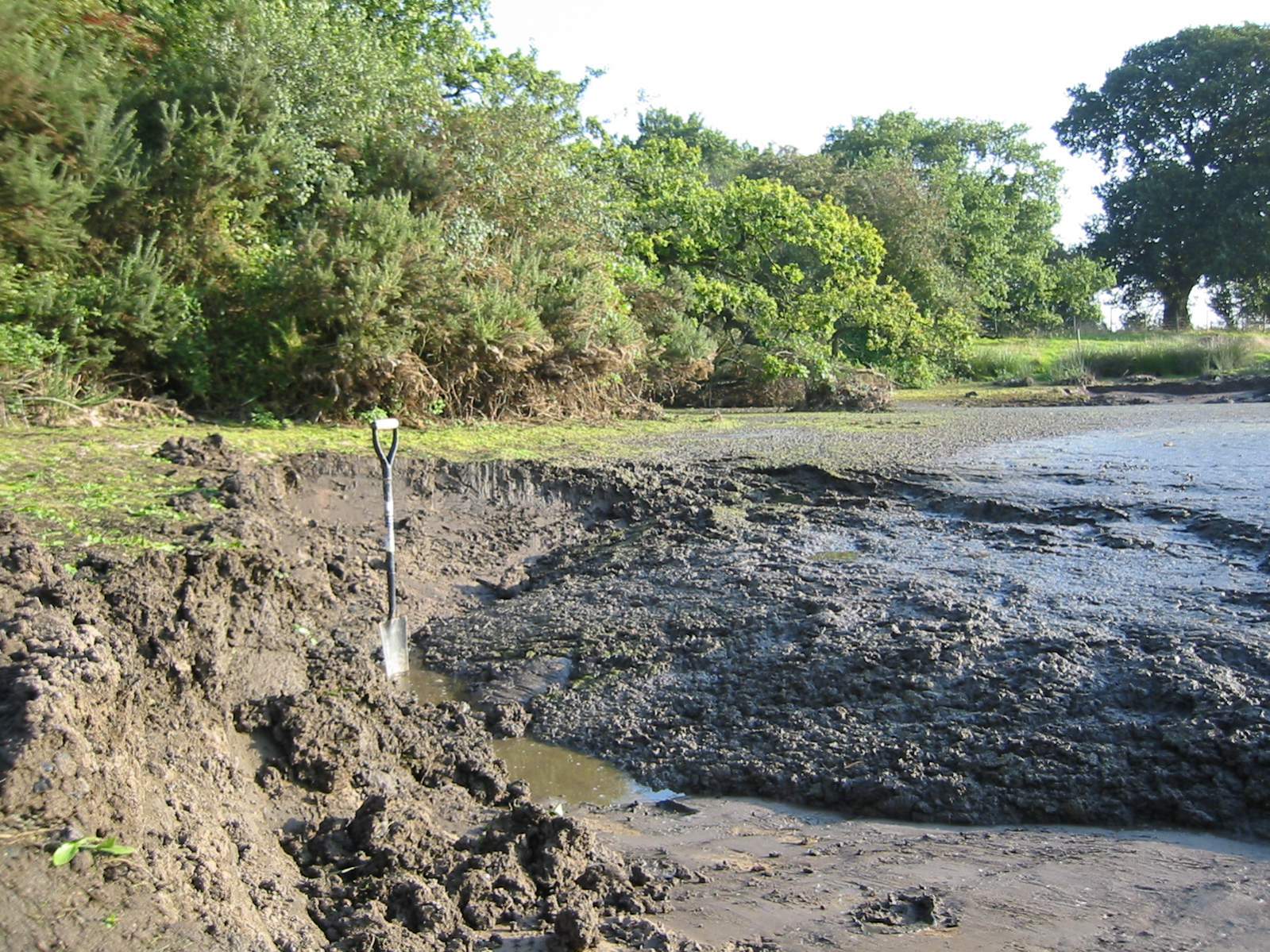

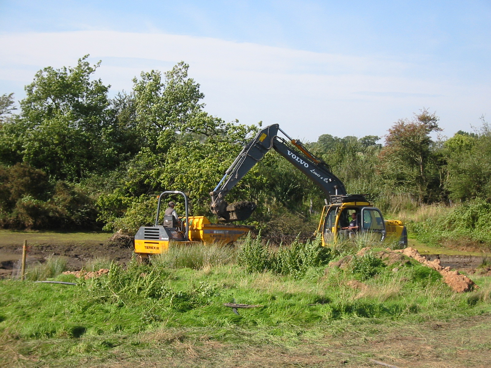

A few years back a very large excavator got stuck clearing out a mere less than a mile away. It was there for many weeks, the boom tilting at a sideways angle becoming almost a regular feature of the landscape. A second recovery machine was then brought in to rescue the first one and it also became bogged down. Not sure how good the drivers were but the bill must have been huge. We were going to play it as safe as possible to make sure everything would be cleaned up, ready for collection at the end of the 3 days. Then again anyone who has removed deep mud will tell you, it is not always as easy as you first think.
One side of the pond against the roadside had long overhanging branches and was a no go area. That left two thirds of bankside to work from. On the first day of digging the excavator tracked steadily around the perimeter of the pond, loading the silt into each dumper in turn. With 2 dumpers we were able to cart away with one while loading the second, keeping the excavator running almost flat out. We used most of that day's spoil filling in other holes and part of the hillside that had been eroded by cattle standing under trees, exposing the roots 2 or 3 feet down in places.
To our surprise, as the bucket worked around the pound, the ooze hardly slumped, it looked more like someone had cut away around the circumference of a huge mud pie. The exposed clay base was left a foot or more below the silt in the centre.
attachment.php

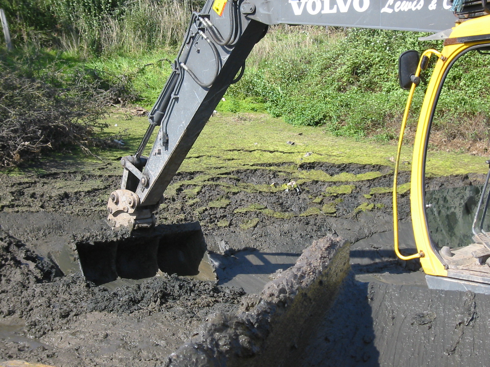

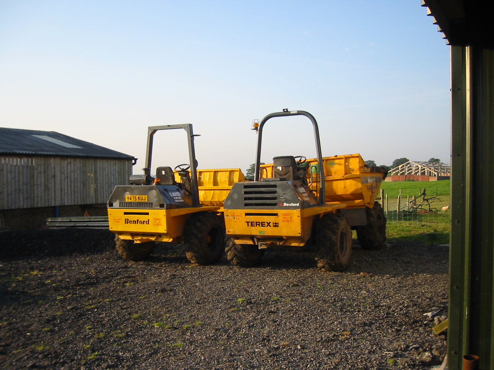

I was camping overnight in a tent and woke up the next morning to clear blue skies again. When I was filling the dumpers with diesel ready to start the second day, I remember thinking how clean the dumpers looked, this was going to be easy...
attachment.php
-----------------------------------------------------------[/IMG]
Wrong! :laughing: The silt will be wetter the farther in that you go. :eek:
The dumpers will be splashed with mud.

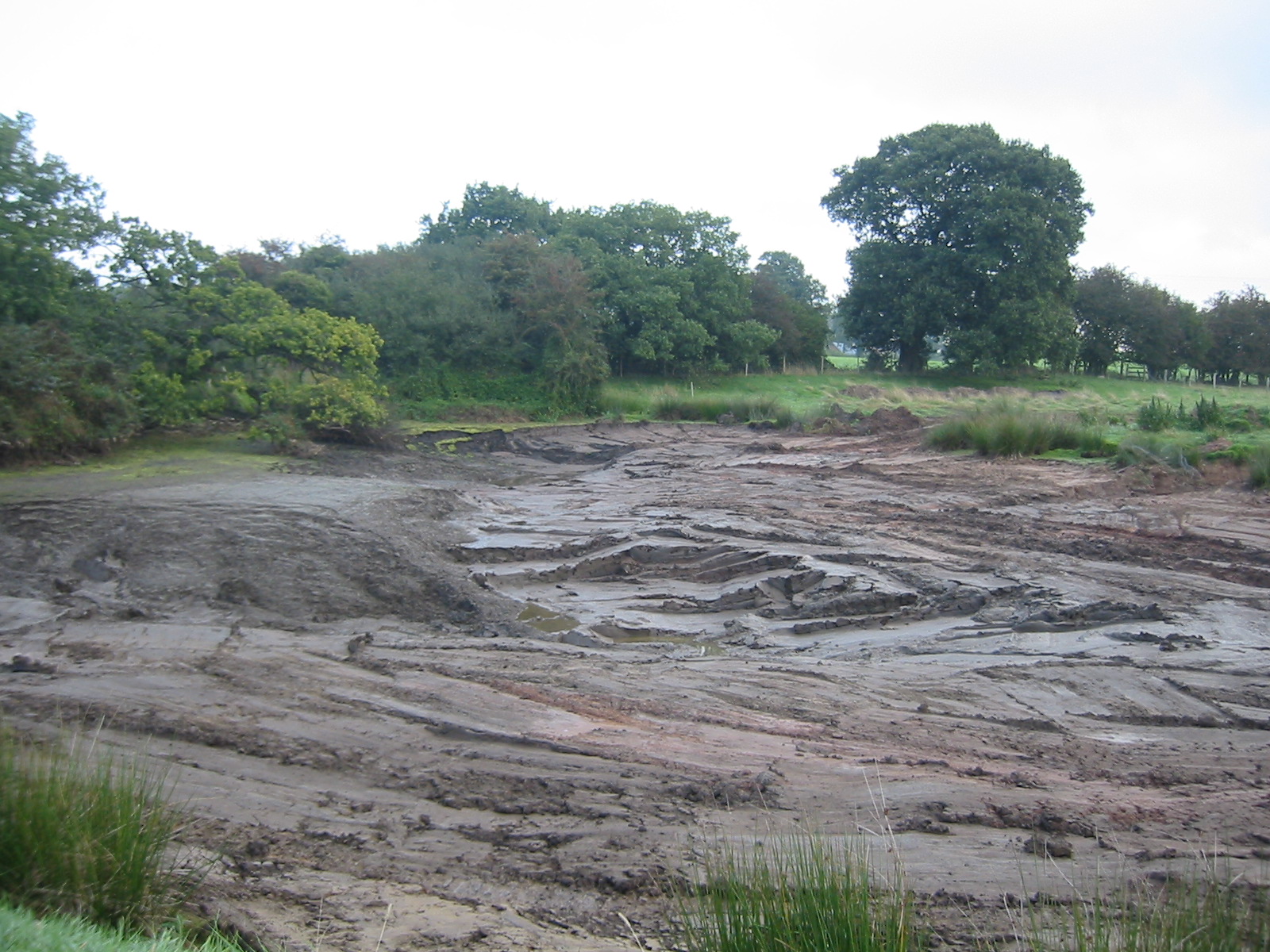

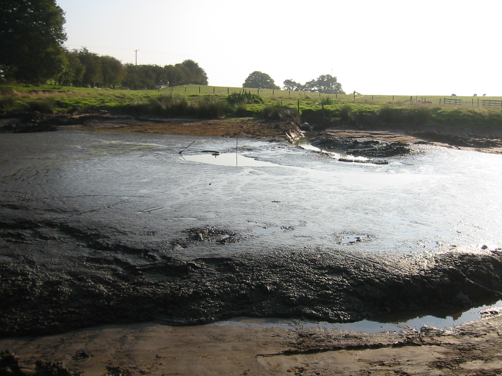

Dig Day 2
The mud had slumped a little overnight in places where the mud had been deepest, but the bulk of the exposed clay was almost dry.
attachment.php

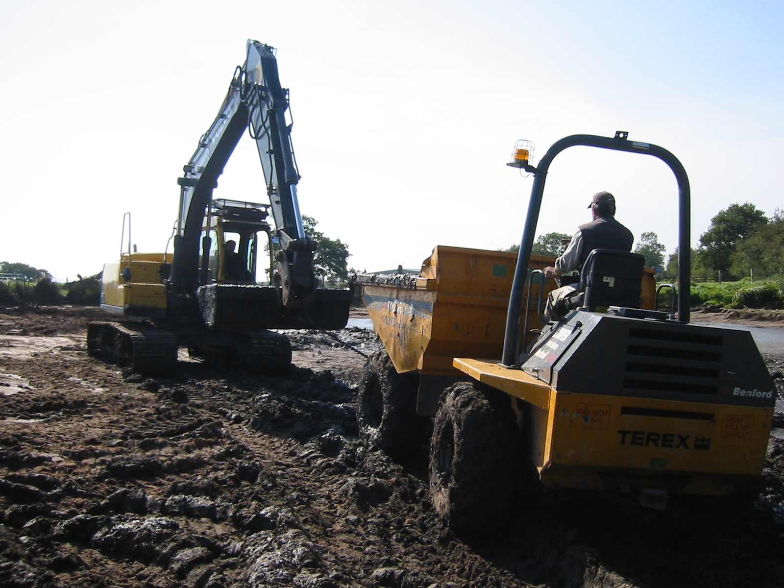

I have seen excavators with extra long booms and no doubt these would have helped reach out a little further. Our plan of attack for that second day didn't need a particularly long boom. The excavator would work gradually to the centre and as it progressed cut out a smooth path down to hopefully more firm clay so the dumpers could come down into the hole to meet the excavator. That way the excavator would not be wasting time tracking back and forth, all it needed to do was swing round to empty it's bucket.
A small ramp was cut into the bankside and down into the hole went the first dumper. To everyone's relief the clay base help up well and we soon settled into a steady routine.
attachment.php

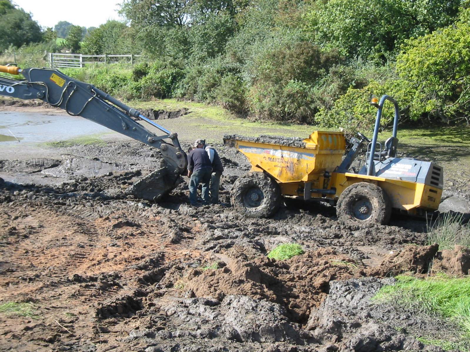

The amount of material coming out was impressive and it became an issue of where to put all the stuff without wasting time driving too far. I cut the wire on the fence to the adjacent field and we poured the gloop out of the dumper buckets onto the ground. My intention at the time was to spread it thinly over the grass in the fields at a later date. Like many of my good intentions, that hadn't happened even by the following year, by which time it was easier to plant a few trees on the top and pretend this was all part of the plan to improve local biodiversity.
Eventually the firm clay base decided it had enough of us rolling over the surface and it started to rut. We began to slip and slide as we reversed out with our loads. When we originally planned the dig we had talked of getting some swamp mats for the sticky stuff, however in the haste to rearrange things these had been forgotten. At first it only needed an occasional gentle nudge from the excavator bucket to get the dumper moving up the grade and we carried on working like that for some time.
Four wheel drive dumpers are designed to work in mud, but once the wheels are constantly spinning you know they have about reached their limit. I thought I would be the first to get stuck, but as I made my last return trip before lunch I saw the first dumper had slipped sideways and now needed some more serious assistance to get out.
attachment.php
They had a chain on it almost before I had chance to snap a photo and some steady pulls had it out again.
