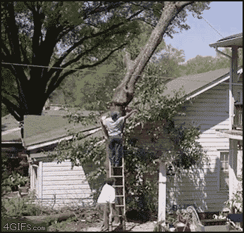

I am curious why digging at the tree roots with a backhoe and then pushing the tree over with the hoe is a bad idea? Realizing trees have a direction that they prefer to fall, and with nothing around to "be in the way" that might change the direction of fall, what could go wrong? I would assume that the digging only happens on one side of the tree, thereby allowing the roots on the other side to help prevent the tree from coming back towards the tractor. (Probably something in this I am missing). Doing it with a dead tree would not be considered, and doing it from a ladder is (sorry RSKY) just stupid!!

...Doing it with a dead tree would not be considered, and doing it from a ladder is (sorry RSKY) just stupid!!....
I agree. I would never try to cut roots from a ladder, either.

Regarding the video, standing dead trees are potential killers, as are close together trees with overlapping tops. Also, if you read the details in the link, that was a work crew who were taking down that tree under protest on boss's orders because he was in a hurry. They saw the danger and the idiot was the bossman!
