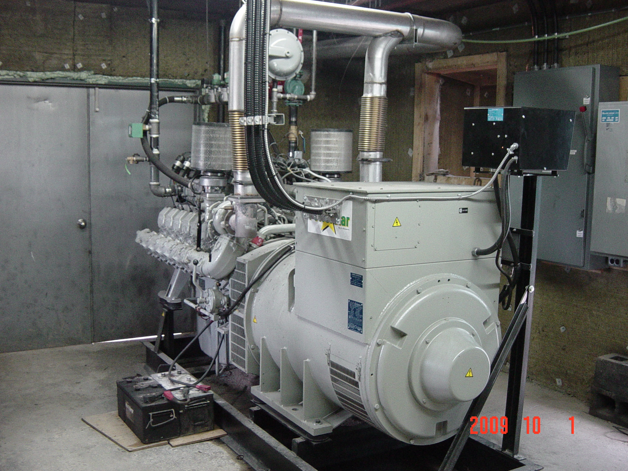

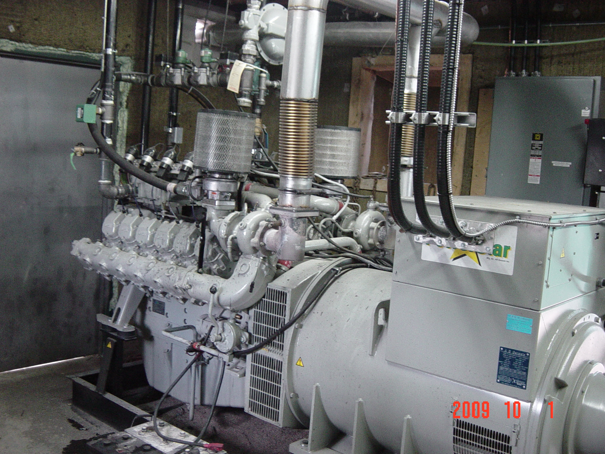

One of their impressive NG sets.
They have a tiny Yanmar for nighttime use that keeps things alive.
