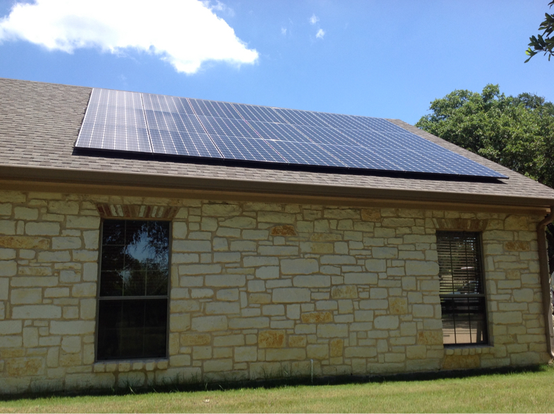

Well, do some math for me, my system cost $16,000, and returned $1400 tax free this year. What is the rate of return, I'm guessing 11.4% on my money, tax free. System life spans is 25+ years at 80% of rated power. You let me know a better investment. While I agree it can't replace commercial power it really does work, and will permanently reduce your bill, and produce power no matter what the commercial power company does or the price of fuel, as long as the sun comes up. Net metering is key to making finical sense and your long term plan to remain in the location. HS
   / All electric house and a generator #64
Our utility doesn't offer net metering so our break even point is about 13 years provided cost of electric energy stay constant. When cost of energy goes up break even even point gets proportionally shorter. If you have 100% electric car and your system generate enough energy to charge it my estimate is that the break even point will be about 6-7 years.
If you size the system that you export very little to the grid your break even point will be short even when net metering is not offered. At this point our BEP is 13 years because we export a lot. I plan to add AC to my shop. That will shorten the BEP significantly. We will add electric car possibly next year when 200 miles per charge cars hit the market.

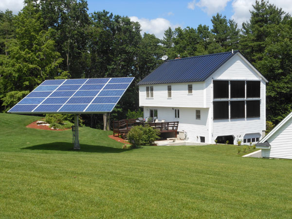

Around us that panel wouldn't really get a lot of sun. Trees shade the house a decent amount and I would be concerned with it taking damage from falling branches and such. Can see where it works well for southern/sunny and more open areas however.
   / All electric house and a generator #70
This could go just about anywhere on a large property. HS
