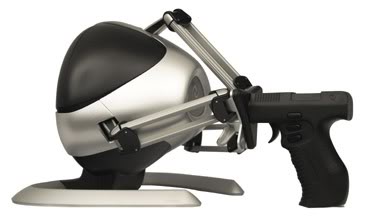

alright it is a joystick for pc/game but... force feed back control still servo motors.... BUT it is laying down on it's side reflecting out the unit behind the tractor would be seating.
https://www.youtube.com/watch?v=7jkNx1H650c
below picture is from...Novint Falcon
gun, swap out handle for a rear blade, or box blade, rotatory deck, post hole digger gear box possibly auger hanging down. what the heck

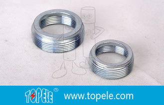

below image is from... Electrical IMC Conduit Fittings Zinc Plated Steel Reducing Bushing , Threaded Reducer
pc2228192-electrical_imc_conduit_fittings_zinc_plated_steel_reducing_bushing_threaded_reducer.jpg
*rubs chin* i guess i never have tried, taking 2 pieces of pipe and putting a bushing on each end. this might get a little interesting!

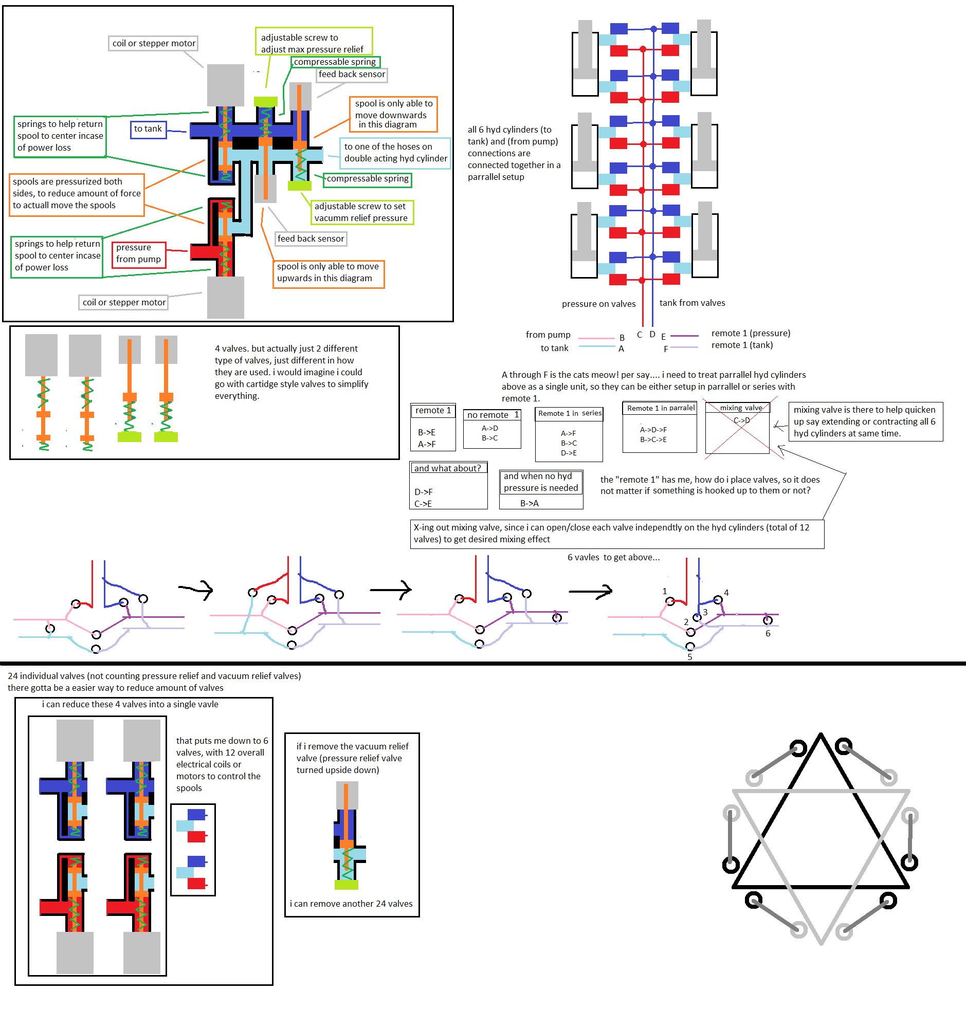

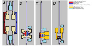

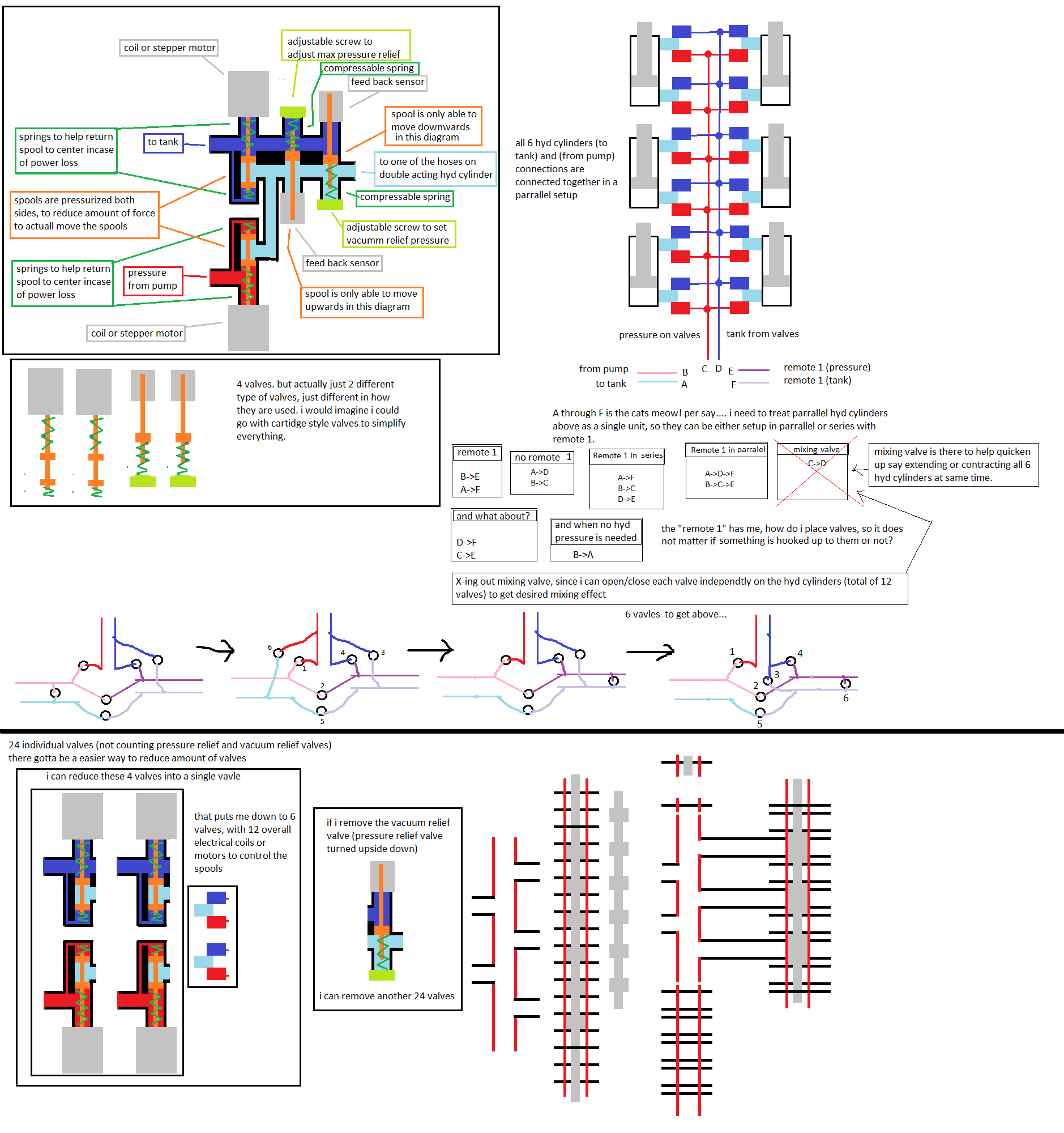

below is older diagram, if brainstorming. trying to figure out how the valves would work....
it took me a while before i realized i could use a "pressure relief valve" and turn what it connects to around. to turn them into "vacuum relief valves" granted it may not be the best idea in the world. but.. what the heck. KISS (keeping it simply stupid)
each hyd cylinder is going to require a bare min of 2 coils (either make it 2 solenoids or 2 D/C motors) to adjust the valves. will most likely chop the 24 coils/valves shown, back down to 12 total coils (2 per each hyd cylinder, then an additional 2 coils per hyd cylinder (one for pressure relief, and one for vacuum relief) to take measurements from. (the pressure and vacuum sensors being for float/trip functionality)
the A,B,C,D,E,F notation of valves. still need to work through, to see if i can combine them and/or redo them to reduce amount of valves.

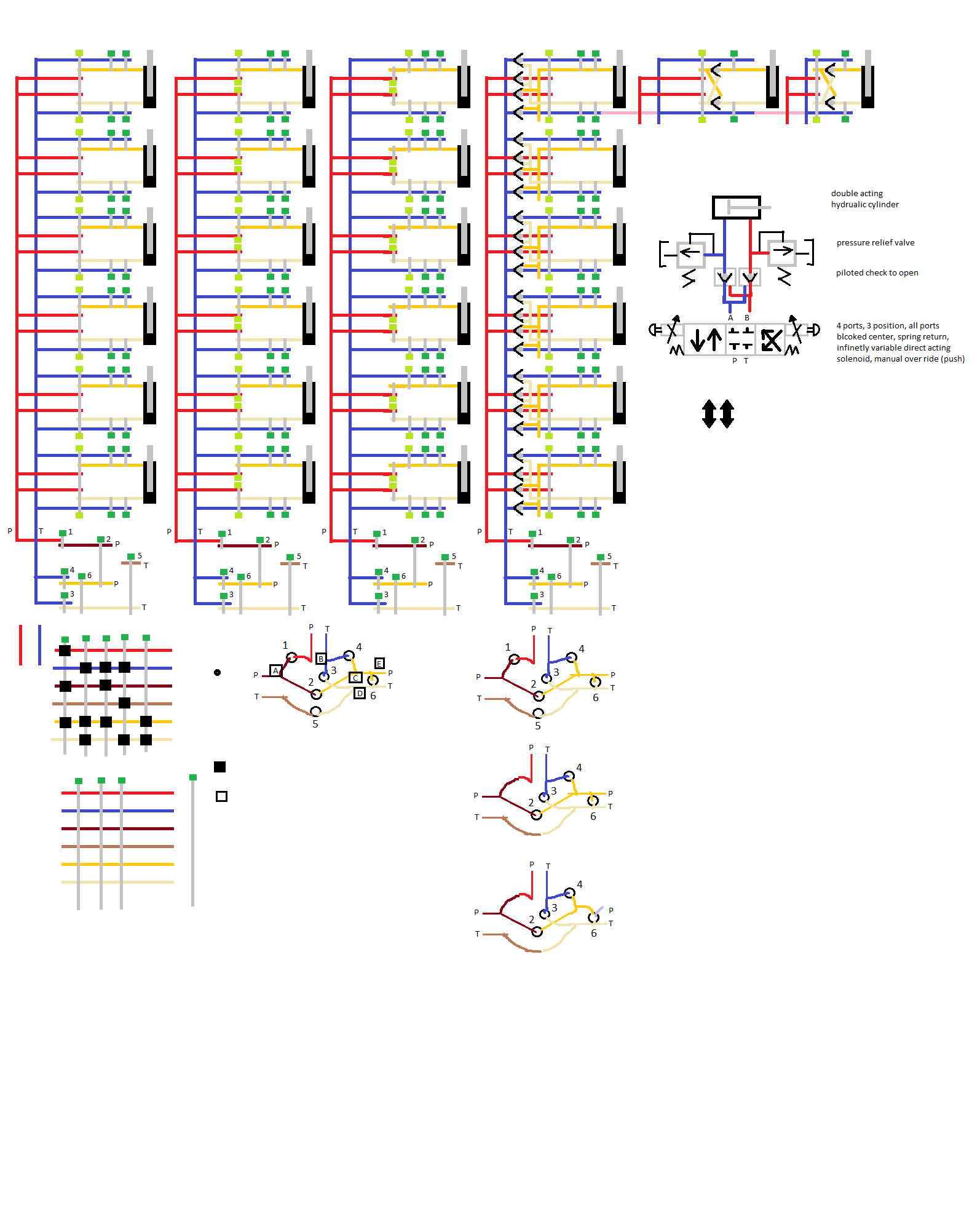

uploading misc scratch drawings... to see what i have.
actually looking up hyd schematic symbols to draw things out, vs trying to redraw and figure how to run pipes in a 2D / 3D drawings.
getting closer, just not there yet.

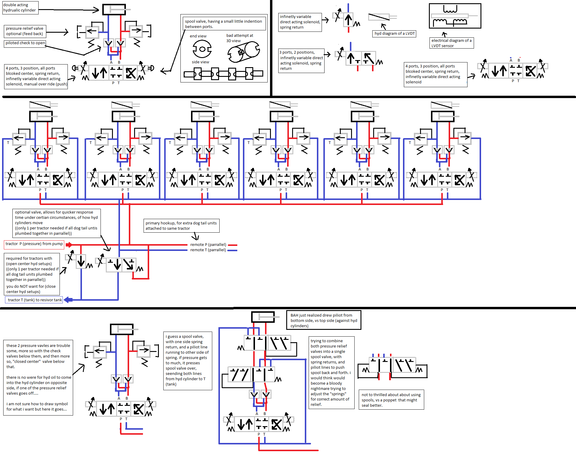

some more chicken scratches.
so far things seem to be panning out better for the bottom set of diagrams, as in it will actual last long term, without any funky hiccups, vs other things i have tried
with mounting valve directly on hyd cylinder, i would like to think a higher "shock" pressures could be had/handled. (hoping hyd cylinder doesn't implode / explode) due to putting tractor in full high speed reverse and slamming it into something, or vice verses, and chain up to something, with slack in chain, and going for a running start forward.
the individual valve block themselves would most likely need to be some custom job, with a "curve" vs more of a typical "cubed / straight line" valve block, seen on many tractors for extra rear remotes. the curve should take more advantage of the space, and keep the valves from getting in the way and being squished / mangled.
setup should help keep all the hyd hoses and wires located centrally inside of it in idea, to help keep tree branches, weeds, etc.. from sticking up and pulling the guts out of the dog tail.
my only worry is the hoses/wires that go from the 8 way valve / central computer chip, to piston end of the frame work. some extra length will be needed there to be able to stretch out when all hyd cylinders full extend. and when all hyd cylinders fully contracted, that hose length going to want to curl up, or drop down below the dog tail bottom hyd cylinders and give risk to getting snagged by a tree limb or like.
with 2 pressure sensors, 2 coils, 2 lvdt sensors, i am tempted to put a single little chip at each hyd cylinder/valve combo. to reduce number of wires running between each hyd cylinder/valve combo and central computer chip. vs running a dozen or so wires plus 2 hyd hoses from each hyd cylinder/valve combo. though con's vs pro's to each.
