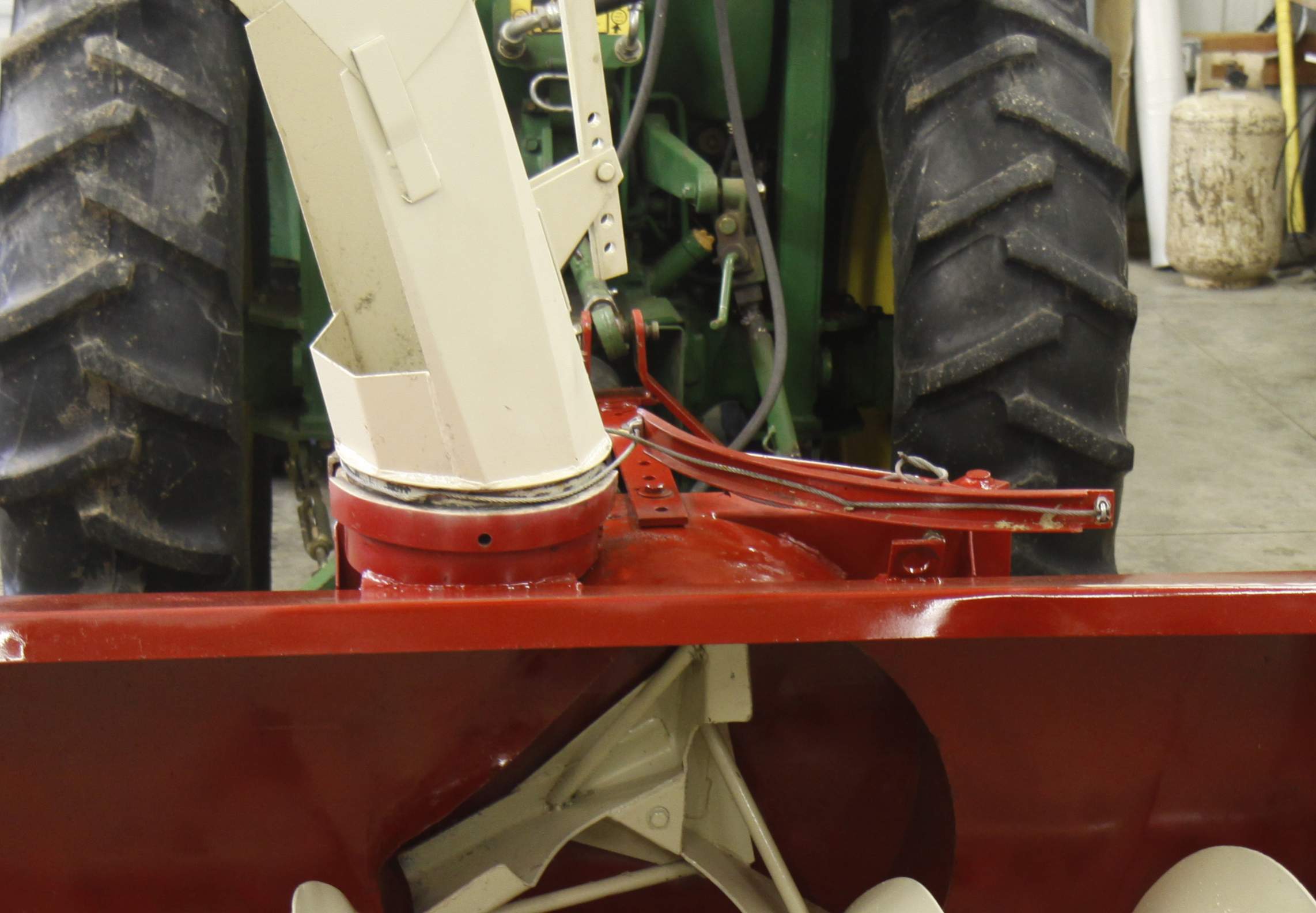

Glad to hear some positive news! The big joke with my blower was keeping the impeller paddles square.The blower in the pictures was rebuilt twice because of extreme wear and abuse. In 2010 i priced replacement parts and bearings ect. and it totaled 1200 dollars plus delivery. I bought the new blower for 1600$ ready to go brandy new! My uncle has my old one and is going to straighten out the pile of scrap and use it. The impeller is important in snow removal in needs to be straight. The straighter the paddles the better the cupping action to throw snow. The auger is another piece that needs to be straight. If it is bent, it will not evenly distribute the snow to the impeller causing the blower to plug. Even though the blower is a simple machine everything needs to work together to work effectively. Good luck .. . John
heres a pic of the new blower thats been used once!

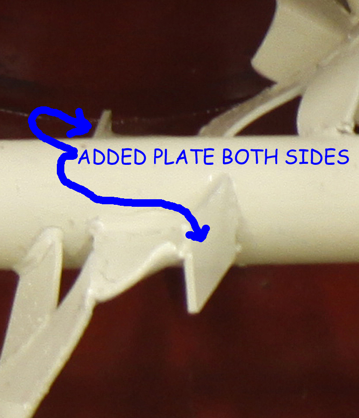

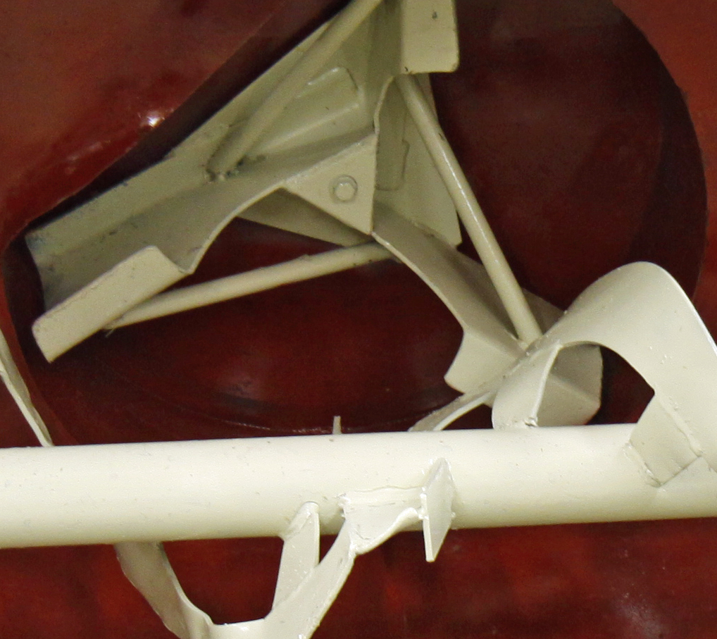

I had the same farmking unit and i had to do 2 things to get it to work correctly.
1. I had to add stiffeners to the flighting ends cause the smallest rock bent the auger so it wouldn't suck th e snow into the impeller.
2. I removed the 3/8" stiffeners on the impellers and added 3/4" rods to brace them. otherwise the impeller heads bent all the time. The design is good, but the supports sucked on that unit.
After the repairs it threw dry snow 30 feet...wet snow was another issue :mad:
