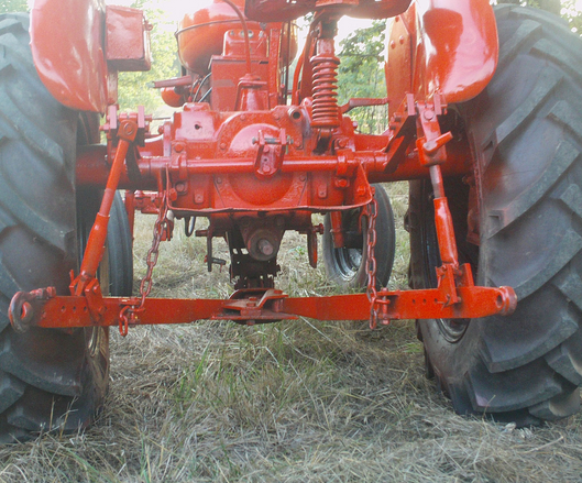

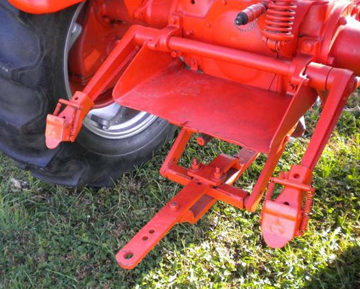

does it have a 3 pt hitch or snap couple? The first picture is a conversion of the older snap coupler system, they may look different as there are many ways to convert them. The second picture has the snap coupler system.

If you have the 3pt hitch adapter like you said you do any Category 1 implement should fit. Double check the holes in the ball of the arm to see what shaft size it it to determine the category you need. If you have a higher number you can always go down not up. Cat0 Size=5/8" Cat1=7/8" Cat2=1 1/8"
Hope this helps
