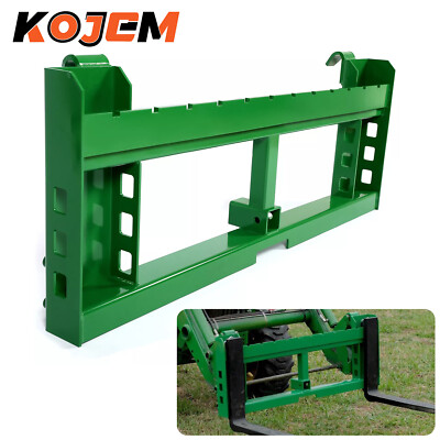

I have a Kubota M8540. I'm looking at the Express Steel 48" heavy forks that seem to be a match for my 6400lb lift capacity. Not that I'll ever lift that much. The ES, however, lack the receiver hitch and hay spear sleeves which I would really like. I see they come on Titan/Palletforks.com units. Any others out there I can consider? Not a fan of the chinese built from Titan although they do have some pricier 'made in the USA' units. Not sure how much I trust that either.

I went the cheap eBay route, $300 for a 4000# JDQA fork frame from KOJEM, and another $300 for a pair of 4000# 48" forks from YITA Motor. I've been using them hard for moving logs and pallets for two years now, in fact unloaded a semi truck with them yesterday, and zero problems.
People rail against the quality of Asian products, and often with good reason. But when it comes to something as simple as pallet form frame and fork set, they seem to be capable enough for my needs.
I went with the low frame, no upper guard, because I had plans to possibly add a hydraulic grapple to the frame. In the end, I found the forks worked well enough without the grapple, for my log-moving requirements.
