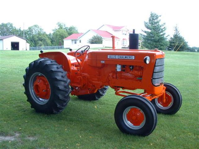

Here is a picture of my last D17 Allis Chalmers

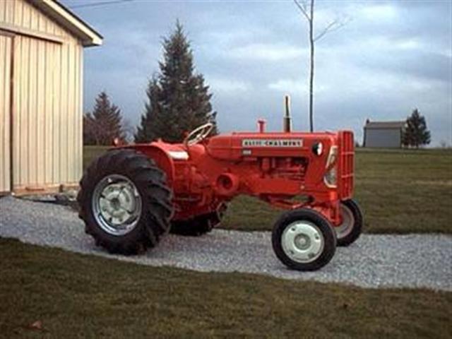

Here is my D15
